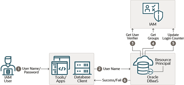

The following diagram illustrates how using an Oracle Cloud Infrastructure (OCI) IAM database password verifier to authenticate with the Oracle DBaaS works:
1. The IAM user logs in to a tool or application client that is associated with the Oracle Database client. This user logs in with their IAM user name and IAM database password, which begins the authentication process. The user can use any database client that is at least Oracle Database release12.1.0.2. Earlier versions of the database client do not support the 12C database verifier.
The IAM user connection request is sent through the database client.
After the IAM user name is sent to the Oracle DBaaS instance, the database requests the user’s Oracle Cloud Infrastructure (OCI) IAM database password verifier from IAM. (The IAM user profile stores the IAM database password verifier.) This verifier is a hashed version of the password, not clear text. If the password verifier from IAM matches the password verifier generated by the database client, then the user is authenticated. The Oracle DBaaS instance uses a resource principal to communicate with IAM. The resource principal is the Oracle DBaaS identity that is recognized by IAM and used by the database to securely communicate with IAM.
When the authentication succeeds, the Oracle DBaaS instance retrieves the IAM user groups. If the IAM user is mapped to an Oracle Database schema and the user has not been locked out of their OCI account, then the IAM user successfully accesses the database. The user is also granted any global roles that are mapped to a group the user is a member of.
The Oracle Cloud Infrastructure (OCI) login counter tracks logins for both the OCI console and OCI database passwords. A successful database login using the IAM database password will reset this counter.
Based on the outcome of the preceding steps, the IAM user database access attempt either succeeds or fails.

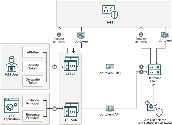

The following diagram illustrates the start of actions that take place when an IAM user or an Oracle Cloud Infrastructure (OCI) application accesses the Oracle DBaaS instance using an OCI IAM token:
1. Access to the database requires one of the following:
- **1a:** From an IAM user, the user must have an `API-key` stored in their local system or have a security token from signing into OCI recently. An `API-key`, security token, delegation token, instance principal, can be used with the OCI CLI. If a current and valid security token is not available, then the user can be prompted to authenticate with OCI IAM. (See [User Credentials](https://docs.oracle.com/en-us/iaas/Content/Identity/Concepts/usercredentials.htm) for information about the available user credentials.) In an OCI cloud shell environment, a delegation token will be available.
- **1b:** For an OCI application, the application must have be configured to have an instance principal or a resource principal. All key types (`API-key`, security token, delegation token, instance principal, and resource principal) can be used with the OCI SDK.
- **1c:** You can configure the database client to request a `db-token` from IAM by using the IAM user name and IAM database password. Only the database client can use this type of token to access the database. The database client cannot request a `db-token` using any other credential.
The application, OCI CLI, or the database client makes a call to IAM requesting the
db-tokenusing one of the principal credentials. Only thedb-tokencan be used to access the Oracle DBaaS. Requesting adb-tokencan be done by an application written with the Oracle Cloud Infrastructure (OCI) public SDK to connect with OCI IAM. (See Software Development Kits and Command Line Interface.) If an application cannot be changed to connect directly with OCI IAM using the OCI public SDK, then a helper tool such as the OCI command line interface (OCI CLI) can be used to retrieve thedb-tokenfor the user. The database client can also be configured to request adb-tokenusing the IAM user name and IAM database password. -
An application or tool that has been updated to work with IAM can then pass the
db-tokendirectly to the database client through the client API as an attribute. If an application cannot be updated to get thedb-tokendirectly, then a helper tool such as OCI CLI can put thedb-tokeninto the default or specified location in the local directory. TheTOKEN_AUTH=OCI_TOKENsetting in the connect string or thesqlnet.orafile enables the database client to retrieve thedb-tokenfrom the default or specified file location. A user can request a token at the OCI CLI by running theoci iam db-token getcommand and specifying their profile, which stores their user account credentials. For example:oci iam db-token get --profile PeterFitchThe directory location for the
db-tokenand the corresponding private key should only have enough permission for the OCI CLI to write the files to the location and the database client to retrieve these files (for example, just read and write by the process user). Because the token and key allow access to the database, they should be protected within the file system.
