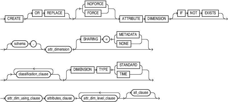

CREATE ATTRIBUTE DIMENSION
Purpose
Use the CREATE ATTRIBUTE DIMENSION statement to create an attribute dimension. An attribute dimension specifies dimension members for one or more analytic view hierarchies. It specifies the data source it is using and the members it includes. It specifies levels for its members and determines attribute relationships between levels.
Prerequisites
To create an attribute dimension in your own schema, you must have the CREATE ATTRIBUTE DIMENSION system privilege. To create an attribute dimension in another user's schema, you must have the CREATE ANY ATTRIBUTE DIMENSION system privilege.
Syntax
Semantics
OR REPLACE
Specify OR REPLACE to replace an existing definition of an attribute dimension with a different definition.
FORCE and NOFORCE
Specify FORCE to force the creation of the attribute dimension even if it does not successfully compile. If you specify NOFORCE, then the attribute dimension must compile successfully, otherwise an error occurs. The default is NOFORCE.
schema
Specify the schema in which to create the attribute dimension. If you do not specify a schema, then Oracle Database creates the attribute dimension in your own schema.
IF NOT EXISTS
Specifying IF NOT EXISTS has the following effects:
  • If the attribute dimension does not exist, a new attribute dimension is created at the end of the statement.
  • If the attribute dimension exists, the existing attribute dimension is detected and a new one is not created.
You can only specify OR REPLACE or IF NOT EXISTS in a statement at a time. Using both OR REPLACE with IF NOT EXISTS in the very same statement results in an error.
You cannot specify IF EXISTS with CREATE statements.
attr_dimension
Specify a name for the attribute dimension.
SHARING
Use the sharing clause if you want to create the object in an application root in the context of an application maintenance. This type of object is called an application common object and it can be shared with the application PDBs that belong to the application root.
You can specify how the object is shared using one of the following sharing attributes:
  • METADATA - A metadata link shares the metadata, but its data is unique to each container. This type of object is referred to as a metadata-linked application common object.
  • NONE - The object is not shared and can only be accessed in the application root.
classification_clause
Use the classification clause to specify values for the CAPTION or DESCRIPTION classifications and to specify user-defined classifications. Classifications provide descriptive metadata that applications may use to provide information about analytic views and their components.
You may specify any number of classifications for the same object. A classification can have a maximum length of 4000 bytes.
For the CAPTION and DESCRIPTION classifications, you may use the DDL shortcuts CAPTION 'caption' and DESCRIPTION 'description' or the full classification syntax.
You may vary the classification values by language. To specify a language for the CAPTION or DESCRIPTION classification, you must use the full syntax. If you do not specify a language, then the language value for the classification is NULL. The language value must either be NULL or a valid NLS_LANGUAGE value.
DIMENSION TYPE
An attribute dimension may be either a STANDARD or a TIME type. A STANDARD type attribute dimension has STANDARD type levels. Each level of a TIME type attribute dimension is one of the time types. The default DIMENSION TYPE is STANDARD.
attr_dim_using_clause
With the USING keyword, specify a table or view. You may specify an alias for the table or view by using the AS keyword. Optionally, you may specify a join path. Use join paths to specify joins when the attribute dimension uses tables organized in a snowflake schema.
join_path_clause
The join path clause specifies a join condition between columns in different tables. The name for the join path specified by the join_path_name argument must be unique for each join path included in the USING clause.
join_condition
A join condition consists of one or more join condition elements; each additional join condition element is included by an AND operation.
join_condition_element
In a join condition element, the column references on the left-hand-side must come from a different table than the column references on the right-hand-side.
attributes_clause
Specify one or more attr_dim_attribute_clause clauses.
Specify a column from the attr_dim_using_clause source. The attribute has the name of the column unless you specify an alias using the AS keyword. You may specify classifications for each attribute.

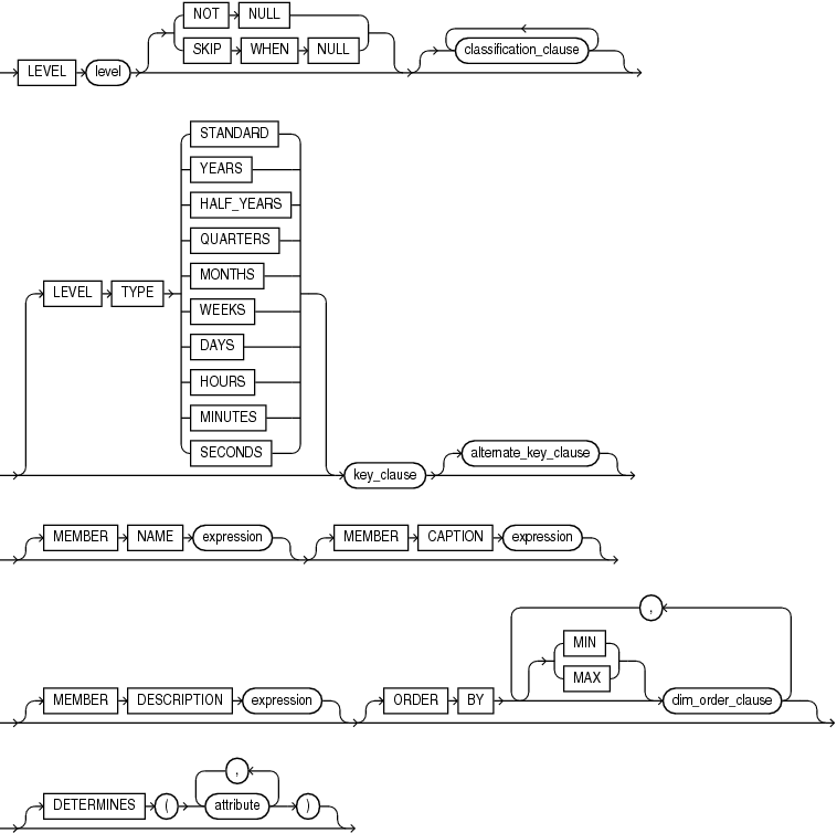

attr_dim_level_clause
Specify a level in the attribute dimension. A level specifies key and optional alternate key attributes that provide the members of the level.
If the key attribute has no NULL values, then you may specify NOT NULL, which is the default. If it does have one or more NULL values, then specify SKIP WHEN NULL.
LEVEL TYPE
A STANDARD type attribute dimension has STANDARD type levels. You do not need to specify a LEVEL TYPE for a STANDARD type attribute dimension.
In a TIME type attribute dimension, you must specify a level type. The type of the level may be one of the time types. You must specify a time type even if the values of the level members are not of that type. For example, you may have a SEASON level with values that are the names of seasons. In defining the level, you must specify any one of the time level types, such as QUARTERS. An application may use the level type designations for whatever purpose it chooses.
DETERMINES
With the DETERMINES keyword, you may specify other attributes of the attribute dimension that this level determines. If an attribute has only one value for each value of another attribute, then the value of the first attribute determines the value of the other attribute. For example, the QUARTER_ID attribute has only one value for each value of the MONTH_ID attribute, so you can include the the QUARTER_ID attribute in the DETERMINES phrase of the MONTHS level.
key_clause
Specify one or more attributes as the key for the level.
alternate_key_clause
Specify one or more attributes as the alternate key for the level.
dim_order_clause
Specify the ordering of the members of the level.
all_clause
Optionally specify MEMBER NAME, MEMBER CAPTION, and MEMBER DESCRIPTION values for the implicit ALL level. By default, the MEMBER NAME value is ALL.
