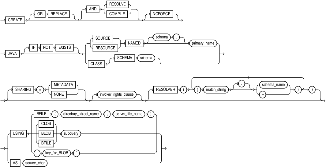

Syntax
create_java::=

OR REPLACE
Specify OR REPLACE to re-create the schema object containing the Java class, source, or resource if it already exists. Use this clause to change the definition of an existing object without dropping, re-creating, and regranting object privileges previously granted.
If you redefine a Java schema object and specify RESOLVE or COMPILE, then Oracle Database recompiles or resolves the object. Whether or not the resolution or compilation is successful, the database invalidates classes that reference the Java schema object.
Users who had previously been granted privileges on a redefined function can still access the function without being regranted the privileges.
See Also:
ALTER JAVA for additional information
IF NOT EXISTS
Specifying IF NOT EXISTS has the following effects:
If the JAVA object does not exist, a new one is created at the end of the statement.
If the JAVA object view exists, it is detected and a new one is not created.
You can only specify OR REPLACE or IF NOT EXISTS in a statement at a time. Using both OR REPLACE with IF NOT EXISTS in the very same statement results in an error.
You cannot specify IF EXISTS with CREATE statements.
You can use IF [NOT] EXISTS only from Release 19.28 and up.
RESOLVE | COMPILE
RESOLVE and COMPILE are synonymous keywords. They specify that Oracle Database should attempt to resolve the Java schema object that is created if this statement succeeds.
When applied to a class, resolution of referenced names to other class schema objects occurs.
When applied to a source, source compilation occurs.
Restriction on RESOLVE and COMPILE
You cannot specify these keywords for a Java resource.
NOFORCE
Specify NOFORCE to roll back the results of this CREATE command if you have specified either RESOLVE or COMPILE and the resolution or compilation fails. If you do not specify this option, then Oracle Database takes no action if the resolution or compilation fails, and the created schema object remains.
NAMED Clause
The NAMED clause is required for a Java source or resource. The primary_name must be enclosed in double quotation marks and its length must not exceed 4000 bytes in the database character set.
For a Java source, this clause specifies the name of the schema object in which the source code is held. A successful
CREATEJAVASOURCEstatement will also create additional schema objects to hold each of the Java classes defined by the source. -
For a Java resource, this clause specifies the name of the schema object to hold the Java resource.
Use double quotation marks to preserve a lower- or mixed-case primary_name.
If you do not specify schema, then Oracle Database creates the object in your own schema.
Restrictions on NAMED Java Classes
The NAMED clause is subject to the following restrictions:
You cannot specify
NAMEDfor a Java class. -
The
primary_namecannot contain a database link.
SCHEMA Clause
The SCHEMA clause applies only to a Java class. This optional clause specifies the schema in which the object containing the Java file will reside. If you do not specify this clause, then Oracle Database creates the object in your own schema.
SHARING
This clause applies only when creating a Java schema object in an application root. This type of object is called an application common object and it can be shared with the application PDBs that belong to the application root. To determine how the Java schema object is shared, specify one of the following sharing attributes:
METADATA- A metadata link shares the Java schema object’s metadata, but its data is unique to each container. This type of Java schema object is referred to as a metadata-linked application common object. -
NONE- The Java schema object is not shared.
If you omit this clause, then the database uses the value of the DEFAULT_SHARING initialization parameter to determine the sharing attribute of the Java schema object. If the DEFAULT_SHARING initialization parameter does not have a value, then the default is METADATA.
You cannot change the sharing attribute of a Java schema object after it is created.
See Also:
Oracle Database Reference for more information on the
DEFAULT_SHARINGinitialization parameter -
Oracle Database Administrator’s Guide for complete information on creating application common objects
invoker_rights_clause
Use the invoker_rights_clause to indicate whether the methods of the class execute with the privileges and in the schema of the user who owns the class or with the privileges and in the schema of CURRENT_USER.
This clause also determines how Oracle Database resolves external names in queries, DML operations, and dynamic SQL statements in the member functions and procedures of the type.
AUTHID CURRENT_USER
CURRENT_USER indicates that the methods of the class execute with the privileges of CURRENT_USER. This clause is the default and creates an invoker-rights class.
This clause also specifies that external names in queries, DML operations, and dynamic SQL statements resolve in the schema of CURRENT_USER. External names in all other statements resolve in the schema in which the methods reside.
AUTHID DEFINER
DEFINER indicates that the methods of the class execute with the privileges of the owner of the schema in which the class resides, and that external names resolve in the schema where the class resides. This clause creates a definer-rights class.
See Also:
Oracle Database PL/SQL Language Reference for information on how
CURRENT_USERis determined
RESOLVER Clause
The RESOLVER clause lets you specify a mapping of the fully qualified Java name to a Java schema object, where:
match_stringis either a fully qualified Java name, a wildcard that can match such a Java name, or a wildcard that can match any name. -
schema_namedesignates a schema to be searched for the corresponding Java schema object. -
A dash (-) as an alternative to
schema_nameindicates that ifmatch_stringmatches a valid Java name, Oracle Database can leave the name unresolved. The resolution succeeds, but the name cannot be used at run time by the class.
This mapping is stored with the definition of the schema objects created in this command for use in later resolutions (either implicit or in explicit ALTER JAVA ... RESOLVE statements).
USING Clause
The USING clause determines a sequence of character data (CLOB or BFILE) or binary data (BLOB or BFILE) for the Java class or resource. Oracle Database uses the sequence of characters to define one file for a Java class or resource, or one source file and one or more derived classes for a Java source.
BFILE Clause
Specify the directory and filename of a previously created file on the operating system (directory_object_name) and server file (server_file_name) containing the sequence. BFILE is usually interpreted as a character sequence by CREATE JAVA SOURCE and as a binary sequence by CREATE JAVA CLASS or CREATE JAVA RESOURCE.
CLOB | BLOB | BFILE subquery
Specify a subquery that selects a single row and column of the type specified (CLOB, BLOB, or BFILE). The value of the column makes up the sequence of characters.
In earlier releases, the USING clause implicitly supplied the keyword SELECT. This is no longer the case. However, the subquery without the keyword SELECT is still supported for backward compatibility.
key_for_BLOB
The key_for_BLOB clause supplies the following implicit query:
SELECT LOB FROM CREATE$JAVA$LOB$TABLE WHERE NAME = 'key_for_BLOB';
Restriction on the key_for_BLOB Clause
For you to use this case, the table CREATE$JAVA$LOB$TABLE must exist in the current schema and must have a column LOB of type BLOB and a column NAME of type VARCHAR2.
AS source_char
Specify a sequence of characters for a Java source.
