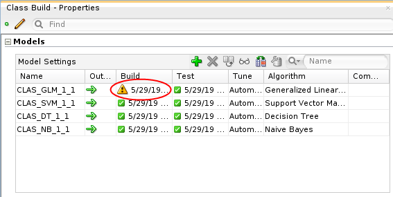

  3. Right-click the classification build node, select Go to properties, and then select the Models section in the Properties tab.
    Description of build-properties.png follows
    Note that the GLM model displays a warning icon, while the other models have green check marks.

    The event is warning that during the build, Data Miner detected that the GLM model has an invalid covariance matrix. The warning is a result a feature of Data Miner that detects when multiple variables in the data set have colinearity. This warning can generally be ignored.
