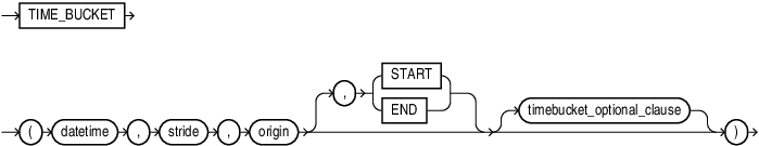

TIME_BUCKET (datetime)
Syntax
timebucket_optional_clause::=
Purpose
Use TIME_BUCKET(datetime) to obtain the datetime over an interval that you specify.
TIME_BUCKET has three required arguments, and two optional arguments .
The first argument datetime is the input to the bucket.
The third argument origin is an anchor to which all buckets are aligned.

The fourth argument is optional and specifies whether the start or the end of the time bucket is returned. Specify
STARTto return the start value of the time bucket orENDto return the end value . The values are case-insensitive. The default value isSTART. -
The fifth argument is optional and controls how the buckets (strides) are determined.
