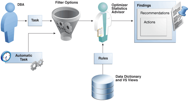

The following figure provides a conceptual overview of Optimizer Statistics Advisor.
Figure 18-1 Optimizer Statistics Advisor
Description of Figure 18-1 follows
Description of "Figure 18-1 Optimizer Statistics Advisor"
Purpose of Optimizer Statistics Advisor
Optimizer Statistics Advisor inspects how optimizer statistics are gathered.
The advisor automatically diagnoses problems in the existing practices for gathering statistics. The advisor does not gather a new or alternative set of optimizer statistics. The output of the advisor is a report of findings and recommendations, which helps you follow best practices for gathering statistics.
Optimizer statistics play a significant part in determining the execution plan for queries. Therefore, it is critical for the optimizer to gather and maintain accurate and up-to-date statistics. The optimizer provides the DBMS_STATS package, which evolves from release to release, for this purpose. Typically, users develop their own strategies for gathering statistics based on specific workloads, and then use homegrown scripts to implement these strategies.

Optimizer Statistics Advisor Concepts
Optimizer Statistics Advisor uses the same advisor framework as Automatic Database Diagnostic Monitor (ADDM), SQL Performance Analyzer, and other advisors.
Components of Optimizer Statistics Advisor
The Optimizer Statistics Optimizer framework stores its metadata in data dictionary and dynamic performance views.

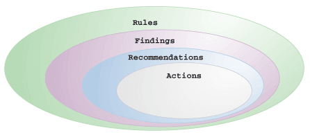

The following Venn diagram shows the relationships among rules, findings, recommendations, and actions for Optimizer Statistics Advisor. For example, all findings are derived from rules, but not all rules generate findings.
Figure 18-2 Optimizer Statistics Advisor Components

Rules for Optimizer Statistics Advisor
An Optimizer Statistics Advisor rule is an Oracle-supplied standard by which Optimizer Statistics Advisor performs its checks.
The rules embody Oracle best practices based on the current feature set. If the best practices change from release to release, then the Optimizer Statistics Advisor rules also change.

Findings for Optimizer Statistics Advisor
A finding results when Optimizer Statistics Advisor examines the evidence stored in the database and concludes that the rules were not followed.
To generate findings, Optimizer Statistics Advisor executes a task, which is invoked either automatically or manually. This task analyzes the statistics history stored in the data dictionary, the statistics operation log, and the current statistics footprint that exists in SYSAUX. For example, the advisor queries DBA_TAB_STATISTICS and DBA_IND_STATISTICS to determine whether statistics are stale, or whether a discrepancy exists between the numbers of rows.
Typically, Optimizer Statistics Advisor generates a finding when a specific rule is not followed or is violated, although some findings—such as object staleness—provide only information. For example, a finding may show that DBMS_STATS.GATHER_TABLE_STATS has used ESTIMATE_PERCENT=>0.01, which violates the ESTIMATE_PERCENT=>AUTO_SAMPLE_SIZE rule.
A finding corresponds to exactly one rule. However, a rule can generate many findings.

Recommendations for Optimizer Statistics Advisor
Based on each finding, Optimizer Statistics Advisor makes recommendations on how to achieve better statistics.
For example, the advisor might discover a violation to the rule of not using sampling when gathering statistics, and recommend specifying AUTO_SAMPLE_SIZE instead. The advisor stores the recommendations in DBA_ADVISOR_RECOMMENDATIONS.
Multiple recommendations may exist for a single finding. In this case, you must investigate to determine which recommendation to follow. Each recommendation includes one or more rationales that explain why Optimizer Statistics Advisor makes its recommendation. In some cases, findings may not generate recommendations.

Actions for Optimizer Statistics Advisor
An Optimizer Statistics Advisor action is a SQL or PL/SQL script that implements recommendations. When feasible, recommendations have corresponding actions. The advisor stores actions in DBA_ADVISOR_ACTIONS.
For example, Optimizer Statistics Advisor executes a task that performs the following steps:

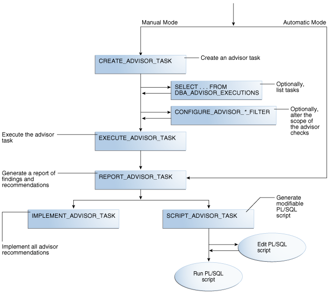

Optimizer Statistics Advisor supports both an automated and manual mode.
  • Automated
    The predefined task AUTO_STATS_ADVISOR_TASK runs automatically in the maintenance window once per day. The task runs as part of the automatic optimizer statistics collection client. The automated task generates findings and recommendations, but does not implement actions automatically.
    As for any other task, you can configure the automated task, and generate reports. If the report recommends actions, then you can implement the actions manually.
  • Manual
    You can create your own task using the DBMS_STATS.CREATE_ADVISOR_TASK function, and then run it at any time using the EXECUTE_ADVISOR_TASK procedure.
    Unlike the automated task, the manual task can implement actions automatically. Alternatively, you can configure the task to generate a PL/SQL script, which you can then run manually.
Command-Line Interface to Optimizer Statistics Advisor
Perform Optimizer Statistics Advisor tasks using the DBMS_STATS PL/SQL package.
Table 18-1 DBMS_STATS APIs for Task Creation and Deletion
PL/SQL Procedure or Function Description
CREATE_ADVISOR_TASK
Creates an advisor task for Optimizer Statistics Advisor. If the task name is already specified, then the advisor uses the specified task name; otherwise, the advisor automatically generates a new task name.
DROP_ADVISOR_TASK
Deletes an Optimizer Statistics Advisor task and all its result data.
Table 18-2 DBMS_STATS APIs for Task Execution
Executes a previously created Optimizer Statistics Advisor task.
INTERRUPT_ADVISOR_TASK
Interrupts a currently executing Optimizer Statistics Advisor task. The task ends its operations as it would in a normal exit, enabling you to access intermediate results. You can resume the task later.
CANCEL_ADVISOR_TASK
Cancels an Optimizer Statistics Advisor task execution, and removes all intermediate results of the current execution.
RESET_ADVISOR_TASK
Resets an Optimizer Statistics Advisor task execution to its initial state. Call this procedure on a task that is not currently executing.
RESUME_ADVISOR_TASK
Resumes the Optimizer Statistics Advisor task execution that was most recently interrupted.
Table 18-3 DBMS_STATS APIs for Advisor Reports
REPORT_STATS_ADVISOR_TASK
Reports the results of an Optimizer Statistics Advisor task.
GET_ADVISOR_RECS
Generates a recommendation report on the given item.
Table 18-4 DBMS_STATS APIs for Task and Filter Configuration
CONFIGURE_ADVISOR_TASK
Configures the Optimizer Statistics Advisor lists for the execution, reporting, script generation, and implementation of an advisor task.
GET_ADVISOR_OPR_FILTER
Creates an operation filter for a statistics operation.
CONFIGURE_ADVISOR_RULE_FILTER
Configures the rule filter for an Optimizer Statistics Advisor task.
CONFIGURE_ADVISOR_OPR_FILTER
Configures the operation filter for an Optimizer Statistics Advisor task.
CONFIGURE_ADVISOR_OBJ_FILTER
Configures the object filter for an Optimizer Statistics Advisor task.
SET_ADVISOR_TASK_PARAMETER
Updates the value of an Optimizer Statistics Advisor task parameter. Valid parameters are TIME_LIMIT and OP_START_TIME.
Table 18-5 DBMS_STATS APIs for Implementation of Recommended Actions
SCRIPT_ADVISOR_TASK
Gets the script that implements the recommended actions for the problems found by the advisor. You can check this script, and then choose which actions to execute.

The following figure shows the automatic and manual paths in the workflow. If AUTO_STATS_ADVISOR_TASK runs automatically in the maintenance window, then your workflow begins by querying the report. In the manual workflow, you must use PL/SQL to create and execute the tasks.
Figure 18-3 Basic Tasks for Optimizer Statistics Advisor
Description of Figure 18-3 follows
Description of "Figure 18-3 Basic Tasks for Optimizer Statistics Advisor"
Typically, you perform Optimizer Statistics Advisor steps in the sequence shown in the following table.
Table 18-6 Optimizer Statistics Advisor Workflow
Step Description To Learn More
1
Create an Optimizer Advisor task using DBMS_STATS.CREATE_ADVISOR_TASK (manual workflow only).
"Creating an Optimizer Statistics Advisor Task"
2
Optionally, list executions of advisor tasks by querying DBA_ADVISOR_EXECUTIONS.
"Listing Optimizer Statistics Advisor Tasks"
3
Optionally, configure a filter for the task using the DBMS_STATS.CONFIGURE_ADVISOR_*_FILTER procedures.
"Creating Filters for an Optimizer Advisor Task"
4
Execute the advisor task using DBMS_STATS.EXECUTE_ADVISOR_TASK (manual workflow only).
"Executing an Optimizer Statistics Advisor Task"
5
Generate an advisor report.
"Generating a Report for an Optimizer Statistics Advisor Task"
6
Implement the recommendations in either of following ways:
  • Implement all recommendations automatically using DBMS_STATS.IMPLEMENT_ADVISOR_TASK.
  • Generate a PL/SQL script that implements recommendations using DBMS_STATS.SCRIPT_ADVISOR_TASK, edit this script, and then run it manually.
"Implementing Actions Recommended by Optimizer Statistics Advisor" and "Generating a Script Using Optimizer Statistics Advisor"

  5. Execute the task opt_adv_task1.
    DECLARE
      v_tname VARCHAR2(32767);
      v_ret   VARCHAR2(32767);
    begin
      v_tname := 'opt_adv_task1';
      v_ret   := DBMS_STATS.EXECUTE_ADVISOR_TASK(v_tname);
    END;
  6. Print the report.
    SPOOL /tmp/rep.txt
    SET LONG 1000000
    COLUMN report FORMAT A200
    SET LINESIZE 250
    SET PAGESIZE 1000
    SELECT DBMS_STATS.REPORT_ADVISOR_TASK(
             task_name      => 'opt_adv_task1'
           , execution_name => NULL
           , type           => 'TEXT'
           , section        => 'ALL'
           ) AS report
    FROM   DUAL;
    SPOOL OFF
The DBMS_STATS.REPORT_ADVISOR_TASK function generates a report for an Optimizer Statistics Advisor task.
The report contains the following sections:
  • General information
    This section describes the task name, execution name, creation date, and modification date.
  • Summary
    This section summarizes the findings and rules violated by the findings.
  • Findings
    Each finding section lists the relevant rule and findings. If the advisor has a recommendation, then the recommendation is described. In some cases, a recommendation also has a rationale.
The name of the automated Optimizer Statistics Advisor task is AUTO_STATS_ADVISOR_TASK. If you follow the automated workflow, then you only need to query the automatically generated report.
