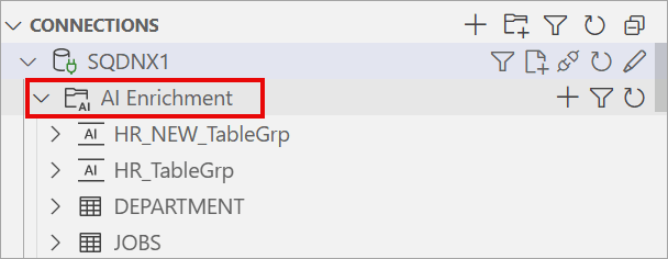

  1. In Oracle SQL Developer for VS Code, expand the Connections panel.
  2. Expand your database connection tree, and click the AI Enrichment folder.
    The image shows the AI Enrichment folder under your database connection.

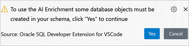

  3. In the dialog box that appears, click Yes to confirm the creation of AI enrichment objects.
    Dialog box to confirm the creation of AI enrichment objects.
    The AI enrichment feature is now available for your schema.
