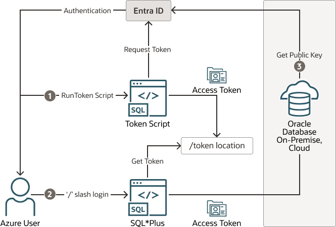

Specifying a File Location to Send the Entra ID OAuth2 Token to the Oracle AI Database
The following diagram illustrates how a file location can be used to send the Entra ID OAuth2 token to an Oracle AI Database.
Figure 4: Entra ID OAuth2 Tokens Sent to theOracle AI DatabaseUsing File Location
The Azure user requests an Entra ID access token for the database using a script and the returned token is written into a file called
tokenat a file location. The Azure user may be requested to authenticate with Entra ID at this time. -
The Azure user connects to the database using the
/slash login. Either thesqlnet.oraortnsnames.oraconnection string tells the Oracle Instant Client that an Entra IDOAuth2token is needed and to retrieve it from a specified file location. The access token is then sent to the Oracle AI Database. -
The Oracle AI Database verifies that the access token came from Entra ID (using the Entra ID public key) and then checks the token for additional claims. The database then finds the schema mapping (exclusive or shared) and creates the database session. The database will also grant any global roles that the Azure user is also assigned to through an app role.
