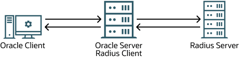

Figure 26-1 illustrates the Oracle AI Database-RADIUS environment.
Figure 26-1 RADIUS in an Oracle Environment
Description of Figure 26-1 follows
Description of "Figure 26-1 RADIUS in an Oracle Environment"
The Oracle AI Database server acts as the RADIUS client, passing information between the Oracle client and the RADIUS server. Similarly, the RADIUS server passes information between the Oracle AI Databasee server and the appropriate authentication servers.
A RADIUS server vendor is often the authentication server vendor as well. In this case authentication can be processed on the RADIUS server.

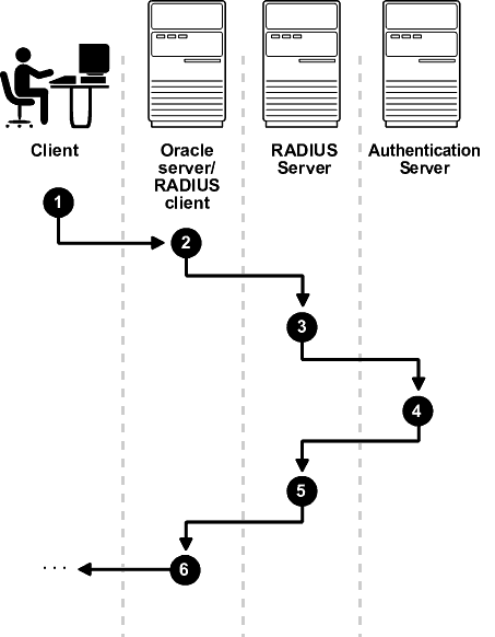

Figure 26-2 shows the sequence in which synchronous authentication occurs.
Figure 26-2 Synchronous Authentication Sequence
Description of Figure 26-2 follows
Description of "Figure 26-2 Synchronous Authentication Sequence"
The following steps describe the synchronous authentication sequence:
  1. A user logs in by entering a connect string, pass code, or other value. The client system passes this data to the Oracle database server. The pass code is frequently the password followed by the numbers in a token or text. Both credential factors are sent at the same time.
  2. The Oracle database server, acting as the RADIUS client, passes the data from the Oracle client to the RADIUS server.
  3. The RADIUS server passes the data to the appropriate authentication server.
  4. The authentication server sends either an Access Accept or an Access Reject message back to the RADIUS server.
  5. The RADIUS server passes this response to the Oracle database server/RADIUS client.
  6. The Oracle database server/RADIUS client passes the response back to the Oracle client.
