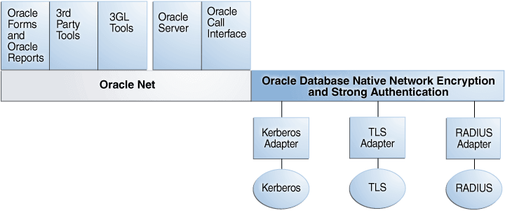

Transport Layer Security (TLS) and the Oracle Database
TLS secures connections between the Oracle Database client and server. The database server can also connect to other databases and other services using TLS version 1.3 (the default) or 1.2. This chapter will primarily focus on configuring TLS between the Oracle Database client and server.
The database client and server can be configured to use TLS depending on your requirements. There are several options to consider which are mentioned below. The primary use cases are discussed in the following topic. Advanced considerations are discussed in Advanced and Optional Configurations.

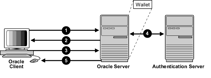

Configuring a client-server TLS connection requires the database server to have a wallet. The server wallet includes the private key, the signed user certificate, the root of trust certificate and any intermediate certificates for the database server user certificate.
The TLS wallet on the database server must be stored under the WALLET_ROOT location. (The parameter WALLET_LOCATION is deprecated for use with Oracle AI Database 26ai for the Oracle Database server. It is not deprecated for use with the Oracle Database client or listener.) Create a directory for TLS under WALLET_ROOT, so it looks like WALLET_ROOT/<PDB GUID>/tls. Each container (including CDB root) will have its own TLS wallet, there's no configuration to have a single wallet work for more than one or all containers when using WALLET_ROOT.
When configuring TLS between the database client and server there are several options to consider:

Transport Layer Security Encryption Combined with Authentication Methods
You can configure Oracle Database to use TLS concurrently with all authentication mechanisms such as database user names and passwords, RADIUS, Kerberos, PKI certificates, MS-EI, and OCI IAM.
Architecture: Oracle Database and Transport Layer Security
The Oracle Net Services with Authentication Adapters diagram, displays the Oracle Database implementation of Transport Layer Security architecture, shows that Oracle Databases operates at the session layer on top of TLS and uses TCP/IP at the transport layer. The session layer is a network layer that provides the services needed by the presentation layer entities that enable them to organize and synchronize their dialogue and manage their data exchange. This layer establishes, manages, and terminates network sessions between the client and server. The transport layer is a networking layer that maintains end-to-end reliability through data flow control and error recovery methods.
This separation of functionality lets you employ TLS concurrently with other supported protocols.
Figure 21-1 Oracle Net Services with Authentication Adapters
Description of Figure 21-1 follows
Description of "Figure 21-1 Oracle Net Services with Authentication Adapters"
How Transport Layer Security Works with Other Authentication Methods
Transport Layer Security can be used with other authentication methods that Oracle Database supports.
**INTERNAL XREF ERROR** illustrates a configuration in which Transport Layer Security is used in combination with another authentication method.
Figure 21-2 Transport Layer Security in Relation to Other Authentication Methods
Description of Figure 21-2 follows
Description of "Figure 21-2 Transport Layer Security in Relation to Other Authentication Methods"
In this example, Transport Layer Security is used to establish an encrypted network connection between the client and server, and an alternative authentication method is used to authenticate the client into the database. The process is as follows:
  1. The client seeks to connect to the Oracle database server.
  2. Transport Layer Security performs a handshake during which the server authenticates itself to the client and both the client and server establish which cipher suite to use.
  3. Once the Transport Layer Security handshake is successfully completed, the user seeks access to the database.
  4. The Oracle database server authenticates the user with the authentication server using a non-TLS authentication method such as a password, Kerberos, RADIUS, or a cloud identity token (Oracle Cloud Infrastructure (OCI) Identity and Access Management (IAM), Microsoft Azure AD).
  5. Upon validation by the authentication method, the Oracle database server grants access and authorization to the user, and then the user can access the database securely by using TLS.
