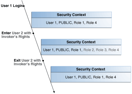

How Code Based Access Control Works with Invoker’s Rights Program Units
Code based access control can run a program unit in an invoking user’s context and with roles associated with this context.
Consider a scenario where there are two application users, 1 and 2. Application user 2 creates the invoker’s right program unit, grants database role 2 to the invoker’s rights unit, and then grants EXECUTE privileges on the invoker’s rights unit to application user 1.
Figure 9-1 shows the database roles 1 and 2 granted to application users 1 and 2, and an invoker’s right program unit.
Figure 1: Roles Granted to Application Users and Invoker’s Right Program Unit
The grants are as follows:
Application user
1is directly granted database roles1and4. -
Application user
2is directly granted database role2, which includes application roles3and4. -
The invoker’s right program unit is granted database role
2.
When application user 1 logs in and runs the invoker’s rights program unit, then the invoker’s rights unit runs with the combined database roles of user 1 and the database roles attached to the invoker’s rights unit.
Figure 9-2 shows the security context in which the invoker’s rights unit is run. When application user 1 first logs on, application user 1 has the database PUBLIC role (by default), and the database roles 1 and 4, which have been granted to it. Application user 1 next runs the invoker’s rights program unit created by application user 2.
The invoker’s rights unit runs in application user 1’s context, and has the additional database role 2 attached to it. Database roles 3 and 4 are included, as they are a part of database role 2. After the invoker’s rights unit exits, then application user 1 only has the application roles that have been granted to it, PUBLIC, role 1, and role 4.
Figure 2: Security Context in Which Invoker’s Right Program Unit IR Is Run

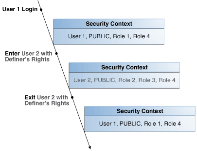

How Code Based Access Control Works with Definer’s Rights Program Units
Code based access control can be used to secure definer’s rights.
Code based access control works with definer’s rights program units to enable the program unit to run using the defining user’s rights, with the privileges of a combined set of database roles that are associated with this user.
Consider a scenario where application user 2 creates a definer’s rights program unit, grants role 2 to the definer’s rights program unit, and then grants the EXECUTE privilege on the definer’s rights program unit to application user 1.
Figure 9-3 shows the database roles granted to application users 1 and 2, and a definer’s rights program unit.
Figure 3: Roles Granted to Application Users and Definer’s Rights Program Unit
Application user
Application user
2is directly granted database role2, which includes database roles3and4. -
The definer’s right program unit is granted database role
2.
When application user 1 logs in and runs definer’s right program unit, then the definer’s rights unit runs with the combined database roles of application user 2 and the database roles attached to the definer’s rights unit (roles 2, 3, and 4).
Figure 9-4 shows the security context in which the definer’s right program unit is run. When application user 1 first logs on, application user 1 has the database PUBLIC role (by default), and the database roles 1 and4, which have been granted to it. Application user 1 next runs the definer’s rights program unit created by application user 2.
The definer’s rights program unit runs in application user 2’s context, and has the additional database role 2 attached to it. Database roles 3 and 4 are included, as they are a part of database role 2. After the definer’s rights unit exits, application user 1 only has the database roles that have been granted to it (PUBLIC, role 1, and role 4).
Figure 4: Security Context in Which Definer’s Right Program Unit DR Is Run
