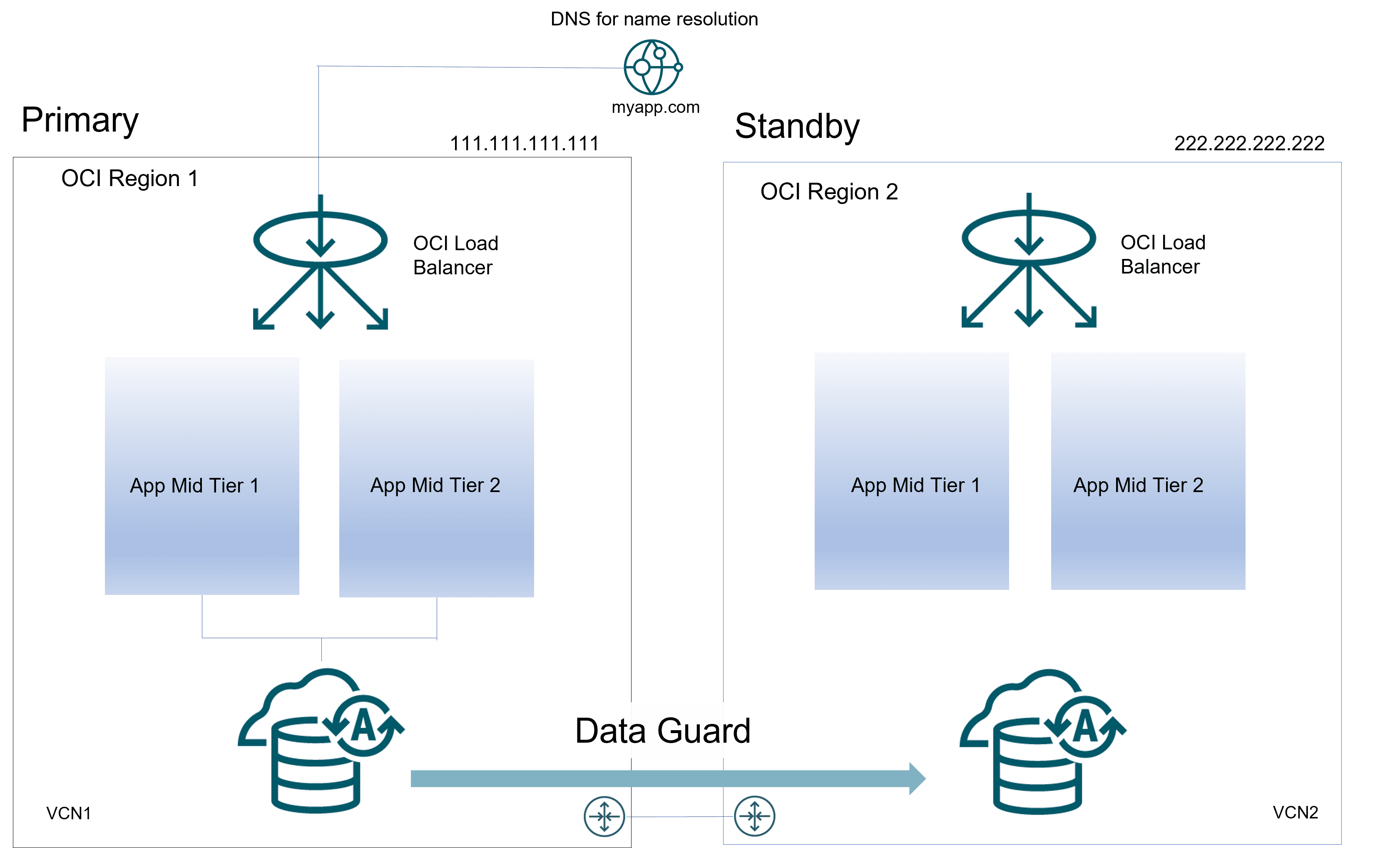

The following illustrates the possible network routes before site switchover:
Figure 46-1 Sites before switchover

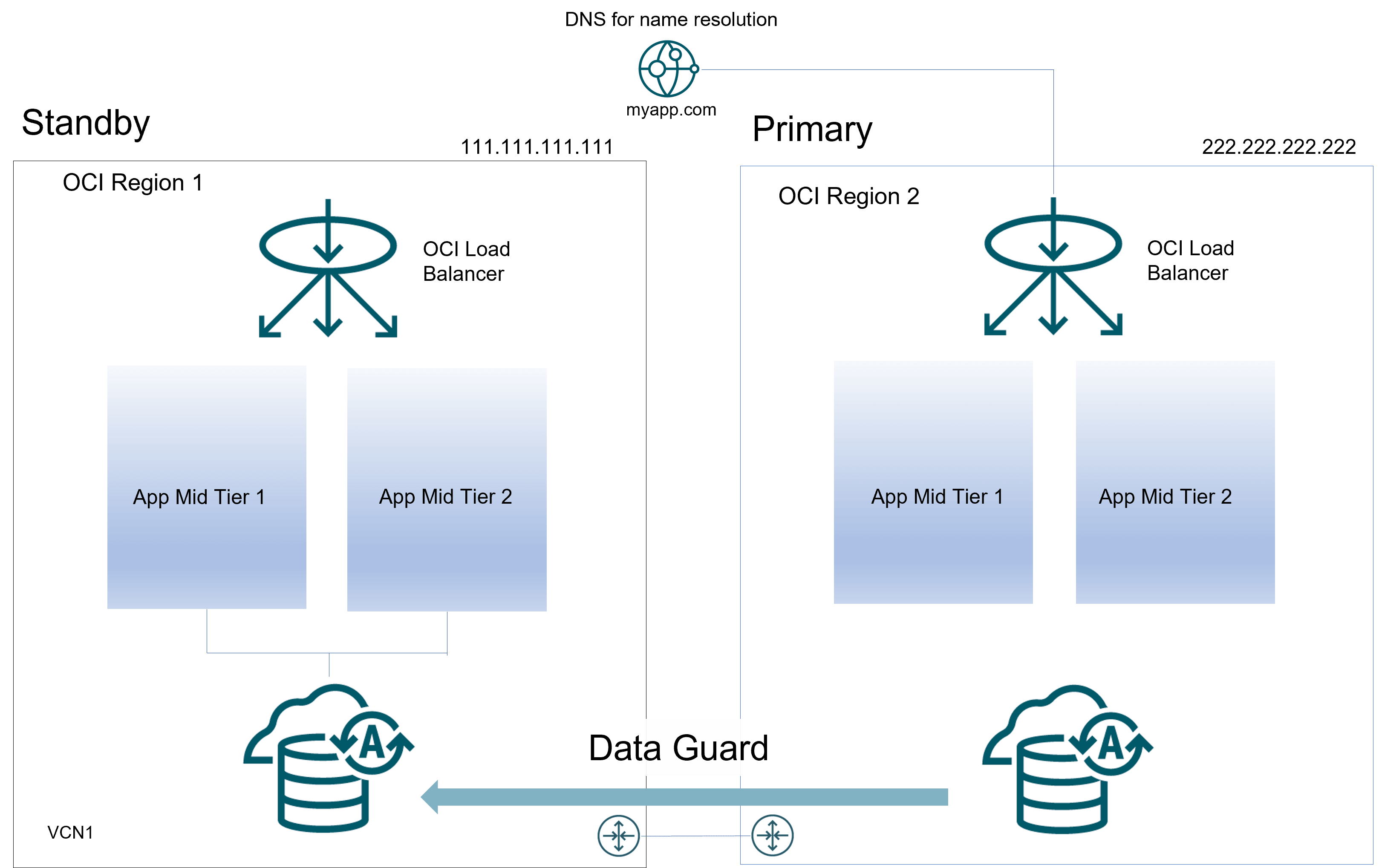

The following figure illustrates the network routes after site failover. Client or application requests enter the secondary site at the client tier and follow the same path on the secondary site that they followed on the primary site.
Figure 46-2 Sites after switchover
