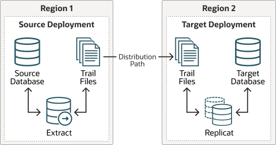

Step 4.4.3 - Distribution Path Configuration
Distribution paths are only necessary when trail files need to be sent to an additional Oracle GoldenGate Hub in a different, or even the same, region as described in the following figure.
Figure 24-3 Oracle GoldenGate Distribution Path
When using Oracle GoldenGate Distribution paths with the NGINX Reverse Proxy, additional steps must be carried out to ensure the path client and server certificates are configured.
