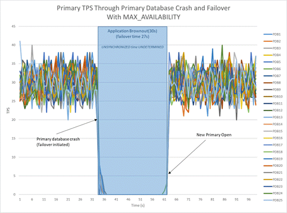

Automatic Database Failover for Primary Database Outages
Fast Start Failover (FSFO) is the Oracle Data Guard feature that performs automatic database failover when there is an outage of a primary database. FSFO is controlled by the Data Guard observer process, which is part of the Data Guard broker. When the observer process that controls automatic database failover is started, it creates threads that connect to both the primary and standby databases. Each thread creates a database session and verifies the database health using the dbms_drs package. If a thread doesn’t respond, a new thread is created and Data Guard attempts to create a session and use the dbms_drs package. If the threads do not respond by a defined period of time (threshold) then the database is considered to be unavailable.
If the primary database becomes network isolated from the standby and observer at the same time, the primary stalls (no new transactions are able to commit) until it can again make contact with either observer or standby. This is done to explicitly prevent split brain. If the observer and standby agree that neither can see the primary and if FSFO was enabled at the time they lost contact, then automatic failover occurs once the FSFO threshold is exceeded. At this same time, the primary will have also passed the FSFO threshold, causing it to abort so that existing connections are not able to continue reading stale data after a failover has occurred. If the primary is able to connect with either the observer or the standby designated as the failover target before the FSFO threshold expires, then it is allowed to continue to process transactions. If the primary aborts because the FSFO threshold is exceeded, then when the primary is restarted, it must receive permission from the observer or its original standby before it is able to open. When it makes contact, it is told that either a failover occurred while it was away, and it is automatically converted into a standby database or, if no failover occurred, it is allowed to open. This assures there is never a case where there are two active primaries at the same time.
If the primary loses contact with either the observer or the standby, the primary keeps processing transactions because it still has the ability to communicate with one of the two parties. If both the primary and standby have lost contact with the observer they fall into an UNOBSERVED state. If the primary has lost contact with the standby it falls into an UNSYNCHRONIZED state. This is how we ensure that an observer or standby outage, or the outage of both at different times, does not impact the availability of the primary database in an FSFO configuration.
If the primary database appears unavailable to the observer, the observer initiates an automatic failover if the standby is 1) responding 2) perceives the primary to be unavailable and 3) is synchronized as of the last communication.
As a best practice, the observer should ideally be located at a third site or third data center so that the primary, observer, and standby have isolated power, server, storage, and network infrastructure. It is possible to achieve a similar level of isolation using two sites; however, when Data Guard is used for disaster recovery, the observer should never be deployed at the primary database server or cluster, or on the standby database server or cluster.
An additional best practice is to have the observer use the same path to connect to the production database as is used by the application tier. The intent of this practice is for the observer to have the same access path as application connections so that if application connections can't see the primary, the observer has the same problem and can quickly respond. This best practice comes with a caveat if the application tier is local to the production database while the standby is in a remote data center for disaster recovery. In this case, it is not wise to deploy the observer with the application tier, as it could experience the same issues as the database. Instead, the observer should be deployed at either the standby location or a third data center.

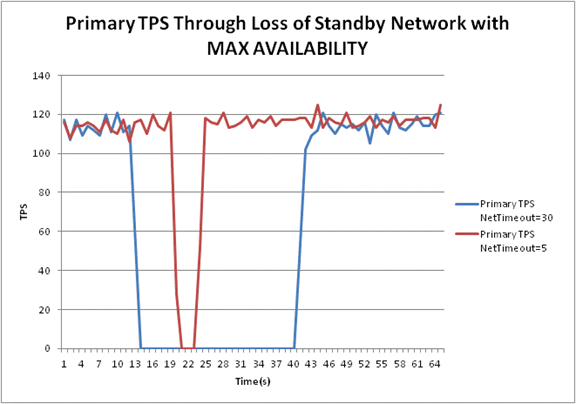

Data Guard Broker Property: NetTimeout
Default Value: 30 Seconds
Recommended value: 5 to 10 seconds if the network is responsive and reliable
Specifies a maximum number of seconds that the LGWR background process blocks while waiting for a synchronous redo transport destination to acknowledge redo data sent to it. If an acknowledgment is not received within NetTimeout seconds, an error is logged, and the redo transport session to that destination is terminated.
This property is put into effect for all outages that would place the sync transport process in a TCP timeout with the standby processes, such as network failure, standby host failure, and standby cluster failure. NetTimeout should not be set < 5 seconds.

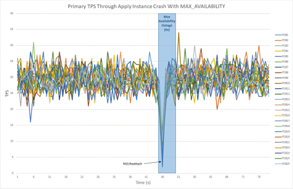

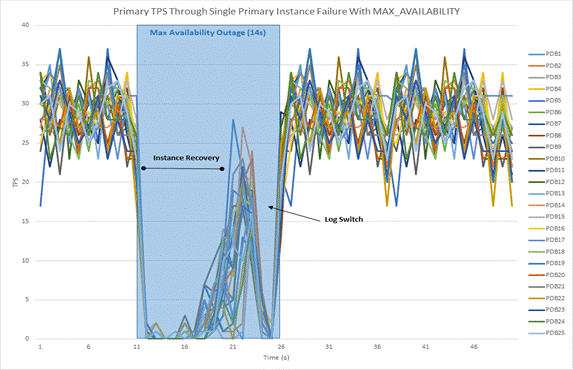

Kill Apply Instance
How to run a test
  1. Start workload on the primary database.
  2. Ensure that the primary database is in Maximum Availability mode.
    select protection_mode,protection_level from v$database;
  3. Abort instance running managed recovery process (MRP).
    shutdown abort
What to look for
  • Notification of primary becoming unsynchronized
    LGWR: Attempting destination LOG_ARCHIVE_DEST_2 network reconnect (3135)
    LGWR: Error 1041 disconnecting from destination LOG_ARCHIVE_DEST_2 standby host
  • Notification of primary becoming synchronized
    Destination LOG_ARCHIVE_DEST_2 is SYNCHRONIZED
After the first log switch, the PROTECTION_LEVEL drops to RESYNCHRONIZATION.
SQL> select inst_id,protection_mode,protection_level from gv$database;
   INST_ID PROTECTION_MODE      PROTECTION_LEVEL
         1 MAXIMUM AVAILABILITY RESYNCHRONIZATION
         2 MAXIMUM AVAILABILITY RESYNCHRONIZATION
The PROTECTION_LEVEL returns to MAXIMUM AVAILABILITY after the second log switch.
         1 MAXIMUM AVAILABILITY MAXIMUM AVAILABILITY
         2 MAXIMUM AVAILABILITY MAXIMUM AVAILABILITY
Expected impact on primary
With the loss of the apply instance, the primary database immediately switches a log to demote the destination to RESYCHRONIZATION MODE. After the primary is able to reconnect to the standby and ship the missing redo, a second log switch occurs to promote the destination to SYNCHRONOUS, restoring MAXIMUM AVAILABILITY.
Figure 20-1 Primary Database Workload with Apply Instance Crash
If the standby instances are open read-only and an apply instance is killed, all standby instances must be brought down to the mount state. This is done using alter database close normal. If this close operation takes a long time due to a large number of read-only connections, set _ABORT_ON_MRP_CRASH=TRUE. With the database initialization parameter ABORT_ON_MRP_CRASH=TRUE, the standby aborts and restarts all other instances and brings them to the mount state.

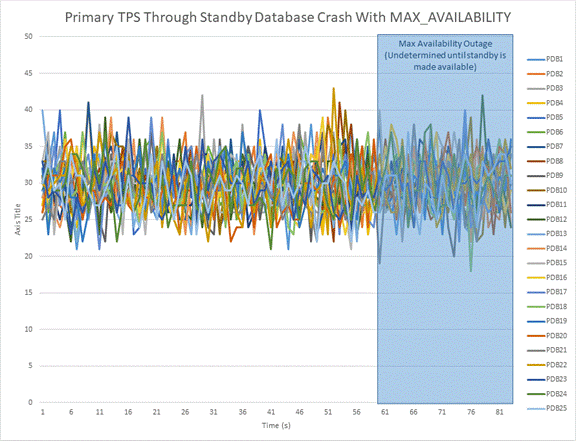

Kill Standby Database (All Instances)
How to run a test
  3. Abort all standby database instances at the same time using shutdown abort.
    srvctl stop database -d <standby> -o abort
What to look for
    Destination LOG_ARCHIVE_DEST_2 is UNSYNCHRONIZED
    This notification only occurs after the standby has been restarted.
After the log switch the PROTECTION_LEVEL drops to RESYNCHRONIZATION.
Sync transport detects the instance crashes immediately, and there should not be any additional brownout for the application. With the loss of the entire standby database, the primary database immediately switches a log in order to demote the destination to RESYCHRONIZATION MODE. The primary does not return to MAXIMUM AVAILABILITY until the standby is brought back to at least a mounted state, at which point the gap in redo will be resolved and log shipping may resume. A second brief brownout occurs when the standby is again made available to the primary due to the necessary log switch to put the configuration back into MAXIMUM AVAILABILITY.
Figure 20-2 Primary Database Workload with Standby Database Crash

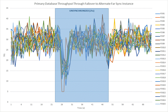

High Availability Using an Alternate Far Sync Instance
A more robust approach to maintaining data protection in the event of a Far Sync outage is to deploy a second Far Sync instance as an alternative destination. Unlike the previous example, the alternate Far Sync instance prevents the data protection level from being degraded to Maximum Performance (ASYNC) while the first Far Sync instance is repaired.
The following image shows what occurs during an outage when the active Far Sync instance in this example has failed but the server on which it was running is still operating.
  • There is a brief application brownout of 3 to 4 seconds while the primary database connects to the alternate Far Sync instance.
    • In this failure state, an error is immediately returned to the primary database without waiting for NetTimeout. The brownout can be calculated based on property settings ((MaxFailure-1)*ReopenSecs) + 4s.
  • The maximum potential data loss, should there be a second outage that impacts the primary database before the configuration is resynchronized, is a function of the amount of redo generated while the primary reconnects to the alternate Far Sync instance and the configuration is resynchronized.
Figure 20-3 Primary Database Workload with Failover to Alternate Far Sync Instance

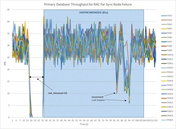

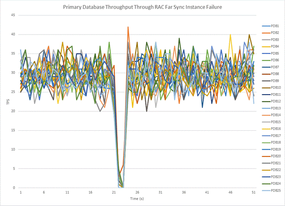

Far Sync Using Oracle Real Application Clusters
A Far Sync instance can also be placed on an Oracle RAC. In this configuration, Far Sync is only active on one server at a time while other servers provide automatic failover for HA.
The characteristics of this approach include:
  • Lowest application brownout when a Far Sync instance fails.
  • Fastest resumption of zero data loss protection after Far Sync instance failure.
  • This solution does not address cluster failure by itself; if the cluster becomes unavailable, configuring an alternate destination is still required to maintain data protection.
Far Sync Instance Failure in an Oracle RAC Cluster
The following image shows the impact on application throughput and data protection should there be a failure of the Far Sync instance receiving redo when all Oracle RAC nodes are still functional.
Figure 20-4 Primary Database Workload with RAC Far Sync Instance Failure
In this use case, when the active Far Sync instance fails, Oracle RAC immediately detects the outage and automatically fails over redo transport to an already running Far Sync instance on one of the surviving Oracle RAC nodes (no alternate destination needs to be defined for this to occur). There is a very brief application brownout of less than one second to acknowledge and process the error notification during instance failover (net_timeout does not apply to this error state). The configuration remains at the Maximum Availability protection level, maintaining zero data loss protection throughout the transition from one node of the cluster to the next – no re-transmission is necessary due to the new Far Sync instance being able to access existing SRLs on the cluster’s shared storage. Fast detection and no interruption of zero data loss protection are substantial benefits of using Oracle RAC to host the Far Sync instance.

The following image shows the impact of an Oracle RAC node failure--an outage of the server on which the active Far Sync instance is running. Node failure incurs a brief brownout equal to the Data Guard NetTimeout property causing the first dip in application throughput. Then a second brownout occurs while Data Guard redo transport re-establishes connection with the surviving node. Data loss potential is greater in this case because the node failure results in Data Guard entering a resynchronization state. Data Guard quickly resynchronizes the primary and standby and returns the configuration to a zero data loss protection level after the new connection is established. The time required to resynchronize the configuration will vary depending on how much redo needs to be transmitted to the surviving instance.
Figure 20-5 Primary Database Workload with RAC Far Sync Node Failure

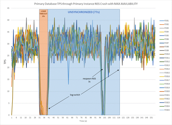

Sync Transport Process Death
How to run a test
  3. Find the NSS process for one instance.
    ps -aef | grep ora_nss
  4. Kill the NSS process.
    kill -9 <pid>
What to look for
With the loss of a sync transport process on the primary, LGWR detects sync transport death in approximately 10 seconds, after which a log switch occurs in order to demote the destination to RESYCHRONIZATION mode. Up to 60 seconds later, heartbeat ARCH initiates the respawn of the sync transport process followed by a log switch to promote the destination to MAXIMUM AVAILABILITY.
Loss of Network Between Primary and Standby Databases
How to run a test
  1. Set the standby properties NetTimeout=30 or 5 and MaxFailure=1.
  2. Start workload on the primary database.
  3. Ensure that the primary database is in Maximum Availability mode.

  4. Down the standby interfaces used by the primary as root.
    ifdown eth0
What to look for
The destination will not become resynchronized until the network is restored, the destination FAILURE_COUNT is reset, and the primary reconnects with the standby.
Once the failure count for the destination reaches the specified MaxFailure property value, the only way to reuse the destination is to modify the MaxFailure property value (setting it to the current value qualifies) or any property. This has the effect of resetting the failure count to zero (0).
Expected impact to primary
After the loss of the network the primary freezes all processing for NetTimeout seconds waiting for the network. Provided MaxFailure=1, once NetTimeout expires the destination drops to RESYNCHRONIZATION and processing continues unprotected. NetTimeout should not be set lower than 5 and should only be set as low as 5 on a low latency reliable network.
Figure 20-7 Primary Database workload with Loss of Standby Network
Primary Instance Death
How to run a test
  3. Abort one instance of the primary.
    shutdown abort
What to look for
  • There is no explicit warning in the alert log of the drop to resync however it is implied due to the loss of instance and necessary instance recovery.
  • Notification of reconfiguration and instance recovery
    Reconfiguration started (old inc 3, new inc 5)
    Instance recovery: looking for dead threads
    Completed instance recovery at
    Client pid [#####] attached to RFS pid [#####] at remote instance number [#] at dest '<standby>'
Expected Impact on Primary
After the instance is lost, one of the surviving instances performs instance recovery, and the remote destination must be re-initialized followed by a log switch, which puts the configuration back into MAXIMUM AVAILABILITY protection.
Figure 20-8 RAC Primary Database Workload with Primary instance Failure
Primary Database Outage and Failover
How to run a test
    select protection_mode, protection_level from v$database;
  3. Abort the primary database.
    shutdown abort
  4. Initiate failover to standby, using manual or Fast-start Failover (FSFO).
What to look for
  • Beginning of the failover in the initial standby alert log
    Data Guard Broker: Beginning failover
  • Completion of the failover in the initial standby alert log
    Failover succeeded. The primary database is now ‘<standby>’
After the failover, the primary database opens, providing database availability to the application. MAXIMUM AVAILABILITY protection is not restored until the old primary database is reinstated and resynchronized.
Figure 20-9 Primary Database Workload with Primary Database Crash and Failover
