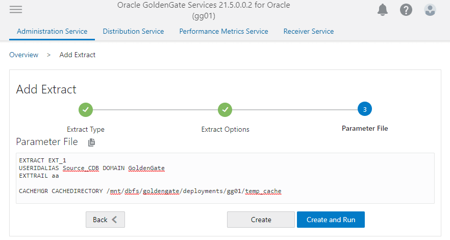

  2. If you are using DBFS for shared storage, and the deployment var/temp directory was moved to local storage as described in Task 6: Create the Oracle GoldenGate Deployment, it is recommended that you use the Extract CACHEMGR parameter to place the temporary cache files on the shared storage.
Create a new directory under the DBFS deployment mount point. For example:
$ mkdir –p /mnt/dbfs/goldengate/deployments/ggnorth/temp_cache
Set the Extract parameter to the new directory:
CACHEMGR CACHEDIRECTORY /mnt/dbfs/goldengate/deployments/ggnorth/temp_cache
Shown below is an example of how the parameters specified for an integrated Extract with the Oracle GoldenGate Administration Server GUI looks in the UI.
Figure 28-1 Extract parameters for defining the temporary cache files

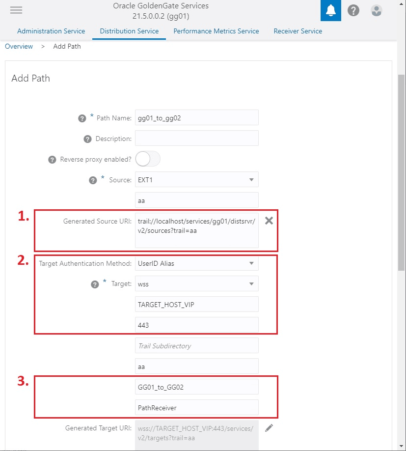

After configuring the client and server certificates, the following configuration options need to be set. Refer to the figures below to see where these options are set in the UI.
  1. Change the Generated Source URI specifying localhost for the server name.
    This allows the distribution path to be started on any of the Oracle RAC nodes.
  2. Set the Target Authentication Method to UserID Alias and the Target transfer protocol to wss (secure web socket).
    Set the Target Host to the target host name/VIP that will be used for connecting to the target system along with the Port Number that NGINX was configured with (default is 443).
    The target host name/VIP should match the common name in the CA signed certificate used by NGINX.
  3. Set the Domain to the credential domain created above in step 4 and presented in the video, for example GGNORTH_to_GGSOUTH.
    The Alias is set to the credential alias, also created in step 4 in the video.

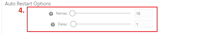

  4. Set the distribution path to automatically restart when the Distribution Server starts.
    This is required so that manual intervention is not required after an Oracle RAC node relocation of the Distribution Server. It is recommended that you set the number of Retries to 10. Set the Delay, which is the amount of time in minutes to pause between restart attempts, to 1.
Figure 28-2 Distribution Path Creation steps 1-3
Figure 28-3 Distribution Path Creation step 4

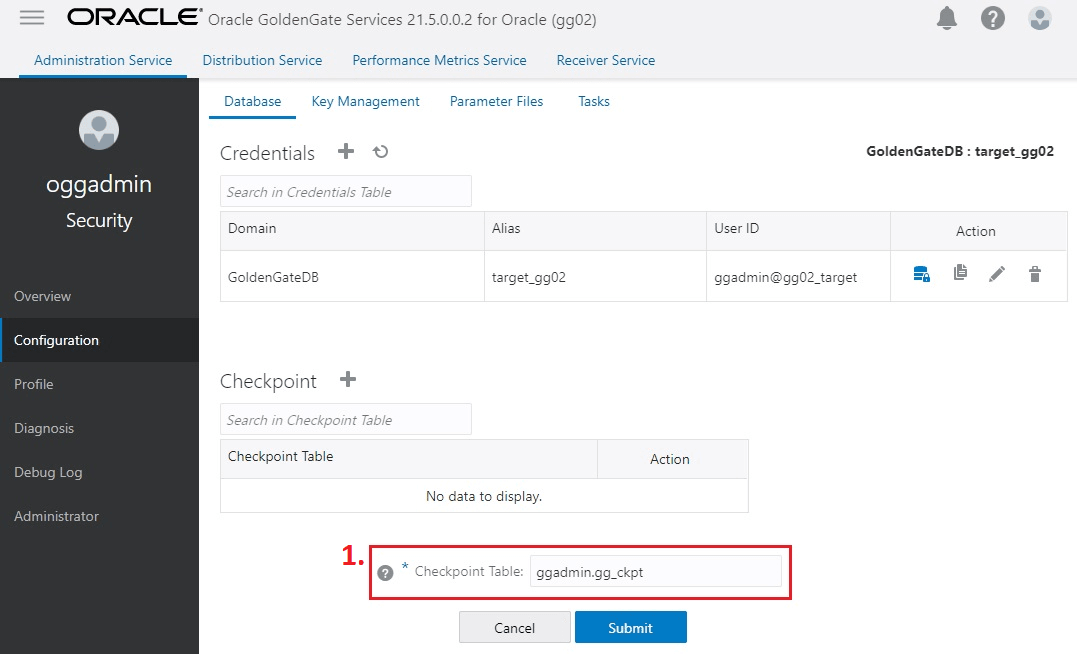

  1. The checkpoint table is a required component for GoldenGate Replicat processes. Make sure that a checkpoint table has been created in the database GoldenGate administrator (GGADMIN) schema.
    The checkpoint table can be created using the Oracle GoldenGate Administration Server GUI, clicking on the ‘+’ button and entering the checkpoint table name in the format of schema.tablename. This is shown in the image below
    Figure 28-4 Creating the checkpoint table for Replicat processes
    See About Checkpoint Table for more information about creating a checkpoint table.

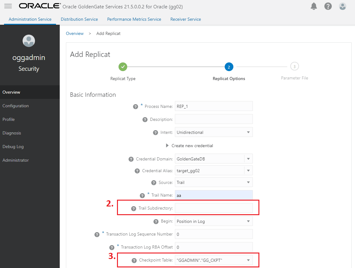

  2. When creating a Replicat using the Oracle GoldenGate Administration Server GUI interface, set the Trail SubDirectory parameter to the location where the distribution path or local Extract are creating the trail files.
  3. If a checkpoint table was created previously, select the table name from the Checkpoint Table pulldown list.
    Figure 28-5 Replicat creation with Trail SubDirectory and Checkpoint Table
