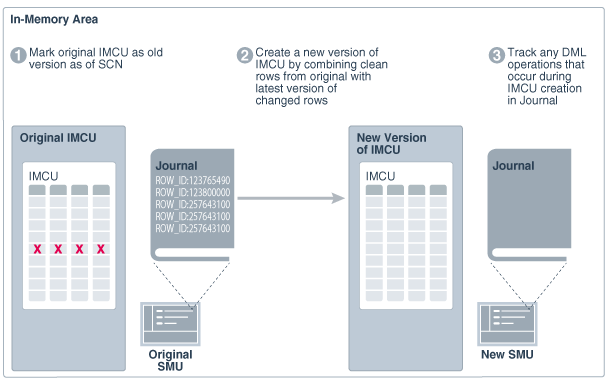

Double Buffering
In double buffering, background processes create new IMCU versions by combining the original rows with the latest modified rows.
When the database begins either threshold-based repopulation or trickle repopulation, the IM column store uses double buffering. As shown in the following figure, the IM column store maintains two versions of an IMCU simultaneously, with the original stale IMCU remaining accessible to queries.
The basic steps of double buffering are:
In the original SMU, the database marks the existing IMCU as the original version as of a specific SCN.
Background processes create a new version of the IMCU by combining the original rows with the latest versions of the modified rows.
In the journal of the new SMU, the database tracks DML operations that occur during IMCU creation.
In this way, the original IMCU stays online. The database keeps both old and new IMCUs versions for as long as they are useful, or until the IM column store is under space pressure.

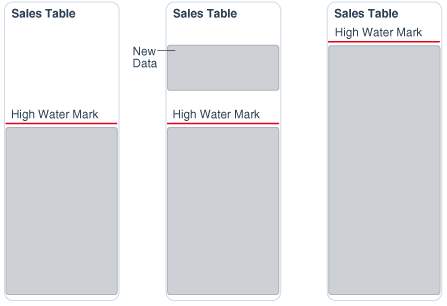

How Direct Path Loads Work with the IM Column Store
A direct path load is an INSERT /*+APPEND*/ statement or a SQL*Loader operation in which DIRECT=true .
In a direct path load, the database writes formatted data blocks directly to the data files, bypassing the database buffer cache. The database appends the data above the high water mark, which is the boundary between used and unused space in a segment. Direct path loads operate are “all or nothing” operations: the operation either inserts all data or no data.
Figure 10-2 Direct Path Loads and the High Water Mark
Description of "Figure 10-2 Direct Path Loads and the High Water Mark"
When the segment is populated in the IM column store, a direct path load works as follows:
You load data using a
CREATE TABLE AS SELECTorINSERT /*+APPEND*/statement. Only the current session is aware of the DML. -
You commit the statement.
The high water mark moves to encompass the new data, which alerts the IMCU that data is missing.
V$IM_SEGMENTS.BYTES_NOT_POPULATEDnow indicates the size of the newly inserted data. -
The IM column store manages repopulation based on the following algorithm:
If the affected object has a
PRIORITYset to a value other thanNONE, then the database repopulates the data. -
PRIORITYset toNONE, then the database repopulates at the next full scan of the object.

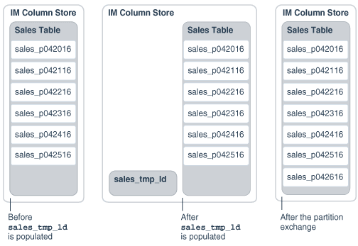

How a Partition Exchange Load Works with the IM Column Store
A partition exchange load is a technique that exchanges a table for a partition. An exchange load is almost instantaneous because it modifies metadata instead of data.
To perform an exchange load, follow these steps:
Create a nonpartitoned table, called a source table.
Load rows into the source table.
Exchange an existing table partition, called the target partition, with the table.
For the target partition to be populated in the IM column store after the exchange, the source table must be populated in the IM column store before the exchange. The following scenarios are possible, depending on the whether the target partition is populated:
Before the exchange, the target partition is not populated in the IM column store. For example, the partition is empty.
After the exchange, the source table is no longer populated in the IM column store. The source IMCUs are now associated with the target partition.
Before the exchange, the target partition is populated in the IM column store.
After the exchange, the source table remains populated in the IM column store.
Example 10-1 INMEMORY Partition Exchange Load
In this example, the sales table, which is partitioned, has the INMEMORY attribute set at the table level. All non-empty partitions in this table are currently populated. The sales_p042616 partition is currently empty. Your goal is to populate the empty partition sales_p042616 with data contained in text files. The following figure illustrates the before and after scenarios.
To perform the exchange, do the following:
Create an external table
sales_tmp_extusing theCREATE TABLE ... ORGANIZATION EXTERNALstatement.The external table does not reside in the database, and can be in any format for which an access driver is provided. The table is read-only.
Create a nonpartitioned table named
sales_tmp_ldusingCREATE TABLE ... AS SELECT * FROM sales_tmp_ext.The
sales_tmp_ldtable is not external, which means it stores rows in the data files. -
Set the
INMEMORYattribute insales_tmp_ldusing anALTER TABLEstatement.The
sales_tmp_ldtable is now marked asINMEMORY, but it is not yet populated into the IM column store. -
Populate
sales_tmp_ldinto the IM column store by forcing a full table scan.For example, the following query forces a full scan:
SELECT /*+ FULL(s) NO_PARALLEL(s) */ COUNT(*) FROM sales_tmp_ld s; -
Exchange the
sales_p042616partition with thesales_tmp_ldtable.For example, alter the
salestable as follows:ALTER TABLE sales EXCHANGE PARTITION sales_p042616 WITH TABLE sales_tmp_ld;
After the exchange completes, the sales_p042616 partition is populated in the IM column store, and the sales_tmp_ld is no longer populated.

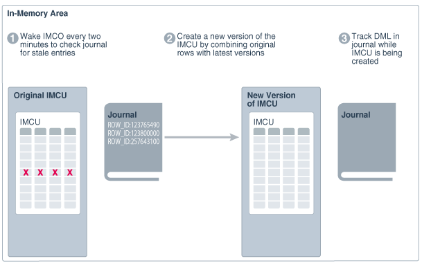

Trickle repopulation
The IMCO (In-Memory Coordinator) background process periodically checks whether stale rows exist, and then adds IMCUs to a repopulation queue. This mechanism does not depend on meeting the staleness threshold. The
INMEMORY_TRICKLE_REPOPULATE_SERVERS_PERCENTinitialization parameter limits the number of background processes used for trickle repopulation. Setting this parameter to0disables trickle repopulation.
Trickle repopulation is analogous to Java garbage collection. The mechanism works as follows:
IMCO wakes up.
IMCO determines whether any population tasks need to be performed, including whether any stale entries exist in the transaction journal associated with an IMCU.
If IMCO finds stale entries, then it triggers a Space Management Worker Process (Wnnn) to create a new version of the IMCU.
During IMCU creation, the database records the rowids of modified rows in the transaction journal.
IMCO sleeps for two minutes, and then returns to Step 1.
