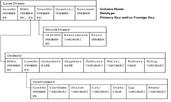

To illustrate schema and data migration from a non-distributed database to distributed database, we will use a sample data model shown in the following figure.
Figure 12-1 Schema Migration Example Data Model
Description of Figure 12-1 follows
Description of "Figure 12-1 Schema Migration Example Data Model"
The data model consists of four tables, Customers, Orders, StockItems, and LineItems, and the data model enforces the following primary key constraints.
  • Customer.(CustNo)
  • Orders.(PONo)
  • StockItems.(StockNo)
  • LineItems.(LineNo, PONo)
The data model defines the following referential integrity constraints.
  • Customers.CustNo -> Orders.CustNo
  • Orders.PONo -> LineItems.PONo
  • StockItems.StockNo -> LineItems.StockNo

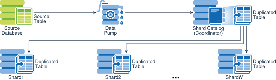

Loading Data into Duplicated Tables
You can load data into a duplicated table using any existing database tools, such as Data Pump, SQL Loader, or plain SQL. The data must be loaded to the shard catalog database. Then it gets automatically replicated to all shards.
Because the contents of the duplicated table is fully replicated to the database shards using materialized views, loading a duplicated table may take longer than loading the same data into a regular table.
Figure 12-2 Loading Duplicated Tables

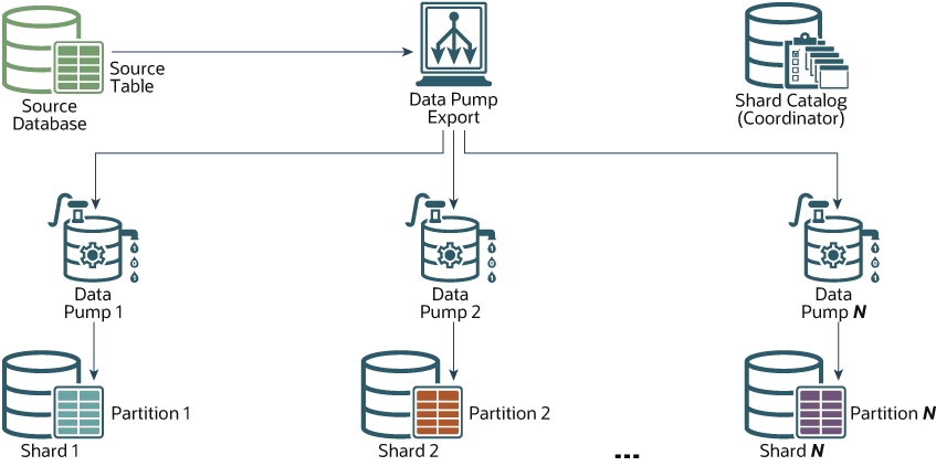

Loading Data into Sharded Tables
When loading a sharded table, each database shard accommodates a distinct subset of the data set, so the data in each table must be split (partitioned) across shards during the load.
You can use the Oracle Data Pump utility to load the data across database shards in subsets. Data from the source database can be exported into a Data Pump dump file. Then Data Pump import can be run on each shard concurrently by using the same dump file.
The dump file can be either placed on shared storage accessible to all shards, or copied to the local storage of each shard. When importing to individual shards, Data Pump import ignores the rows that do not belong to the current shard.
Figure 12-3 Loading Sharded Tables Directly to the Database Shards
Loading the data directly into the shards is much faster, because all shards are loaded in parallel. It also provides linear scalability; the more shards there are in the distributed database, the higher data ingestion rate is achieved.

  4. Load the DUPLICATED table (StockItems) using the shard catalog.
    The following is an example of the import command.
    impdp uname/pwd@catnode:1521/ctlg directory=expdir dumpfile=original_tables.dmp logfile=imp_dup.log tables=StockItems content=DATA_ONLY
  5. Load the SHARDED tables on the shards directly.
    The best way to load the exported SHARDED tables (Customers, Orders) is to run the Data Pump on each shard (shrd1,2,…, N) directly. The following is an example of the import command on the first shard.
    impdp uname/pwd@shrdnode:1521/shrd1 directory=expdir DUMPFILE=original_tables.dmp LOGFILE=imp_shd1.log TABLES=”Customers, Orders, LineItems” CONTENT=DATA_ONLY
    Repeat this step on all of the other shards. Note that the same dump file (original_tables.dmp) is used to load data for all of the shards. Data Pump import will ignore rows that do not belong to the current shard. This operation can be run in parallel on all shards.

Because of the schema mismatch between the non-sharded and sharded versions of the table, data migration for LineItems must be handled differently, as shown in the following steps.
  1. On the source, non-distributed database, create a temporary view with the missing column and SQL expression to generate value for this column.
    CREATE OR REPLACE VIEW Lineitems_View AS
      SELECT l.*,
            (SELECT o.CustNo From Orders o WHERE l.PoNo=o.PoNo) CustNo
    FROM LineItems l;
    This creates a view LineItems_View with the column CustNo populated based on the foreign key relationship with the Orders table.
