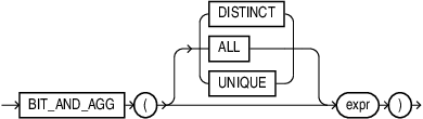

BIT_AND_AGG is a bitwise aggregation function that returns the result of a bitwise AND operation.
You can use ` BIT_AND_AGG as part of a GROUP BY query, window function, or as an analytical function. The return type of BIT_AND_AGG` is always a number.
Semantics
The keywords DISTINCT or UNIQUE ensure that only unique values in expr are used for computation. UNIQUE is an Oracle-specific keyword and not an ANSI standard.
NULL values in the expr column are ignored.
Returns NULL if all rows in the group have NULL expr values.
Floating point values are truncated to the integer prior to aggregation. For instance, the value 4.64 is converted to 4, and the value 4.4 is also converted to 4.
Negative numbers are represented in two’s complement form internally prior to performing an aggregate operation. The resultant aggregate could be a negative value.
Range of inputs supported: -2 raised to 127 to (2 raised to 127) -1
Numbers are internally converted to a 128b decimal representation prior to aggregation. The resultant aggregate is converted back into an Oracle Number.
For a given set of values, the result of a bitwise aggregate is always deterministic and independent of ordering.
For the semantics of the FILTER clause, see FILTER Clause Semantics.
