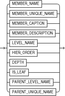

hier_attr_name::=

hier_attr_name
Specify a hierarchical attribute.
