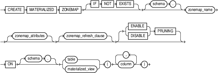

create_zonemap_on_table::=

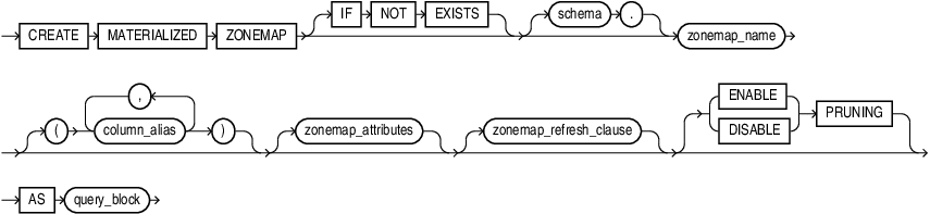

create_zonemap_as_subquery::=
Use this clause to create a basic zone map.
ON Clause
In the ON clause, first specify the fact table for the zone map, and then inside the parentheses specify one or more columns of the fact table to be included in the zone map.
For each specified fact table column, Oracle creates two columns in the zone map. These two columns contain the minimum and maximum values of the fact table column in each zone. Oracle generates names for the zone map columns of the form MIN_1_column and MAX_1_column for the first specified fact table column, MIN_2_column and MAX_2_column for the second specified fact table column, and so on.
If you omit schema, then Oracle assumes the fact table is in your own schema. The fact table can be a table or a materialized view
