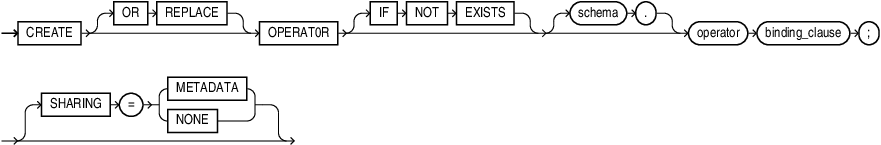

create_operator::=

Semantics
OR REPLACE
Specify OR REPLACE to replace the definition of the operator schema object.
Restriction on Replacing an Operator
You can replace the definition only if the operator has no dependent objects, such as indextypes supporting the operator.
IF NOT EXISTS
Specifying IF NOT EXISTS has the following effects:
If the operator does not exist, a new operator is created at the end of the statement.
If the operator exists, this is the operator you have at the end of the statement. A new one is not created because the older one is detected.
You can have one of OR REPLACE or IF NOT EXISTS in a statement at a time. Using both OR REPLACE with IF NOT EXISTS in the very same statement results in the following error: ORA-11541: REPLACE and IF NOT EXISTS cannot coexist in the same DDL statement.
Using IF EXISTS with CREATE results in ORA-11543: Incorrect IF NOT EXISTS clause for CREATE statement.
schema
Specify the schema containing the operator. If you omit schema, then the database creates the operator in your own schema.
operator
Specify the name of the operator to be created. The name must satisfy the requirements listed in “Database Object Naming Rules”.
binding_clause
Use the binding_clause to specify one or more parameter data types (parameter_type) for binding the operator to a function. The signature of each binding-the sequence of the data types of the arguments to the corresponding function-must be unique according to the rules of overloading.
The parameter_type can itself be an object type. If it is, then you can optionally qualify it with its schema.
Restriction on Binding Operators
You cannot specify a parameter_type of REF, LONG, or LONG RAW.
See Also: Oracle Database PL/SQL Language Reference for more information about overloading
RETURN Clause
Specify the return data type for the binding.
The return_type can itself be an object type. If so, then you can optionally qualify it with its schema.
Restriction on Binding Return Data Type
You cannot specify a return_type of REF, LONG, or LONG RAW.
SHARING
Use the sharing clause if you want to create the object in an application root in the context of an application maintenance. This type of object is called an application common object and it can be shared with the application PDBs that belong to the application root.
You can specify how the object is shared using one of the following sharing attributes:
METADATA- A metadata link shares the metadata, but its data is unique to each container. This type of object is referred to as a metadata-linked application common object. -
NONE- The object is not shared and can only be accessed in the application root.
implementation_clause
Use this clause to describe the implementation of the binding.
ANCILLARY TO Clause
Use the ANCILLARY TO clause to indicate that the operator binding is ancillary to the specified primary operator binding (primary_operator). If you specify this clause, then do not specify a previous binding with just one number parameter.
Use the context_clause to describe the functional implementation of a binding that is not ancillary to a primary operator binding.
WITH INDEX CONTEXT, SCAN CONTEXT
Use this clause to indicate that the functional evaluation of the operator uses the index and a scan context that is specified by the implementation type.
COMPUTE ANCILLARY DATA
Specify COMPUTE ANCILLARY DATA to indicate that the operator binding computes ancillary data.
WITH COLUMN CONTEXT
Specify WITH COLUMN CONTEXT to indicate that Oracle Database should pass the column information to the functional implementation for the operator.
If you specify this clause, then the signature of the function implemented must include one extra ODCIFuncCallInfo structure.
See Also: Oracle Database Data Cartridge Developer’s Guide for instructions on using the ODCIFuncCallInfo routine
using_function_clause
The using_function_clause lets you specify the function that provides the implementation for the binding. The function_name can be a standalone function, packaged function, type method, or a synonym for any of these.
If the function is subsequently dropped, then the database marks all dependent objects INVALID, including the operator. However, if you then subsequently issue an ALTER OPERATOR … DROP BINDING statement to drop the binding, then subsequent queries and DML will revalidate the dependent objects.
Examples
Creating User-Defined Operators: Example
This example creates a very simple functional implementation of equality and then creates an operator that uses the function. For a more complete set of examples, see Oracle Database Data Cartridge Developer’s Guide.
CREATE FUNCTION eq_f(a VARCHAR2, b VARCHAR2) RETURN NUMBER AS
BEGIN
IF a = b THEN RETURN 1;
ELSE RETURN 0;
END IF;
END;
CREATE OPERATOR eq_op
BINDING (VARCHAR2, VARCHAR2)
RETURN NUMBER
USING eq_f;
