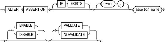

Use ALTER ASSERTION to change the properties of an assertion, one of ENABLE, DISABLE, VALIDATE, NOVALIDATE.

IF EXISTS
Specify IF EXISTS to prevent an error message in case the assertion you are trying to alter, doesn't exist.
You cannot use IF NOT EXISTS with ALTER statements.
The following rules apply when you change the property of an assertion:
  • Moving from DISABLE to ENABLE, by default, uses VALIDATE. Moving from ENABLE to DISABLE uses NOVALIDATE by default. DISABLE VALIDATE is unsupported.
  • Moving between VALIDATE and NOVALIDATE, by default, leaves ENABLE and DISABLE unchanged.
  • Moving an assertion from NOVALIDATE to VALIDATE, requires a check of all data. This is potentially an expensive operation.
  • Moving an assertion from VALIDATE to NOVALIDATE forgets that the data was ever checked.
  • Moving an assertion from ENABLE NOVALIDATE to ENABLE VALIDATE does not block reads, writes, or other DDL. This transition can be done using parallel execution for the validation query.
