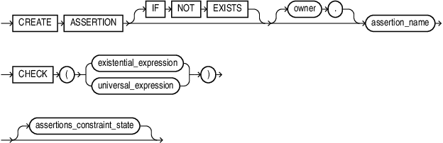

CREATE ASSERTION
Purpose
Assertions are boolean expressions that have the semantics of a constraint. The database must ensure the truth of these boolean expressions while transactions change data and commit these changes.
Prerequisites
Assertions are schema-level objects. If the boolean expression references tables of other schemas, you must have the required object-privileges to access these tables.
When a foreign key constraint references a parent table in another schema, you are required to have the REFERENCES object privilege on the parent table.
For assertions to reference tables in another schema you require the ASSERTION REFERENCES object privilege on those tables. Also note that you must prefix these tables from other schemas with their schema-name (SYNONYMs are unsupported in assertions).
To create a assertion in your own schema, you must have the CREATE ASSERTION system privilege. With the CREATE ASSERTION privilege you can alter and drop assertions in the same schema using ALTER ASSERTION and DROP ASSERTION.
To create assertions in any schema or a specified schema, you must have the CREATE ANY ASSERTION [ON SCHEMA...] system privilege.
Note that constraints and assertions live in the same namespace: an assertion cannot have a name already in use by a constraint in the same schema, and vice-versa.
Semantics
IF NOT EXISTS
Specifying IF NOT EXISTS will mask the ORA-00955: name is already used by an existing object error when you attempt to create an assertion that already exists.
existential_expression
The subquery in the [NOT] EXISTS must access base schema tables and can be equijoins of multiple tables. The subquery can have regular column filters that are logically AND-ed, or OR-d.
These column filters predicates can,
  • Involve comparisons between columns and/or literals using <, >, <>(!=), BETWEEN.
  • Include any operation on columns such as +, -, *, /, SUBSTR, UPPER.
  • Be of form T1.c1 + T2.C2 = T3.C3.
The subquery can also have a mix of nested [NOT] EXISTS subquery predicates, which can go up to three levels deep. These nested subqueries can be correlated to query-blocks further up, or uncorrelated. Alternatively you can use [NOT] IN syntax instead of [NOT] EXISTS syntax.
universal_expression
Assertions introduces a new ALL...SATISFY clause. ALL...SATISFY reduces the number of negations when specifying assertions. The following example illustrates the new syntax.

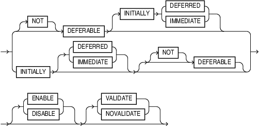

[NOT] DEFERRABLE [ INTIALLY ] IMMEDIATE | DEFERRED
Assertions can be in different states DEFERRABLE or NOT DEFERRABLE and INITIALLY IMMEDIATE or INITIALLY DEFERRED. The behavior is the same as constraints.
DEFERRABLE Clause
The DEFERRABLE and NOT DEFERRABLE parameters indicate whether or not, in subsequent transactions, assertion checking can be deferred until the end of the transaction using the SET CONSTRAINT(S) statement. If you omit this clause, then the default is NOT DEFERRABLE.
  • Specify NOT DEFERRABLE to indicate that in subsequent transactions you cannot use the SET CONSTRAINT[S] clause to defer checking of this assertion until the transaction is committed. The checking of a NOT DEFERRABLE SQL assertion can never be deferred to the end of the transaction.
  • Specify DEFERRABLE to indicate that in subsequent transactions you can use the SET CONSTRAINT[S] clause to defer checking of this assertion until a COMMIT statement is submitted. If the assertion check fails, then the database returns an error and the transaction is not committed. This setting in effect lets you disable the constraint temporarily while making changes to the database that might violate the constraint until all the changes are complete.
You cannot alter the deferrability of an assertion. Whether you specify either of these parameters, or make the assertion NOT DEFERRABLE implicitly by specifying neither of them, you cannot specify this clause in an ALTER ASSERTION statement. You must drop the assertion and re-create it.
See Also:
SET CONSTRAINT[S]
INTIALLY Clause
The INITIALLY clause establishes the default checking behavior for assertions that are DEFERRABLE. The INITIALLY setting can be overridden by a SET CONSTRAINT[S] statement in a subsequent transaction.
  • Specify INITIALLY IMMEDIATE to have the database check the assertion at the end of each subsequent SQL statement. If you do not specify INITIALLY , then the default is INITIALLY IMMEDIATE.
  • Specify INITIALLY DEFERRED to have the database check the assertion at the end of subsequent transactions.
    This clause is not valid if you have declared the constraint to be NOT DEFERRABLE, because a NOT DEFERRABLE constraint is automatically INITIALLY IMMEDIATE and cannot ever be INITIALLY DEFERRED.
ENABLE | DISABLE , VALIDATE | NOVALIDATE
Assertions can have two properties:
  • ENABLE or DISABLE
    This property determines whether the assertion is enforced on execution of DML statements.
  • VALIDATE or NOVALIDATE
    This property determines whether all data in the involved tables of a assertion, currently obey the assertion.
Combining these two properties results in four possible states:
  • ENABLE VALIDATE
    All data obeys the assertion. This means that the existing data in referenced tables was validated when the assertion was enabled, as well as any subsequent data changes made by DML statements.
  • ENABLE NOVALIDATE
    All data may not obey the assertion. This means that the existing data in the referenced tables was not validated when the constraint was enabled, but any subsequent data changes made by DML statements were validated.
  • DISABLE VALIDATE
    All data in referenced tables obey the assertion, and execution of potentially violating DML statements is not allowed. This setting was introduced in Oracle release 8.1 specifically for constraints on partitioned tables in a data warehouse environment. This state does not apply to assertions.
  • DISABLE NOVALIDATE
    All data may not obey the assertion, and the assertion is not enforced during DML statement execution.
The following rules govern the default settings of the properties, ENABLE/DISABLE and VALIDATE/NOVALIDATE with an assertion, which is the same behavior as with constraints:
  • If neither of them is specified, then ENABLE / VALIDATE is the default.
  • If only ENABLE is specified, then VALIDATE is the default.
  • If only DISABLE is specified, then NOVALIDATE is the default.
  • If only VALIDATE is specified, then ENABLE is the default.
  • If only NOVALIDATE is specified, then ENABLE is the default.
