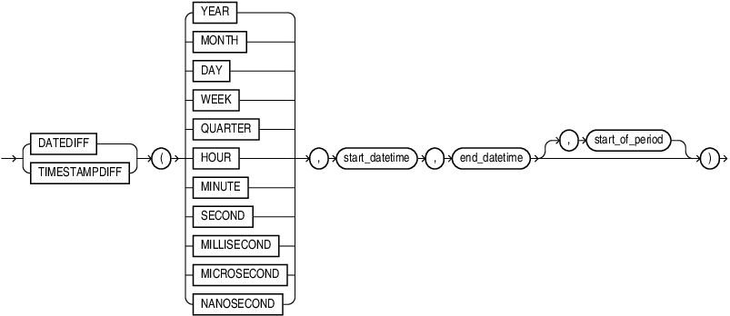

DATEDIFF
Syntax

DATEDIFF computes the difference between two datetime values in years, months, days, weeks, and other time units.
TIMESTAMPDIFF is a synonym of DATEDIFF.
Semantics
The function takes three arguments, time_unit, start_datetime, end_datetime, and returns a number that represents the number of time unit boundaries between start and end datetimes. The return value is an integer that is positive when the end datetime is later than the start datetime and negative when the end datetime is earlier than start datetime.
The first argument time_unit, is one of YEAR, MONTH,DAY, WEEK, QUARTER, HOUR, MINUTE, SECOND, MILLISECOND, MICROSECOND, and NANOSECOND, or a run-time CHAR value that evaluates to one of these types.
The second and third arguments, start_datetime, end_datetime, must be expressions evaluating to values of the data type DATE, TIMESTAMP, TIMESTAMP WITH TIME ZONE, TIMESTAMP WITH LOCAL TIME ZONE.
The optional fourth argument start_of_period can be specified when the time unit is WEEK, QUARTER, or YEAR and means the following:
When time unit is
WEEK, start_of_period means “start of week”. The allowed values are 0, 1, 2, 3, 4, 5, 6, and 7. The default value is 0, which means that the first day of the week is determined by theNLS_TERRITORYparameter. The value 1 means Monday, 2 means Tuesday, 3 means Wednesday, 4 means Thursday, 5 means Friday, 6 means Saturday, and 7 means Sunday. -
When time unit is
QUARTER, start_of_period means “start of quarter”. The allowed values are 1, 2, 3, 4, 5, 6, 7, 8, 9, 10, 11, and 12. The default value is 1. The values 1, 4, 7, and 10 mean that quarters start on the first days of January, April, July, and October. All four values are equivalent. The values 2, 5, 8, and 11 mean that quarters start on first days of February, May, August, and November. These four values are also equivalent. The values 3, 6, 9, and 12 mean that quarters start on first days of March, June, September, and December. Again, these four values are equivalent. -
When time unit is
YEAR, start_of_period means “start month of year”. The allowed values are 1, 2, 3, 4, 5, 6, 7, 8, 9, 10, 11, and 12. The default value is 1. The value 1 means that the year starts on the first day of January, 2 means that it starts on the first day of February, and so on until 12, which means that the year starts on the first day of December.
Non-default values for the start of the quarter and the start of the year are useful in calculations pertaining to fiscal quarters and years when the fiscal year does not begin on January 1st.
DATEDIFF does not support non-Gregorian calendars. The calculations are always performed in the Gregorian calendar even if the value of the corresponding NLS_CALENDAR setting is not GREGORIAN.
Use Oracle Locale Builder to check the first day of calendar week for particular values of NLS_TERRITORY.
Specifying start_of_period if time unit is not WEEK, QUARTER, or YEAR is a syntax error.
