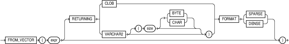

FROM_VECTOR takes a vector as input and returns a string of type VARCHAR2 or CLOB as output.
Purpose
FROM_VECTOR optionally takes a RETURNING clause to specify the data type of the returned value.
If VARCHAR2 is specified without size, the size of the returned value size is 32767.
You can optionally specify the text format of the output in the FORMAT clause, using the tokens SPARSE or DENSE. Note that the input vector storage format does not need to match the specified output format.
There is no support to convert to CHAR, NCHAR, and NVARCHAR2.
FROM_VECTOR is synonymous with VECTOR_SERIALIZE.
Parameters
expr must evaluate to a vector. The function returns NULL if expr is NULL.
