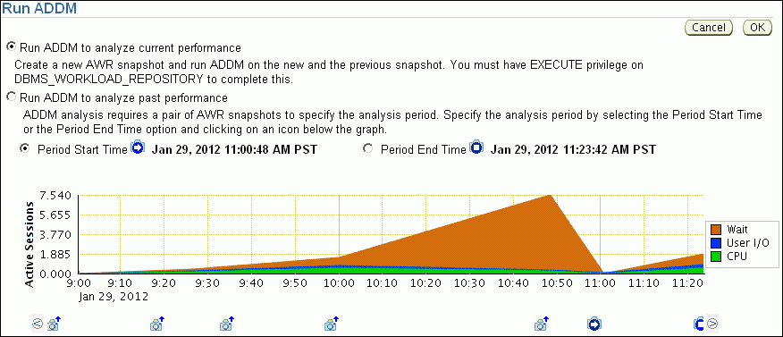

  3. Under Advisors, select ADDM. The Run ADDM page appears.
    In this example, the average active sessions with wait events rose at 10:00 a.m., peaking at 10:50 a.m. The number dipped at 11:00 a.m. and then started to rise again at 11:10 a.m.
  4. Select Run ADDM to analyze current performance and click OK.

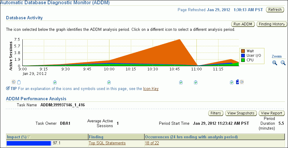

    An ADDM run occurs for the time period between the new and the previous snapshot. After ADDM completes the analysis, the Automatic Database Diagnostic Monitor (ADDM) page appears with the results.
  6. Click View Report.
    The View Report page appears.
