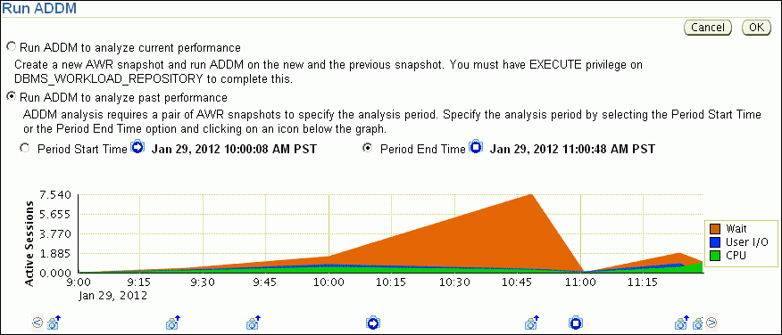

  4. Select Run ADDM to analyze past performance.
  5. Specify a time period for analysis by selecting a pair of AWR snapshots. Complete the following steps:
    1. Select Period Start Time.
    2. Below the chart for the starting snapshot, click the snapshot you want to use for the start time.
      A play icon (displayed as an arrow) appears over the snapshot icon.
      In this example, database activity peaked from 10 a.m. to 11 a.m., so the snapshot taken at 10 a.m. is selected for the start time.
    3. Select Period End Time.
    4. Below the chart for the ending snapshot, click the snapshot you want to use for the end time.
      A stop icon (displayed as a square) appears over the snapshot icon.
      In this example, the ending snapshot is at 11:00 a.m.

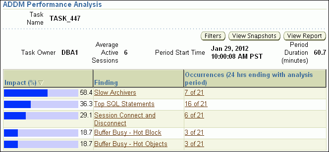

    After ADDM completes the analysis, the Automatic Database Diagnostic Monitor (ADDM) page appears with the results of the ADDM run.
    Figure 1: Analyzing Historical Database Performance
  1. Click View Report.
    The View Report page appears.
