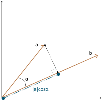

The dot product similarity of two vectors can be viewed as multiplying the size of each vector by the cosine of their angle. The corresponding geometrical interpretation of this definition is equivalent to multiplying the size of one of the vectors by the size of the projection of the second vector onto the first one, or vice versa.
As illustrated in the following diagram, you project one vector on the other and multiply the resulting vector sizes.
Incidentally, this is equivalent to the sum of the products of each vector's coordinate. Often, you do not have access to the cosine of the two vector's angle, hence this calculation is easier.
