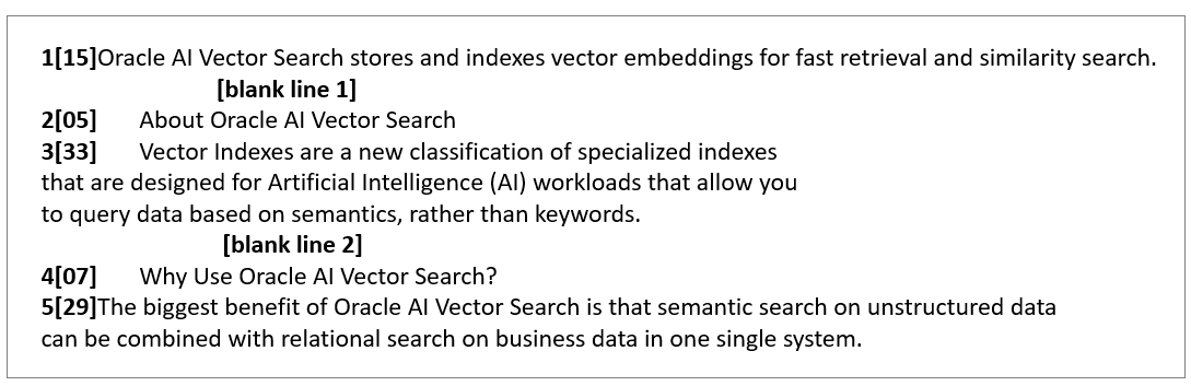

  • The lines are numbered as a reference for the explanations and include the word count in square brackets (for example, 1[15]). The blank lines are also noted.

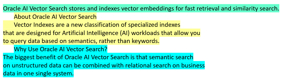

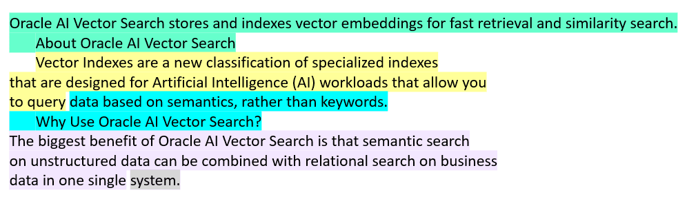

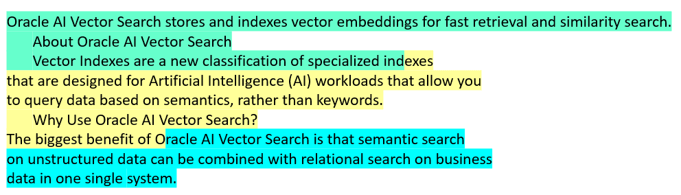

Example 4-2 BY chars MAX 200 OVERLAP 0 SPLIT BY none
This example shows the simplest form of chunking, where you split the text by a fixed number of characters (including the end-of-line characters), at whatever point that occurs in the text.
The text from the first chunk is split at an absolute maximum character of 200, which divides the word indexes between the first two chunks. Similarly, you can see the word Oracle splitting between second and third chunks.
Syntax:
SELECT C.*
FROM documentation_tab D, VECTOR_CHUNKS(D.text BY chars MAX 200 OVERLAP 0
                           SPLIT BY none LANGUAGE american NORMALIZE none) C;
Output:
CHUNK_OFFSET CHUNK_LENGTH CHUNK_TEXT
1	     200          Oracle AI Vector Search stores and indexes vector embeddings for fast retrieval and similarity search.
                          About Oracle AI Vector Search
                          Vector Indexes are a new classification of specialized ind
201	     200          exes that are designed for Artificial Intelligence (AI) workloads that allow you to query data based on semantics, rather than keywords.
                          Why Use Oracle AI Vector Search?
                          The biggest benefit of O
401	     146          racle AI Vector Search is that semantic search on unstructured data can be combined with relational search on business data in one single system.

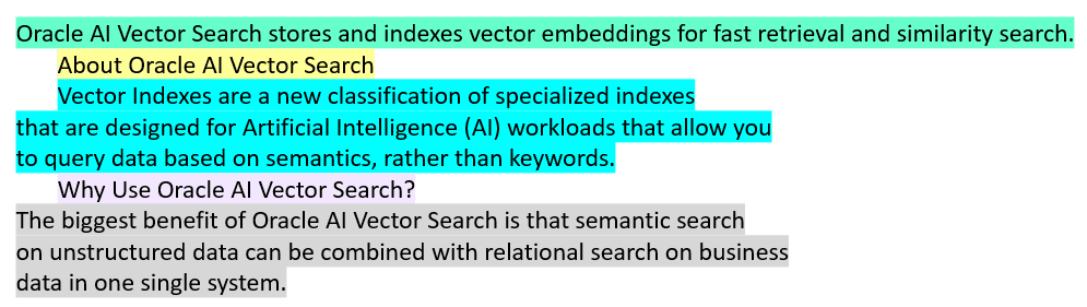

Example 4-3 BY chars MAX 200 OVERLAP 0 SPLIT BY newline
In this example, the text is split into four chunks at new lines, if possible, within the maximum limit of 200 characters.
The text from the first chunk is split after the second line because the third line would exceed the maximum. The third line fits within the maximum perfectly. The fourth and fifth line would also exceed the maximum, so it produces two chunks.
Syntax:
SELECT C.*
                           SPLIT BY newline LANGUAGE american NORMALIZE none) C;
Output:
1	      138         Oracle AI Vector Search stores and indexes vector embeddings for fast retrieval and similarity search.
143	      196         Vector Indexes are a new classification of specialized indexes that are designed for Artificial Intelligence (AI) workloads that allow you to query data based on semantics, rather than keywords.
343	      33          Why Use Oracle AI Vector Search?
377	      170         The biggest benefit of Oracle AI Vector Search is that semantic search on unstructured data can be combined with relational search on business data in one single system.

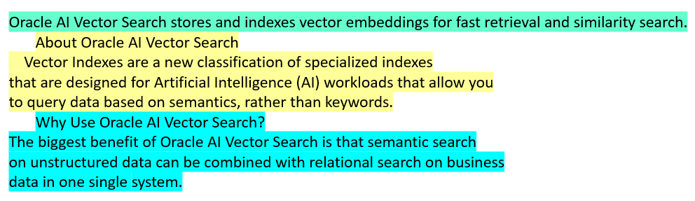

Example 4-4 BY chars MAX 200 OVERLAP 0 SPLIT BY recursively
In this example, the text is split into five chunks recursively using blank lines, newlines and then spaces, if possible, within the maximum of 200 characters.
The first chunk is split after the first blank line because including the text after the second blank line would exceed the maximum. The second passage exceeds the maximum on its own, so it is broken into two chunks at the new lines. Similarly, the third section is also broken into two chunks at the new lines.
Syntax:
SELECT C.*
                           SPLIT BY recursively LANGUAGE american NORMALIZE none) C;
Output:
1            104          Oracle AI Vector Search stores and indexes vector embeddings for fast retrieval and similarity search.
109	     30           About Oracle AI Vector Search

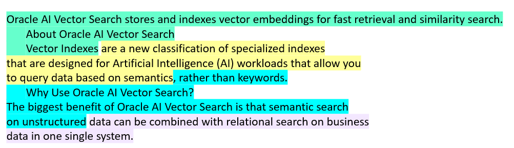

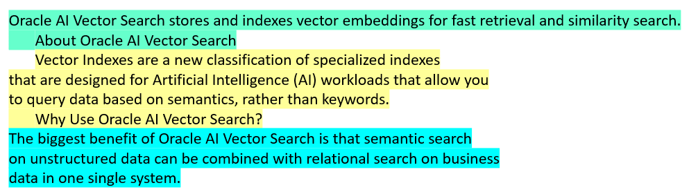

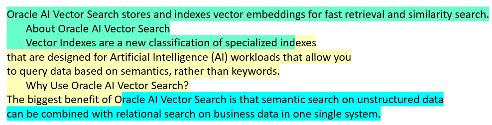

Example 4-5 BY words MAX 40 OVERLAP 0 SPLIT BY none
In this example, the text is split into three chunks at an absolute maximum word of 40, the third line after wordloads and the fifth line after with.
Syntax:
SELECT C.*
FROM documentation_tab D, VECTOR_CHUNKS(D.text BY words MAX 40 OVERLAP 0
Output:
1	     266          Oracle AI Vector Search stores and indexes vector embeddings for fast retrieval and similarity search.
267	     223          that allow you to query data based on semantics, rather than keywords.
490	     57           relational search on business data in one single system.

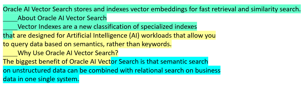

Example 4-6 BY words MAX 40 OVERLAP 0 SPLIT BY newline
In this example, the text is split into chunks at new lines, if possible, within the maximum of 40 words.
The first chunk (of 21 words) is split after the second line, as the third line would exceed the maximum number of words (21+33 words). The third and fourth lines fit within the maximum. The fifth line is 29 words, so fits in the last chunk.
Syntax:
SELECT C.*
Output:
143	     233          Vector Indexes are a new classification of specialized indexes that are designed for Artificial Intelligence (AI) workloads that allow you to query data based on semantics, rather than keywords.

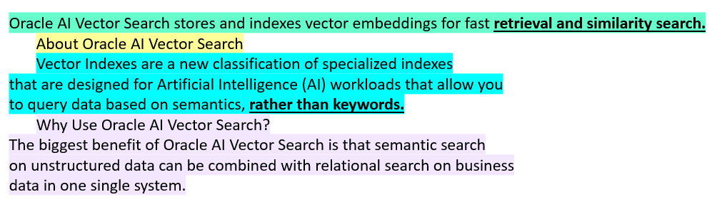

Example 4-8 BY vocabulary MAX 40 OVERLAP 0 SPLIT BY none
In this example, the text is split into four chunks at an absolute maximum vocabulary token of 40, which contrasts with the three chunks produced in Example 4-5. This is because vocabulary tokens include pieces of words, so the chunk text is generally smaller than simple word splitting.
Syntax:
SELECT C.*
FROM documentation_tab D, VECTOR_CHUNKS(D.text BY vocabulary doc_vocab MAX 40 OVERLAP 0
Output:
1	     157          Oracle AI Vector Search stores and indexes vector embeddings for fast retrieval and similarity search.
                          Vector Indexes
158	     156          are a new classification of specialized indexes that are designed for Artificial Intelligence (AI) workloads that allow you to query data based on semantics
314          150          , rather than keywords.
464	     83           data can be combined with relational search on business data in one single system.

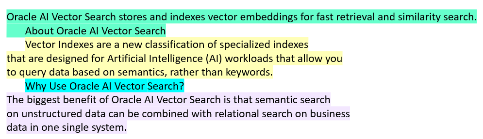

Example 4-9 BY vocabulary MAX 40 OVERLAP 0 SPLIT BY newline
In this example, the text is split into five chunks with newlines, using an absolute maximum vocabulary token of 40, which contrasts with Example 4-6.
Vocabulary tokens include pieces of words, so the chunk text is generally smaller than simple word splitting. This example produces five chunks rather than three in Example 4-6, with the middle passage split into two, and the final word unable to fit into the fourth chunk.
Syntax:
SELECT C.*
Output:
143	     148          Vector Indexes are a new classification of specialized indexes that are designed for Artificial Intelligence (AI) workloads that allow you to query
291	     85           data based on semantics, rather than keywords.
377	     162          The biggest benefit of Oracle AI Vector Search is that semantic search on unstructured data can be combined with relational search on business data in one single
539	     8            system.

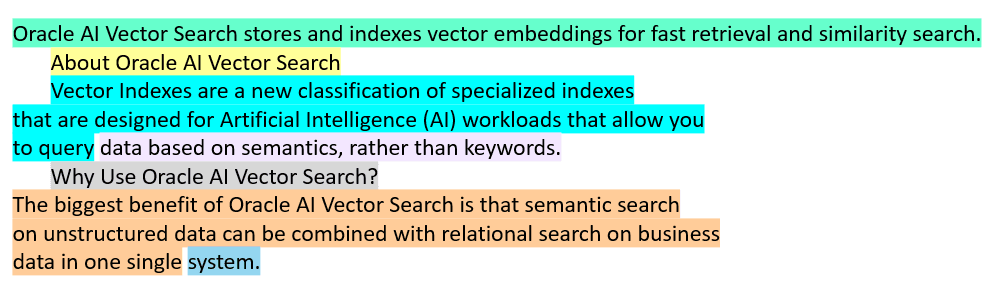

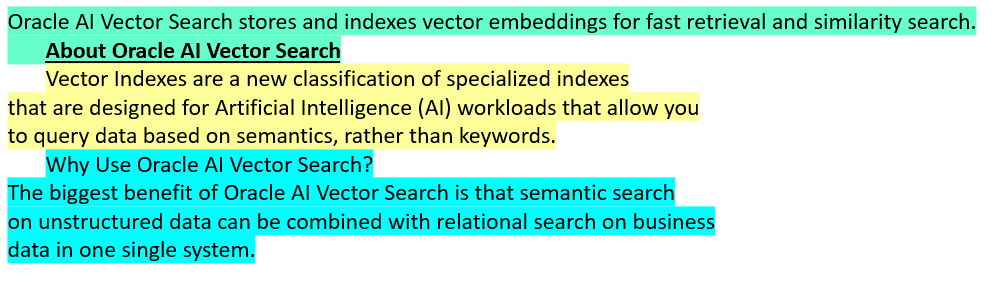

Example 4-10 BY vocabulary MAX 40 OVERLAP 0 SPLIT BY recursively
In this example, the text is split into seven chunks recursively using blank lines, new lines, and spaces and an absolute maximum vocabulary token of 40, which contrasts with the three chunks produced in Example 4-7.
Vocabulary tokens include pieces of words, so the chunk text is generally smaller than simple word splitting. This example produces seven chunks with the middle passage split into three and the final passage split into three.
Syntax:
SELECT C.*
Output:
291	     48           data based on semantics, rather than keywords.
539	     8            system.

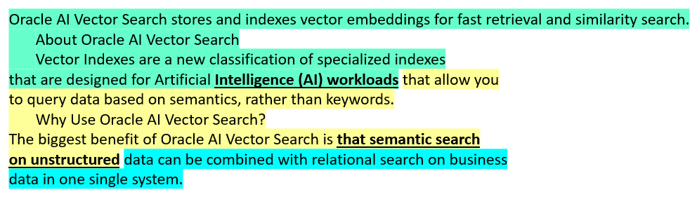

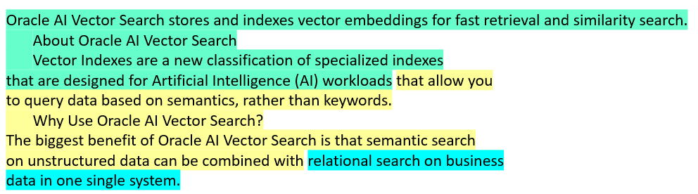

Example 4-11 BY words MAX 40 OVERLAP 5 SPLIT BY none
This example is similar to Example 4-5, except that an overlap of 5 is used here.
The first chunk ends at the maximum 40 words (after workloads). The second chunk overlaps with the last 5 words including parentheses of the first chunk, and ends after unstructured. The overlapping words are underlined below. The third chunk overlaps with the last 5 words, which are also underlined.
Syntax:
SELECT C.*
FROM documentation_tab D, VECTOR_CHUNKS(D.text BY words MAX 40 OVERLAP 5
Output:
239	     225         Intelligence (AI) workloads that allow you to query data based on semantics, rather than keywords.
427	     120         that semantic search on unstructured data can be combined with relational search on business data in one single system.

Syntax:
SELECT C.*
Output:
71           68          retrieval and similarity search.
109	     230         About Oracle AI Vector Search
316          231         rather than keywords.
Example 4-14 BY chars MAX 200 OVERLAP 0 SPLIT BY none NORMALIZE none
This example is the same as the first one (Example 4-2), to contrast with the next example (Example 4-15) with normalization.
Syntax:
SELECT C.*
Output:
Example 4-15 BY chars MAX 200 OVERLAP 0 SPLIT BY none NORMALIZE whitespace
This example enables whitespace normalization, which collapses redundant white space to produce more content within a chunk maximum.
The first chunk extends 8 more characters due to the two indented lines of 4 spaces each (marked with underscores _ below). The second chunk extends 4 more characters due to the one indented line of 4 total spaces. The third chunk has the remaining input.
This example shows that the chunk length (normally in bytes) can differ from the chunk text's size. The CHUNK_OFFSET and CHUNK_LENGTH represent the original source location of the chunk.
Syntax:
SELECT C.*
                           SPLIT BY none LANGUAGE american NORMALIZE whitespace) C;
Output:
1	     208          Oracle AI Vector Search stores and indexes vector embeddings for fast retrieval and similarity search.
209	     205          t are designed for Artificial Intelligence (AI) workloads that allow you to query data based on sema
414          133          or Search is that semantic search on unstructured data can be combined with relational search on business data in one single system.
Example 4-16 BY words MAX 40 OVERLAP 0 SPLIT BY sentence LANGUAGE American
This example uses end-of-sentence splitting which uses language-specific data and heuristics (such as sentence punctuations, contextual rules, or common abbreviations) to determine likely sentence boundaries. Three chunks are produced, each ending at the periods.
You can use this technique to keep your text intact for chunks that contain many split sentences. Otherwise, the text may lose semantic context and may not be useful for queries that target specific information.
Syntax:
SELECT C.*
                           SPLIT BY sentence LANGUAGE american NORMALIZE NONE) C;
Output:
1            102          Oracle AI Vector Search stores and indexes vector embeddings for fast retrieval and similarity search.
109          228          About Oracle AI Vector Search
343	     203          Why Use Oracle AI Vector Search?
