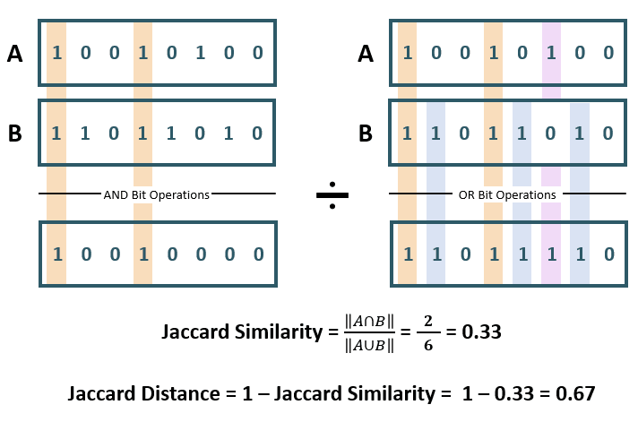

The Jaccard similarity between vectors A and B is the calculation
of the Hamming weight (norm, or the number of '1's in the resulting vector)
of the result of an AND bit operation between A and
B, divided by the Hamming weight of the result of an
OR bit operation between A and B.
As shown in the included diagram of vectors A and B:
- The
ANDbit operation outputs a 1 if the bits in the sequence match a 1, and 0 otherwise. - The
ORbit operation outputs a 1 if at least one of the bits in the sequence matches a 1, and 0 otherwise.
The result of the calculation is from 0 to 1, where results approaching 1 are more similar. A result of 0 means that the two vectors share no non-zero attributes while a result of 1 indicates the two vectors share identical sets of non-zero attributes. In the included diagram, the two vectors share 33% of the significant attributes.
