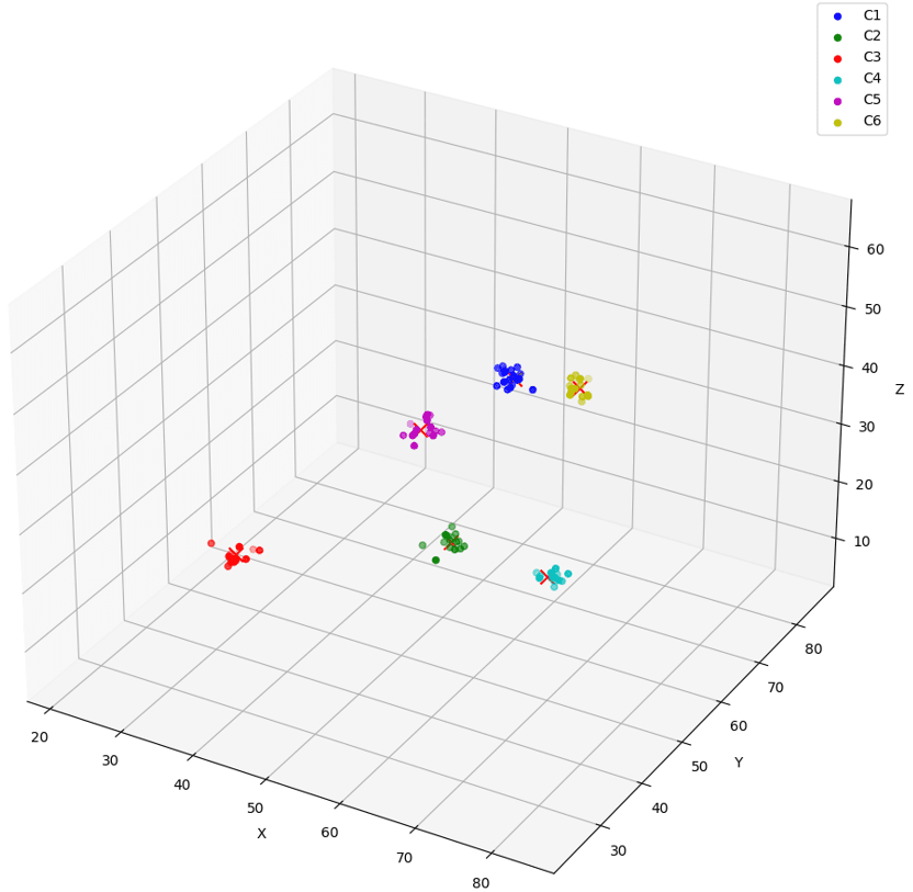

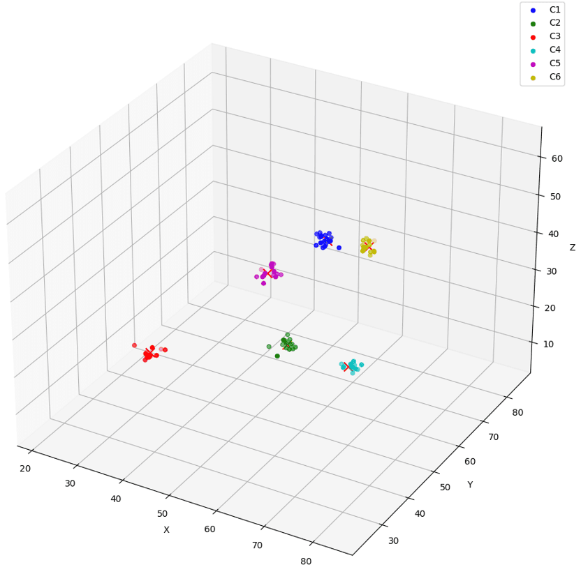

  3. After you have your vector generator set up, you can run this and the following steps to understand how to use it.
    Run the generate_vectors procedure of the vector_gen_pkg package with sample values:
    BEGIN
      vector_gen_pkg.generate_vectors(
        num_vectors => 100,   -- Number of vectors to generate. Must be 1 or above
        dimensions => 3,      -- Number of dimensions of each vector. Must be above 1 but less than 500
        num_clusters => 6,    -- Number of clusters to create. Must be 1 or above
        cluster_spread => 1,  -- Relative closeness of each vector in each cluster (using standard deviation). Must be grather than 0
        min_value => 0,       -- Minimum value for a vector coordinate
        max_value => 100      -- Maximum value for a vector coordinate. Min value must be smaller than max value
    END;
  4. Run a SELECT statement to view the newly generated vectors.
    SELECT name, v FROM genvec;
    Example output:
    NAME    V
    _______ ____________________________________________________
    C1      [6.35792809E+001,5.28954163E+001,5.16500435E+001]
    C2      [5.67991257E+001,5.00640755E+001,2.3642437E+001]
    C3      [2.42510891E+001,5.36970367E+001,6.88145638E+000]
    C4      [8.13146515E+001,2.88190498E+001,4.09245186E+001]
    C5      [6.70646744E+001,2.53395119E+001,6.14522667E+001]
    C6      [5.60192604E+001,8.31662598E+001,2.93592377E+001]
    C1-1    [6.4469986E+001,5.25044632E+001,5.22250557E+001]
    C1-2    [6.31295433E+001,5.21443062E+001,5.02242126E+001]
    C1-3    [6.25154915E+001,5.25730362E+001,5.2617794E+001]
    C1-4    [6.3491375E+001,5.21440697E+001,5.06722069E+001]
    C1-5    [6.21516266E+001,5.32161064E+001,5.23233032E+001]
    C1-6    [6.2913269E+001,5.16970291E+001,5.16683655E+001]
    C1-7    [6.22267456E+001,5.40408363E+001,5.0272541E+001]
    C1-8    [6.1414093E+001,5.28870888E+001,5.27458E+001]

    100 rows selected.
    To visualize the resulting vectors in space, consider the following graph:
    Figure 1: Vector Clusters
    Description of image follows
