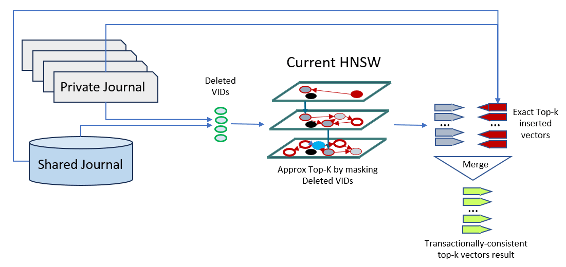

    Following DMLs, read consistency is achieved by taking into account both the existing HNSW graph in memory as well as the query's private journal and shared journal to determine the list of transactionally-consistent set of deleted and inserted vectors. This consists of identifying exact lists of deleted vectors from the journals, running an approximate top-K search through the current version of the HNSW index by augmenting the filter to ignore deleted vectors, running an exact top-k search of newly inserted vectors in the journals, and merging the results of the two searches.
    This is illustrated by the following diagram:

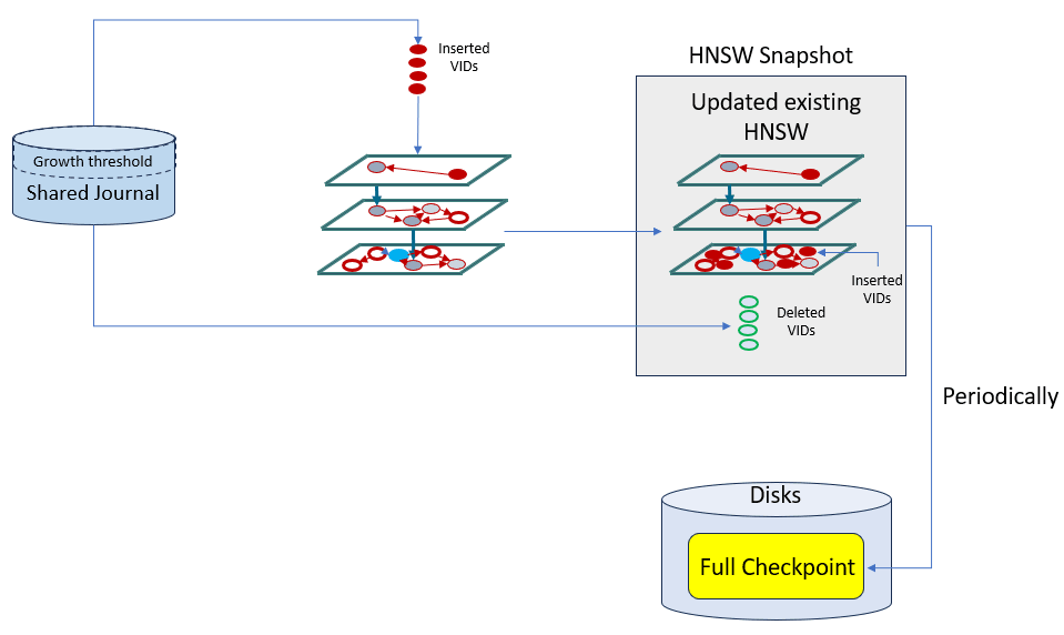

      An incremental snapshot is an incremental updated version of the existing in-memory graph index combined with a list of all deleted vectors so far. This snapshot is linked to a specific commit SCN and helps reduce the size of the shared journal. The system automatically creates a snapshot when the journal becomes too large impacting the performance. When a snapshot is created, new vectors are added to the existing HNSW graph using the same algorithm which is currently used for graph creation. This method carefully picks which other vectors each new vector connects to, based on the parameters defined during the index creation time. Deleted vectors are not actually removed from the graph. Instead, they are tracked using bit vectors and hidden during search. In terms of memory, if you have 10% new inserts, then the vector memory requirement for the incremental snapshot will be approximately 10% more than the original HNSW graph. Bit vectors for deleted vertices are considered negligible in term of memory footprint.

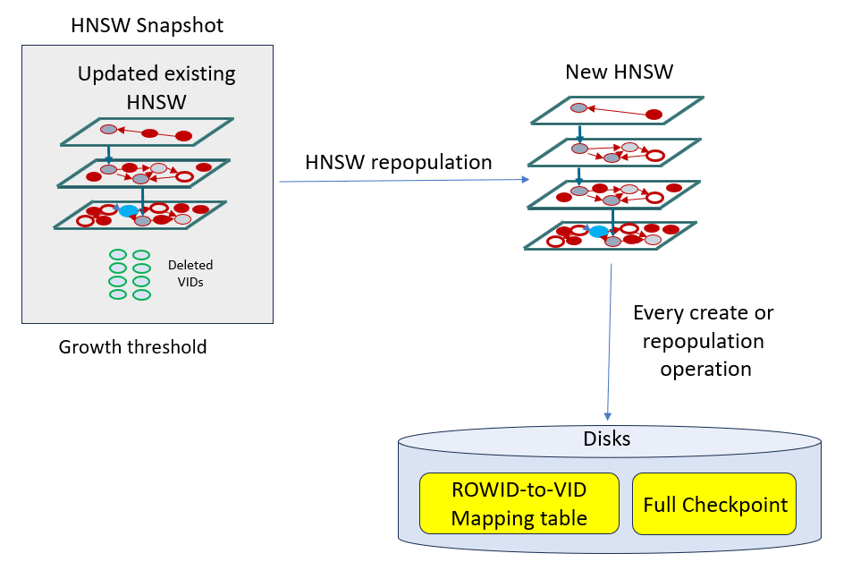

      Unlike incremental snapshots, which updates an existing graph, full repopulation builds a fresh graph while keeping the old one active for ongoing queries. For example, if 10% of the vectors are new, the memory needed for the new graph is about 10% more than the original, resulting in a peak memory usage of 2.1 times, which later drops to 1.1 times after the switch.
    • At the time of full repopulation (until a new HNSW graph becomes available), if a query tries to access an older version of the HNSW graph that no longer exists, then the read consistency error ORA-51815 "INMEMORY NEIGHBOR GRAPH HNSW vector index snapshot is too old." is triggered.
    • You can query the V$VECTOR_GRAPH_INDEX table for the HNSW index which contains information about the newly created graph. It is also possible to use the V$VECTOR_GRAPH_INDEX_CHECKPOINTS and the V$VECTOR_GRAPH_INDEX_SNAPSHOTS views to gather data on the most recent checkpoint and the first snapshot of the new graph.
