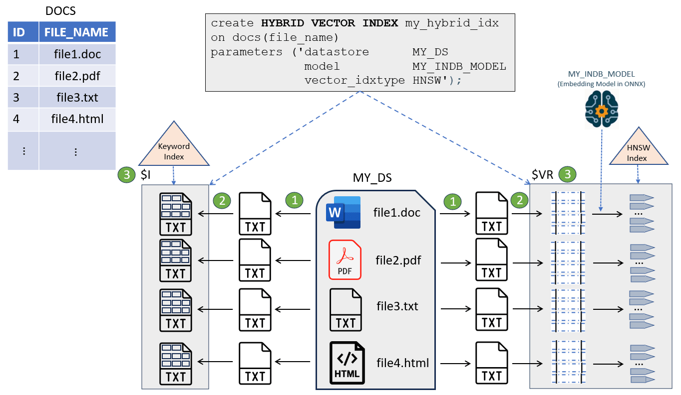

You create a hybrid vector index by simply specifying on which table and column to create it along with some details, such as the local or remote location where all source documents are stored (datastore), the ONNX in-database embedding model to use for generating embeddings, and the type of vector index to create. You can specify additional parameters that are discussed later in this chapter.
As illustrated in the following diagram, the hybrid vector index DDL creates a single index that contains both textual fields (with derived text tokens) and vector fields (with extracted chunks and corresponding embeddings) for each indexed document.
As you can see, the implementation of a hybrid vector index leverages the existing capabilities of the Oracle Text search index and the Oracle AI Vector Search vector index. You can define PL/SQL preferences to customize all these indexing pipeline stages for both the index types.
A document table DOCS contains IDs and corresponding document names or file names stored in a location called MY_DS datastore.
The indexing pipeline starts with reading the documents from MY_DS (datastore), and then passes the documents through a series of processing stages:
Filter (conversion of binary documents such as PDF, Word, or Excel to plain text)
Tokenizer (tokenization of data for keyword search) and Vectorizer (chunking and embedding generation for vector search)
Indexing Engine (creation of secondary tables)
As the system passes documents through this indexing engine, it populates and indexes a set of secondary tables that are collectively part of a hybrid vector index.
The two main secondary tables created are:
$Iis the same structure as the existing Oracle Text index, which contains the inverted indexed data with tokenized terms.An Oracle Text index is created over a textual column based on your specifications. For a deeper understanding of the Oracle Text indexing process, see Oracle Text Application Developer's Guide.
$VRcontains the indexed data with generated chunks and corresponding embeddings.A vector index is also created over the
VECTORcolumn based on your specifications.$VRalso contains aROWIDcolumn that maps back to the document table's row IDs, and aDOCIDcolumn that links back to Oracle Text document-level IDs. This creates a link between chunks, tokens, and documents.You can directly examine the
$VRtable using the dictionary view<index name>$VECTORS, which lets you query all row ids, chunks, and embeddings. See <index name>$VECTORS.
Temporarily, the
$Dsecondary table (not shown in the diagram) is also created to save a copy of the document if the original document is not already in the database or needs filtering. This table gets truncated after chunks are obtained. -
