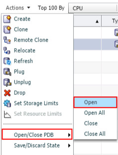

  2. In the Top Containers section of the Containers page, click the PDB that you want to open, and then choose Open/Close PDB > Open from the Actions menu. In this tutorial, you open PDB2.

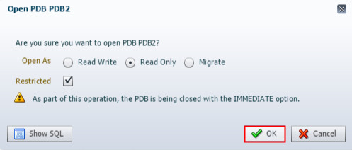

  3. The Open PDB wizard appears and asks you to specify the open mode for the PDB (Read Write, Read Only, or Migrate), and whether you want the PDB opened in restricted mode. In this example, the PDB is opened in Read Only Restricted mode, so that access is allowed only to the PDB administrator. Click OK.
    Description of sample-image-1.png follows
    Description of the illustration a3
    Note: When you choose to open a PDB that is already open, the PDB closes immediately, and then reopens in the open and restricted mode that you specified in the wizard. When a PDB is closed immediately, users currently connected to the PDB are disconnected, and active transactions are implicitly rolled back.

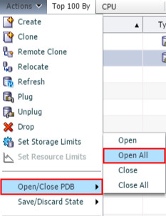

  2. In the Top Containers section of the Containers page, choose Open/Close PDB > Open All from the Actions menu.

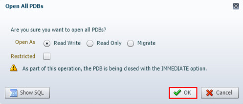

  3. The Open All PDBs wizard appears and asks you to specify the open mode to use for all the PDBs (Read Write, Read Only, or Migrate), and whether you want the PDBs opened in restricted mode. In this example, the PDB is opened in Read Write Unrestricted mode, so that read write access is allowed to all the users. Click OK.
    Description of the illustration b3
