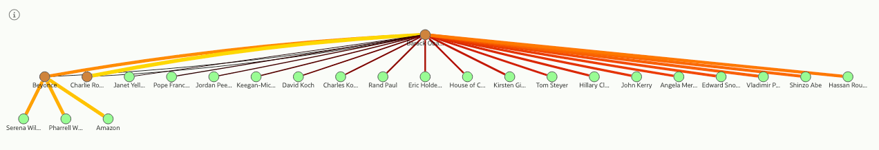

Hierarchical Layout¶
The hierarchical layout organizes the graph using a DAG (directed acyclic graph) system. It is especially suitable for DAGs and trees. It supports the following configurable properties:
ranker: Specifies the type of algorithm used to rank the vertices. Possible values: 'network-simplex', 'tight-tree', 'longest-path'. -
Network Simplex: The network simplex algorithm assigns ranks to each vertex in the input graph and iteratively improves the ranking to reduce the length of edges. Tight Tree: Constructs a spanning tree with tight edges and adjust the ranks of the input vertex to achieve this. A tight edge is one that is has a length that matches itsminlenattribute.-
Longest Path: Vertices are pushed to the lowest layer possible, leaving the bottom ranks wide and leaving edges longer than necessary. -
rankDirection: Alignment of the ranked vertices. Possible values: 'UL' | 'UR' | 'DL' | 'DR' | 'TB' | 'BT' | 'LR' | 'RL' (where UL stands for Up-Left direction) -
vertexSeparation: Sets the horizontal separation between the vertices. -
edgeSeparation: Sets the horizontal separation between the edges. -
rankSeparation: Sets the separation between two ranks(levels) in the graph.
