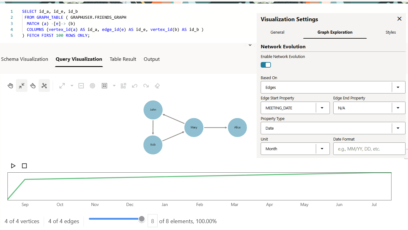

    The chart displaying the evolution of the graph data gets displayed at the bottom of the graph visualization. You can view the graph animation by clicking the Play Network Evolution button. The animation shows the changes in the graph network over time.
    The following figure shows an example for network evolution of graph data using line chart in the graph visualization panel:
    Also, you can activate and deactivate network evolution by clicking the Activate Network Evolution icon which is show highlighted in the preceding figure.
