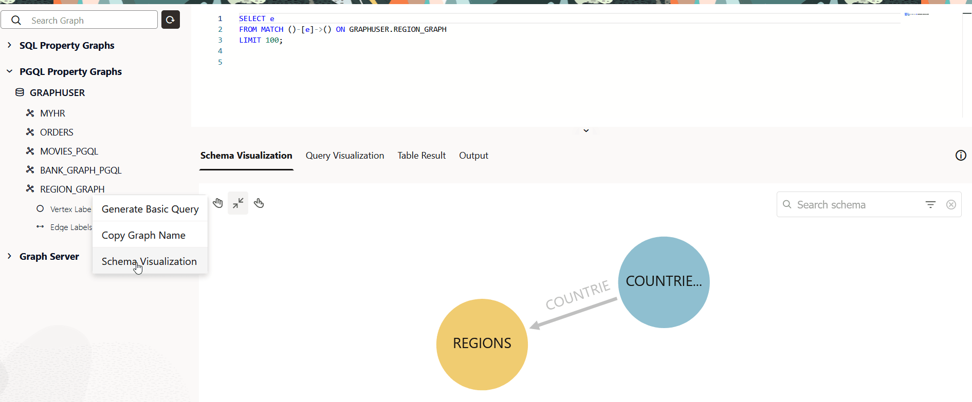

Perform the following steps to visualize the schema of a PGQL property graph in Graph Explorer.
  1. Expand PGQL Property Graphs in the left navigation pane.
  2. Expand the desired schema to view the list of PGQL property graphs to which you have access.
  3. Select PGQL driver in the action panel at the top of the query editor.
  4. Right click on a specific graph and click Schema Visualization in the context menu.
    The schema of the graph is displayed in the Schema Visualization tab as shown:
    If you proceed to run a PGQL graph query, then the schema visualization will be replaced with graph visualization.
