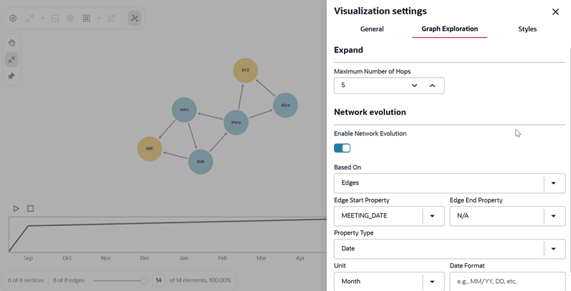

Perform the following steps for configuring network evolution:
  1. Click Settings in the graph visualization panel to open the graph Visualization Settings.
  2. Click the Graph Exploration tab.
  3. Switch on the Enable Network Evolution toggle.
  4. Select a graph element from the Based On drop-down list.
    You can configure the network evolution to be based on vertices, or edges, or both.
    Depending on your selection, you must select one or more of the following properties:
    • Vertex Start Property: Select the name of the property to use for the vertex filtering.
      The time frame for the graph will be after the Vertex Start Property.
    • Vertex End Property: Optionally, select the name of the property to use for the vertex filtering.
      The time frame for the graph will be before the Vertex End Property.
    • Edge Start Property: Select the name of the property to use for the edge filtering.
      The time frame for the graph will be after the Edge Start Property.
    • Edge End Property: Optionally, select the name of the property to use for the edge filtering.
      The time frame for the graph will be before the Edge End Property.
  5. Select the data type from the Property Type drop-down list.
    Supported property type values are Integer and Date.
  6. Optionally, select the Unit of time for the increment and the Date Format if the Property Type is Date.
  7. Optionally, enable Advanced Settings if you want to explore advanced network evolution features and select one or more of the following options:
    • Height: Select a value to specify the height of the network evolution chart.
    • Chart Type: Select the type of the chart to be used to show the network evolution.
    • Granularity: Specify the aggregation granularity for the input unit.
    • Exclude Values: Specify one or more values to be excluded.
    • Playback Step: Specify a value to determine how often does the playback advance in ms.
    • Playback Timeout: Specify a value to determine how many steps are taken per time out during playback.
  8. Close the Settings dialog.
    The chart displaying the evolution of the graph data gets displayed at the bottom of the graph visualization. You can view the graph animation by clicking the Play Network Evolution button. The animation shows the changes in the graph network over time.
