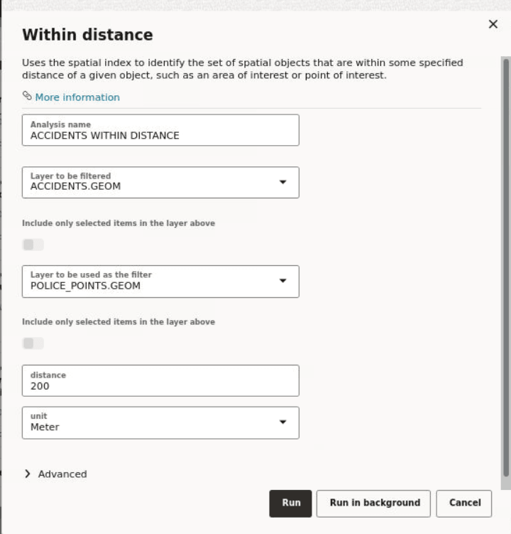

  3. Click on the Filter tab and select Return shapes within a specific distance of another.
    Within distance slider opens as shown:
    Figure 5-2 Spatial Analysis - Within Distance Configuration
    Description of Figure 5-2 follows
    Description of "Figure 5-2 Spatial Analysis - Within Distance Configuration "
  4. Enter Analysis name.
  5. Select the Layer to be filtered.
  6. Select the Layer to be used as the filter.
  7. Enter distance and unit.
  8. Click Run.

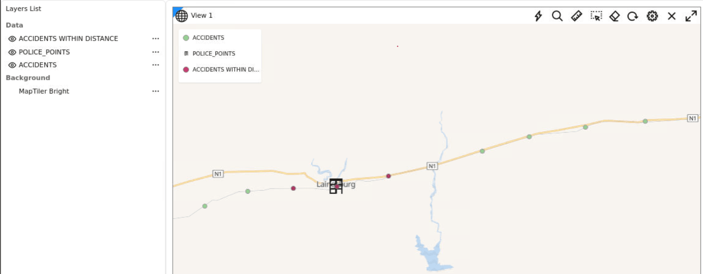

    The Analysis result is listed under Analyses in the Data elements panel on the left pane of the Active Project page.
  9. Drag and drop the analysis result on the map view.
    This creates a new map layer highlighting the filtered coordinates within a specific distance from a point as shown:
    Figure 5-3 Spatial Analysis - Within Distance Visualization
    Description of Figure 5-3 follows
    Description of "Figure 5-3 Spatial Analysis - Within Distance Visualization"
