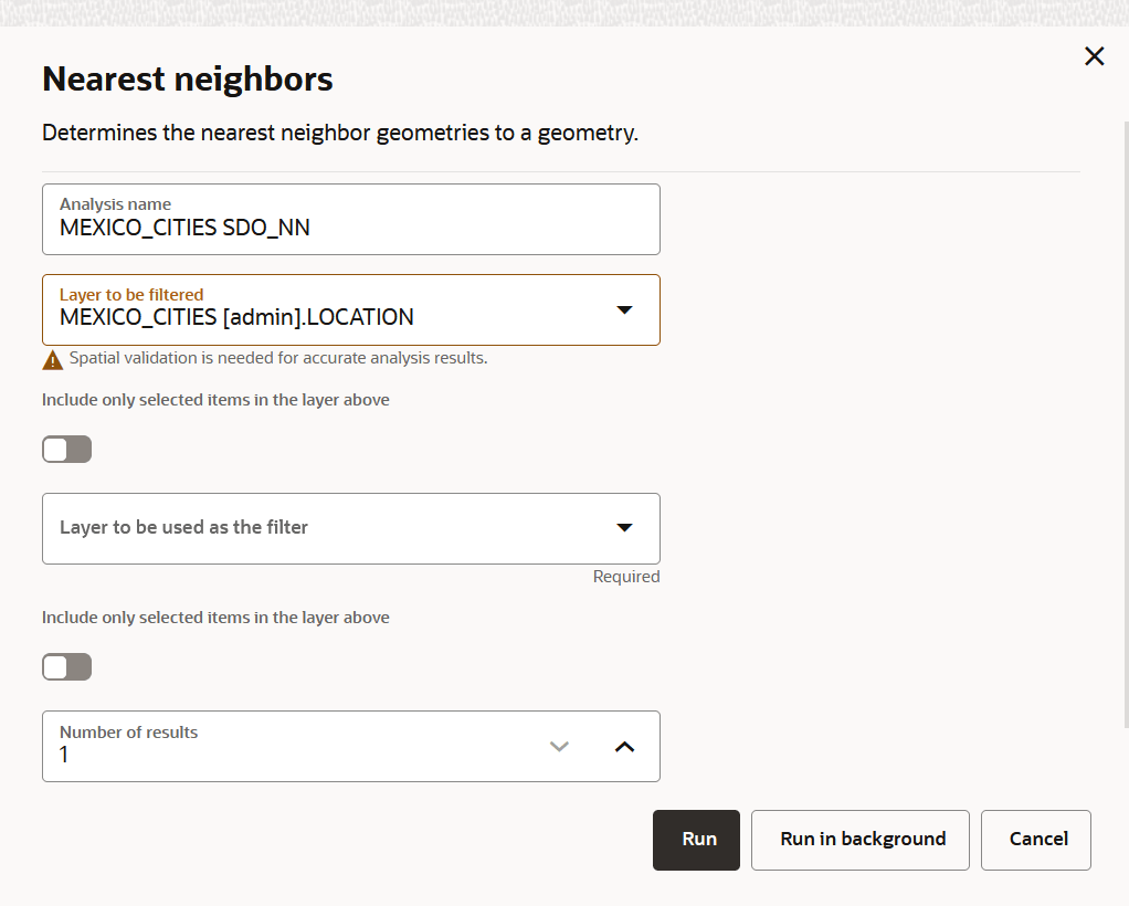

  3. Click on the Filter tab and select Return shapes nearest to another.
    Nearest neighbors slider opens as shown:
    Figure 5-6 Nearest Neighbors Analysis
    Description of Figure 5-6 follows
    Description of "Figure 5-6 Nearest Neighbors Analysis"
  4. Enter Analysis name.
  5. Select the Layer to be filtered.
    Ensure that you have run spatial validations on the map layer to be filtered and the map layer to be used as the filter in order to obtain accurate analysis results.
  6. Enter Number of results.
  7. Click Run.
