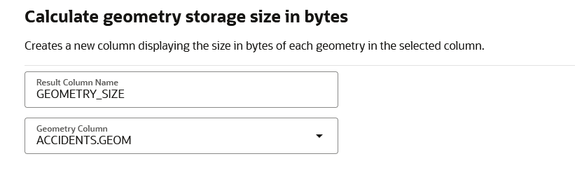

  3. Click on the Measure tab and select Calculate geometry storage size in bytes.
    A slider opens as shown:
    Figure 5-17 Calculating Geometry Size Configuration
  4. Optionally, modify the Result Column Name.
  5. Select the Geometry Column from the drop-down list to compute the geometry size.
  6. Click Run.

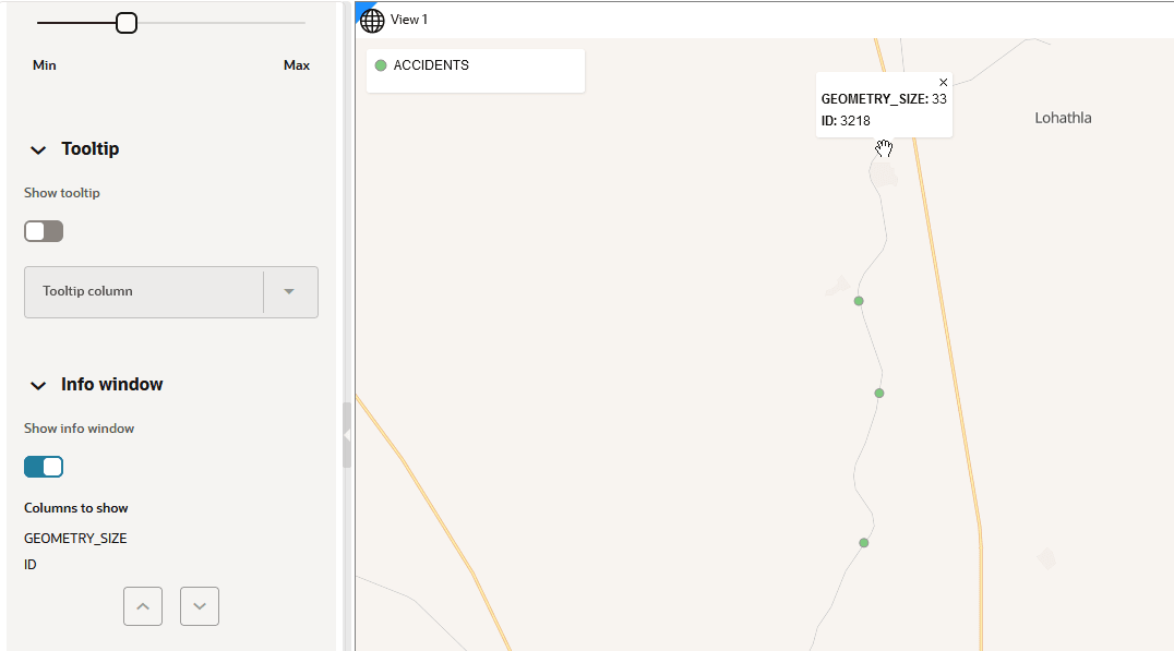

    The Analysis result is added as a new column to the dataset in the Active Project page. You can then interact with the map to view the size value through tool tip or info windows. For example:
