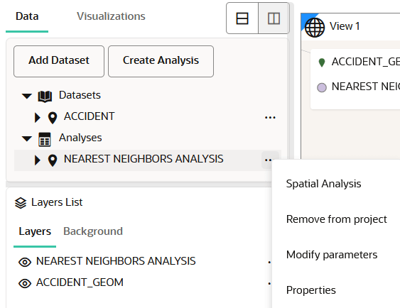

To modify the parameters in a spatial analysis, you must perform the following steps.
The instructions assume that the analysis to be edited is present in the Active Project page.
  1. Click Menu Icon against the analysis to be edited under Analyses tab in the Data elements pane of the Active Project page.
  2. Select Modify Parameters as shown:
    Modify Parameters in the context menu will be disabled for spatial analysis operations that cannot be modified.
    Figure 5-20 Modify Spatial Analysis Parameters
    Description of Figure 5-20 follows
    Description of "Figure 5-20 Modify Spatial Analysis Parameters"
    The slider displaying the original definition for the specific spatial analysis opens.
  3. Modify the required parameters and click Run.
    The analysis gets updated and the updates can be visualized in the map view.
