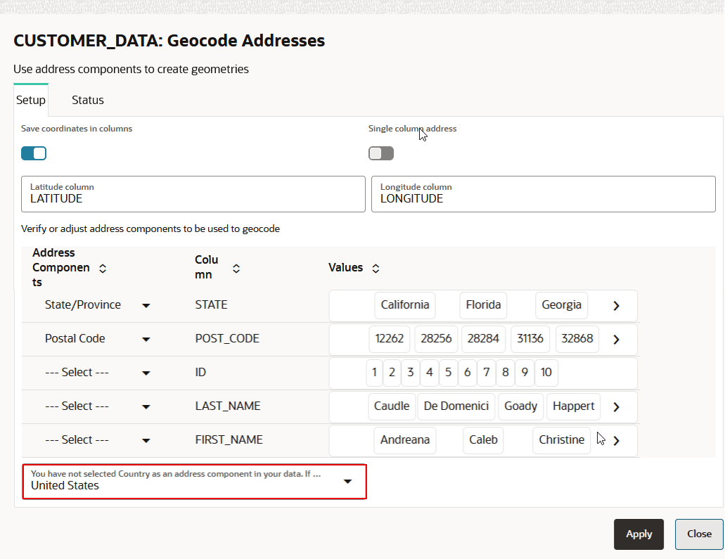

  4. Click the Setup tab.
  5. Perform one of the following depending on whether the address attributes are stored in a single column or multiple columns:
    • Single Column Address
      1. Switch ON the Single column address toggle.
      2. Verify or select the required address Column.
    • Address Stored in Multiple Columns
      1. Select the Address Components for the geo-attributes to be used for geocoding.
        You must provide sufficient geographic data for successful geocoding. If the address components do not include the country or state attributes, then you must explicitly select either the country or the state in the respective drop-down list shown highlighted in the preceding figure.
  6. Optionally, switch ON Save coordinates in columns to save the geocoordinates to the dataset and to the underlying database table.
  7. Optionally, enter Latitude column name and Longitude column name, if you switched ON Save coordinates in columns in the preceding step.
  8. Click Apply.

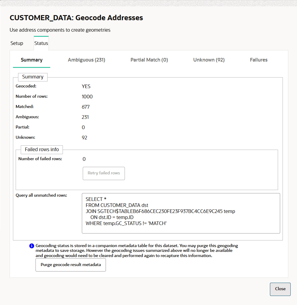

    The geocoding process gets initiated and can be monitored on the Jobs page. Also, note the following:
    • The geocoding process is performed in batches and the default batch size is 50. At any time, you can change the default geocoding batch size under the General settings in the Console page.
    • If any batch fails, the overall geocoding job will not fail. You will be notified on the failed batch at the end of job completion.
    • At the end of the geocoding process, you can view the results in the Status tab as shown:
    • On successful completion of a geocoding job, you can verify that geocoding has been applied by viewing the latitude and longitude columns in the dataset properties and in the input source database table along with the GC_GEOMETRY column of data type SDO_GEOMETRY.
