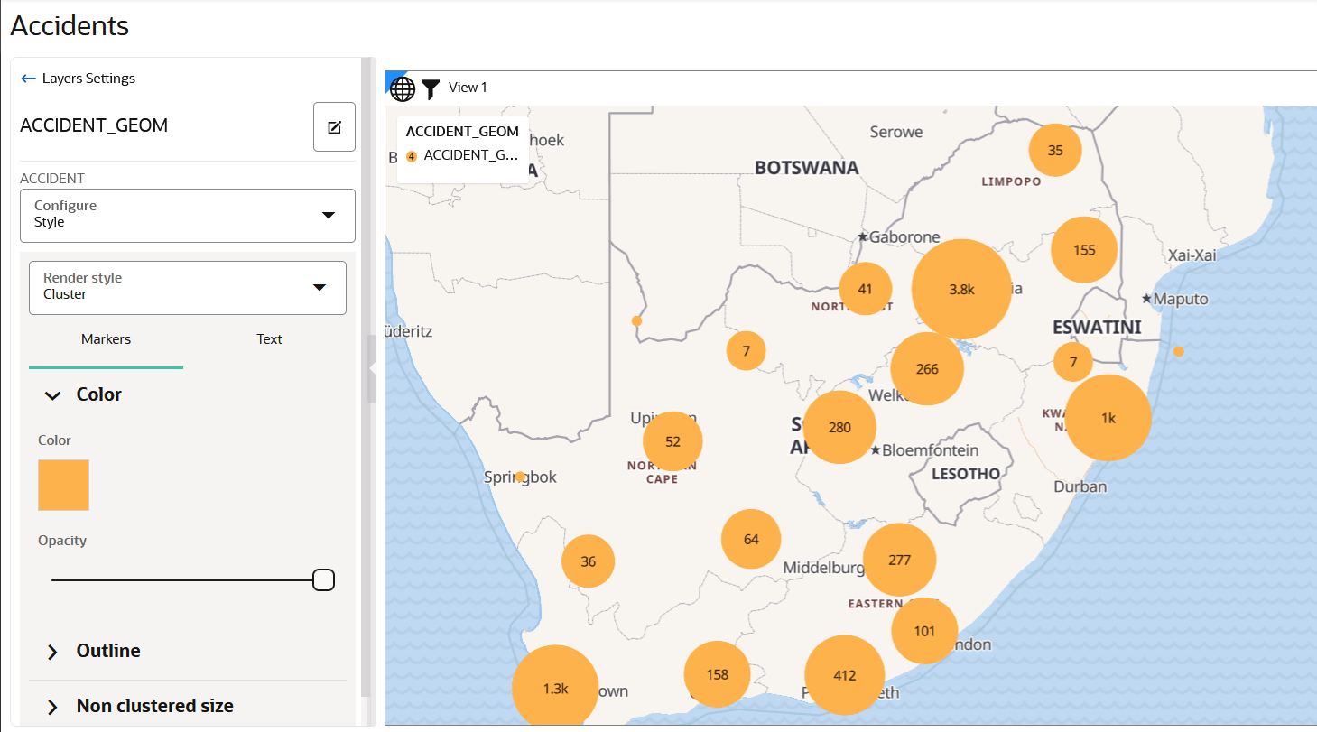

    • If you select Cluster as the render style option, the data points on your map are shown clustered depending on the cluster circle size.
      Figure 4-26 Applying a Cluster Style
      Description of Figure 4-26 follows
      Description of "Figure 4-26 Applying a Cluster Style"
      Optionally, you can change the color and the style of the text labels representing the number of points in each cluster.

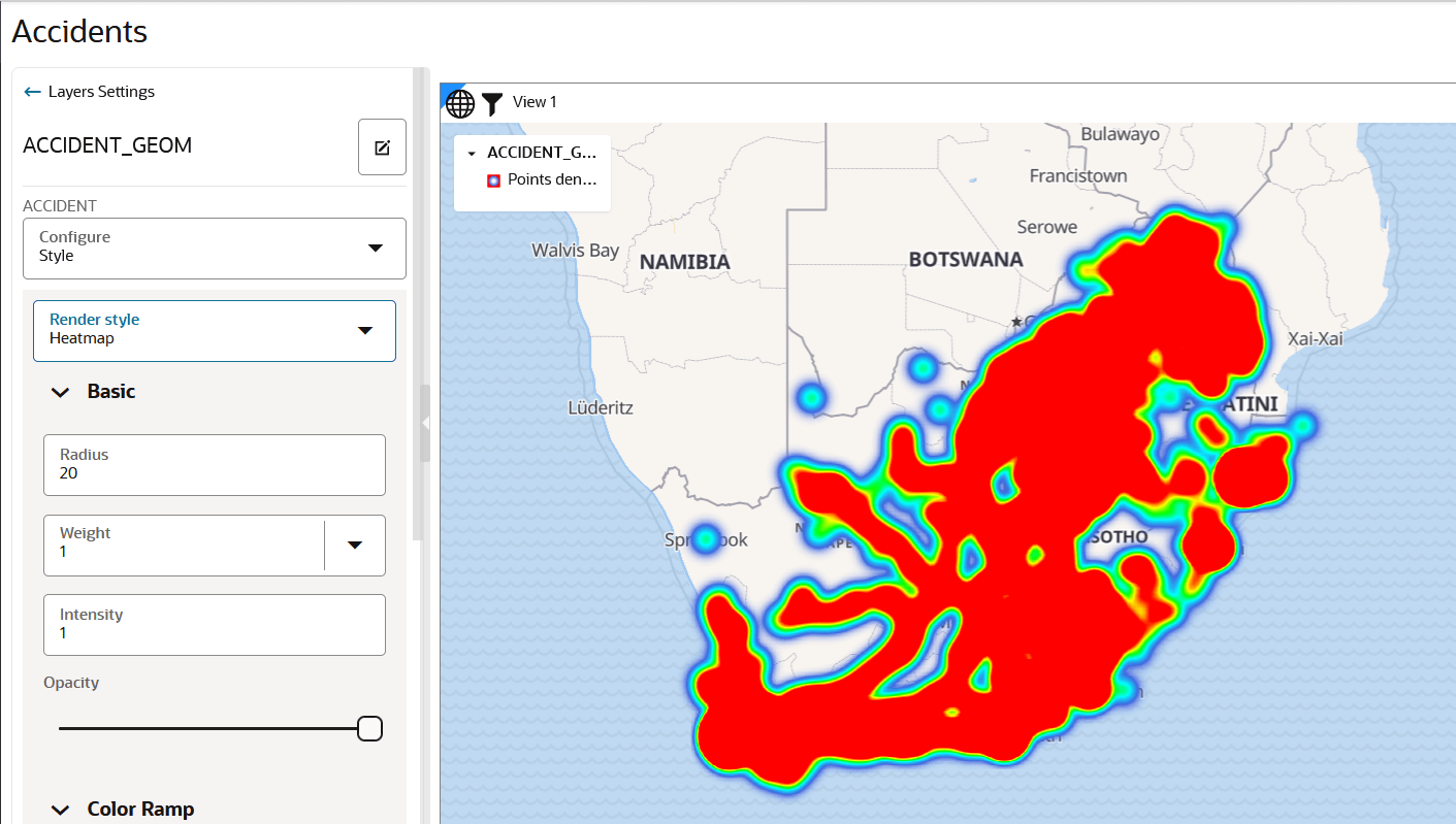

    • If you select Heatmap as the render style option, the data points on your map are rendered with continuous colors based on the concentration of points as shown:
      Hot colors represent concentration of points, and cool colors represent sparsity of points.
      Figure 4-27 Applying a HeatMap Style
      Description of Figure 4-27 follows
      Description of "Figure 4-27 Applying a HeatMap Style"
      Also, you can further customize the Heatmap visualization by changing the Radius or Weight (or both) in the Basic settings panel shown in the preceding figure. The following describes more about these parameters:
      • Radius: This value defines (in pixel) how far each data point contributes to (influences) the heat of its surrounding area. Its contribution drops to zero for any area beyond this radius with the data point at the center.
      • Weight: This value defines how much weight a data point contributes to the heat. The default value is set to 1 which means all data points contribute equally to the heat. If you select a numeric column (with zero or positive values) in the Weight drop down list, then that value determines the weight contributed by a data point to the heat calculation. For instance, if a data point’s weight column has a value of 5, then it is contributing to the heat as if there are five data points at that location (each with the default weight of 1). However, if the weight column contains a negative value, then note that the result is not predictable.
      • Intensity: This value should always be 1.

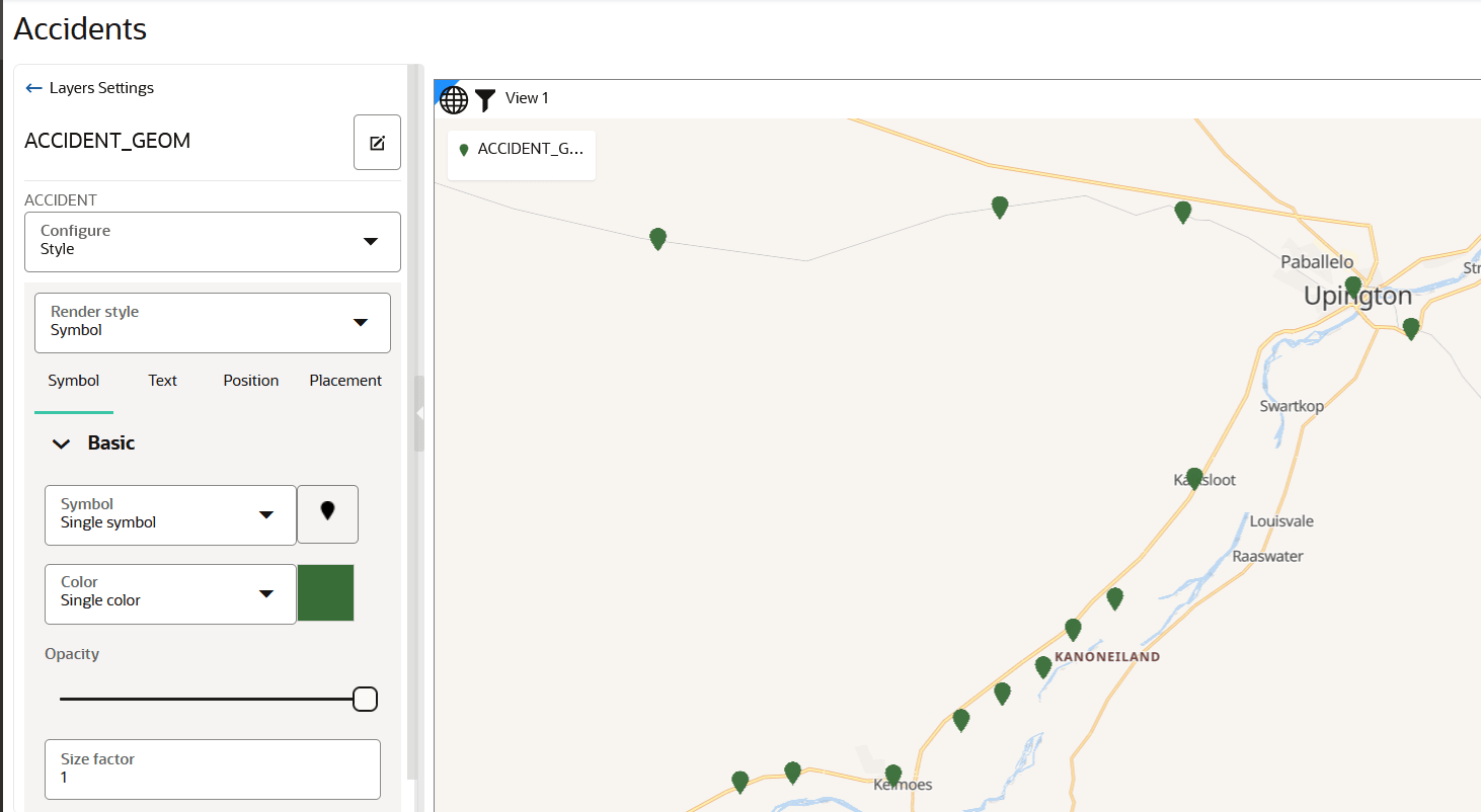

    • If you select Symbol as the render style option, the data points on your map are rendered with your chosen symbol as shown:
      Tip:
      You can optionally select a color for your symbol.

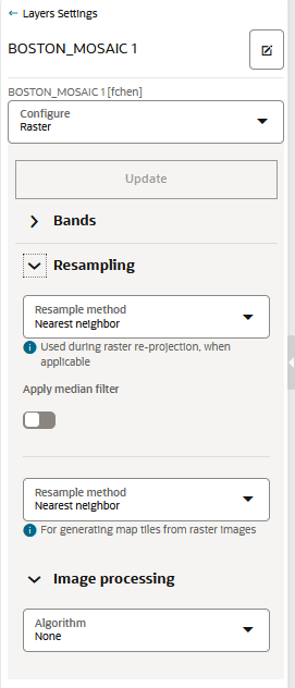

  4. Optionally, modify any of the following rendering options in the Raster tab:
    Figure 4-29 Raster Configuration for GeoRaster Map Layer
    Description of Figure 4-29 follows
    Description of "Figure 4-29 Raster Configuration for GeoRaster Map Layer"
    • Bands: Spatial Studio, by default supports the following bands:
      • Red
      • Blue
      • Green
      • Alpha
      For GeoRaster images that have more than three layers, you can choose which three layers you want to visualize.
    • Resampling: The following two types of resampling processes are supported:
      • Image Reprojection: This represents the interpolation method to be used when transforming an image from one SRS (Spatial Reference System) to another. This applies only if the SRS of the source image in the database table is different from Spatial Studio's base map projection.
      • Map Image Tile Generation: This represents the image interpolation value that determines how each image cell's value on a view port is interpolated using the original image pixels. During an image tile generation, resampling occurs (although the provided images are in the same SRS) as the spatial resolution of the two images may be different.
        The following interpolation algorithm options are supported:
        • NEAREST NEIGHBOR: This option has no interpolation by taking the nearest image pixel's value directly.
        • BI-LINEAR: This option will consider 4 neighboring pixels to determine the image cell's value.
        • CUBIC: This option uses cubic convolution function to estimate image cell's value. Since a 4x4 neighboring pixels participate in the interpolation, it results in a smoother image.
    • Image Processing: represents the subprogram to be used to enhance the visual quality of the images.
      You can choose the Terrain RGB algorithm and enable the Use as terrain toggle to render GeoRaster images with GeoRaster Digital Elevation Model (DEM) data as 3D terrains on the map.
    The GeoRaster map layer is rendered with the updated settings.

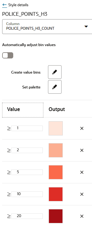

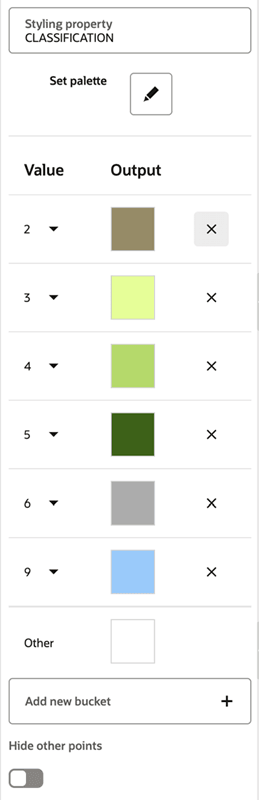

Applying Data-Driven Style to a Map with H3 Aggregations
You can apply different resolutions to your H3 map layer to enhance your visualization.
In case of an H3 aggregation dataset, the hexagonal cells and the distribution of points in these hexagons automatically change at each resolution level, as you zoom in and out of the map. This implies that the color bins for one level might not be the same as for another level.
Spatial Studio provides an option to automatically calculate color bins as you alter your resolutions. You can also turn this option off if you want to test against a set of specific thresholds.
The following steps enable you to apply a data-driven styling option for your H3 map layer.
The instructions assume that you have a H3 map layer displayed on your Active Project page.
  1. Click Menu Icon against the map layer in the Layers tab of the Layers List list.
  2. Select Settings in the context menu.
  3. Configure Style.
  4. Select Based on Data for the Color value under Fill.
    The Style details panel is displayed.
  5. Select the Column to control styling.
  6. Switch on or off the Automatically adjust bin values toggle button.
    • If turned on, the bin values will automatically update as you zoom in or out on the map.
    • If turned off, Create value bins option appears.
  7. Assign colors to the bins based on data values.
    The following figure shows the Style details panel options:
    Figure 4-30 Applying Data-Driven Color Styling for H3 Map Layer
    Description of Figure 4-30 follows
    Description of "Figure 4-30 Applying Data-Driven Color Styling for H3 Map Layer"
    The color bins on the H3 map layer gets rendered appropriately for different resolutions as shown in the preceding figure.

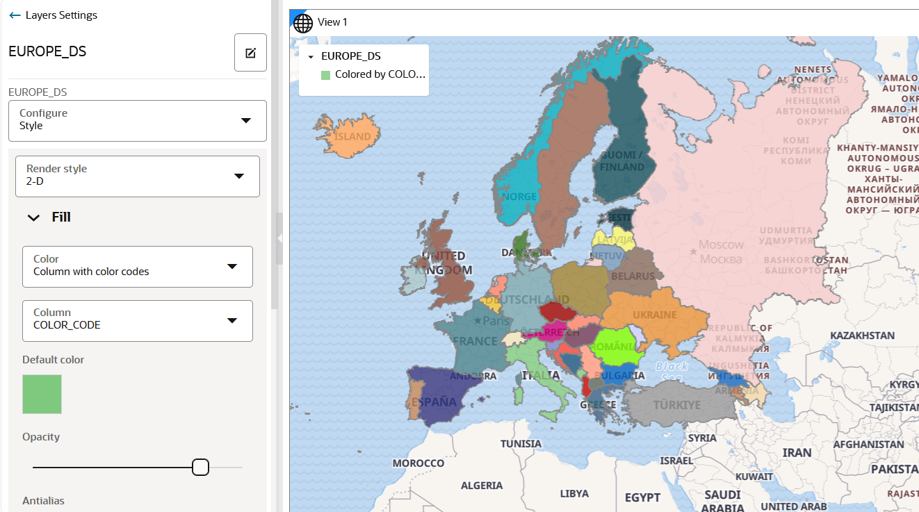

Applying Predefined Colors to a Map Layer
Using a column with predefined color codes or values, you can create accurate and consistent choropleth map layers.
You can store a color-coded value in a column of your dataset and then use this column property to color code your map.
The following steps enable you to color code your map layer.
The instructions assume that the map layer displayed on your Active Project page uses a dataset having a column property that contains color-coded values.
  1. Click Menu Icon against the map layer in the Layers tab of the Layers List.
  3. Configure Style by selecting Column with color codes for the Color value under Fill.
  4. Select the Column that contains the color value.
    The following figure shows the styling of the map layer using the color variable in the dataset:
    Figure 4-31 Color Coding a Map Layer
    Description of Figure 4-31 follows
    Description of "Figure 4-31 Color Coding a Map Layer"
    The color code gets applied to the map layer.

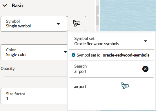

Applying Predefined Symbols to a Map Layer
Using a column with predefined symbol values, you can apply data-driven symbol styling to your map layer.
However, the symbol must belong to one of the supported symbol sets. Symbols in Spatial Studio are grouped into three sets and each set is identified by a Symbol set id as described in the following table:
Table 4-1 Symbol Set
Symbol Set Symbol set id
Spatial Studio default studio
Oracle Redwood symbols oracle-redwood-symbols
Airfields airfields
You can store a symbol name and the symbol set to which it belongs in a column of your dataset and then use this column property to assign symbols to your map.
For example, assume you want to use the airport icon as shown in the following figure:
Figure 4-32 Symbols and Symbol Set
Description of Figure 4-32 follows
Description of "Figure 4-32 Symbols and Symbol Set"
You must then use oracle-redwood-symbols/airport as the symbol name in your dataset column. In this case:
  • oracle-redwood-symbols: is the symbol set id.
  • airport: is the icon name used on the map layer.
    You can search the symbol set to find a specific symbol that you wish to use in the map visualization.

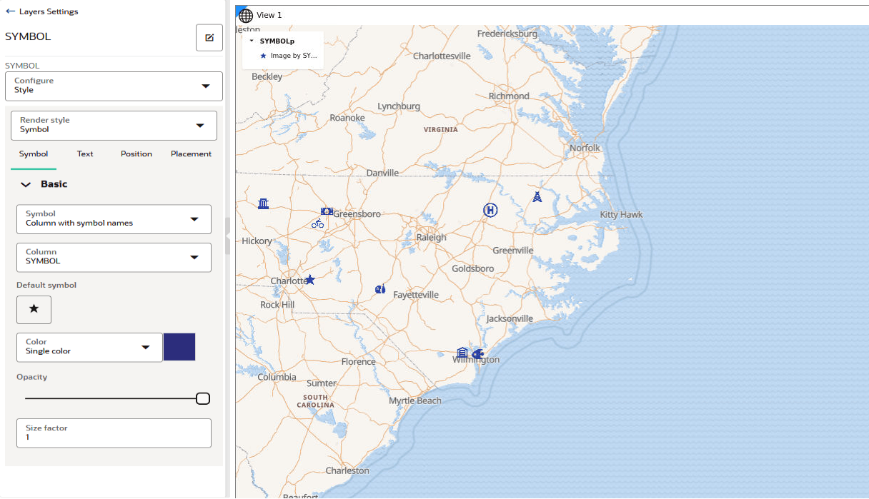

The following steps enable you to apply data driven symbol styling for your map layer.
The instructions assume that the map layer displayed on your Active Project page uses a dataset having a column property that contains symbol names following the convention as explained earlier in this section.
  1. Click Menu Icon against the map layer in the Layers tab of the Layers list.
  3. Configure Style and select Symbol as the Render Style.
  4. Select Column with symbol names from the Symbol drop-down list in the Basic section of the Symbol tab.
  5. Select the Column that contains the symbol name value.
    The following figure shows the styling of the map layer using the symbol name variables in the dataset:
    If incorrect symbol names are present in the dataset column, then for those data points, the Default symbol is displayed on the map layer.
    Figure 4-33 Custom Symbol Styling in Map Visualization
    Description of Figure 4-33 follows
    Description of "Figure 4-33 Custom Symbol Styling in Map Visualization"
    The symbols gets applied to the map layer.

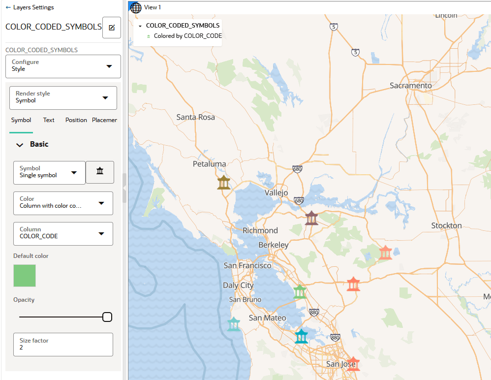

Applying Predefined Colors to Symbols
You can color the symbols on a map layer by using an attribute column of the dataset that contains predefined color codes.
The following steps enable you to color code the symbols on a map layer.
  3. Configure Style by selecting Column with color codes for the Color value in the Basic panel.
    Note that the color values in the column must be in #RGB notation with the # character included.
    The color code gets applied to the symbols on the map layer. The following figure shows the color-coded symbols on the map layer using the color variable in the dataset:

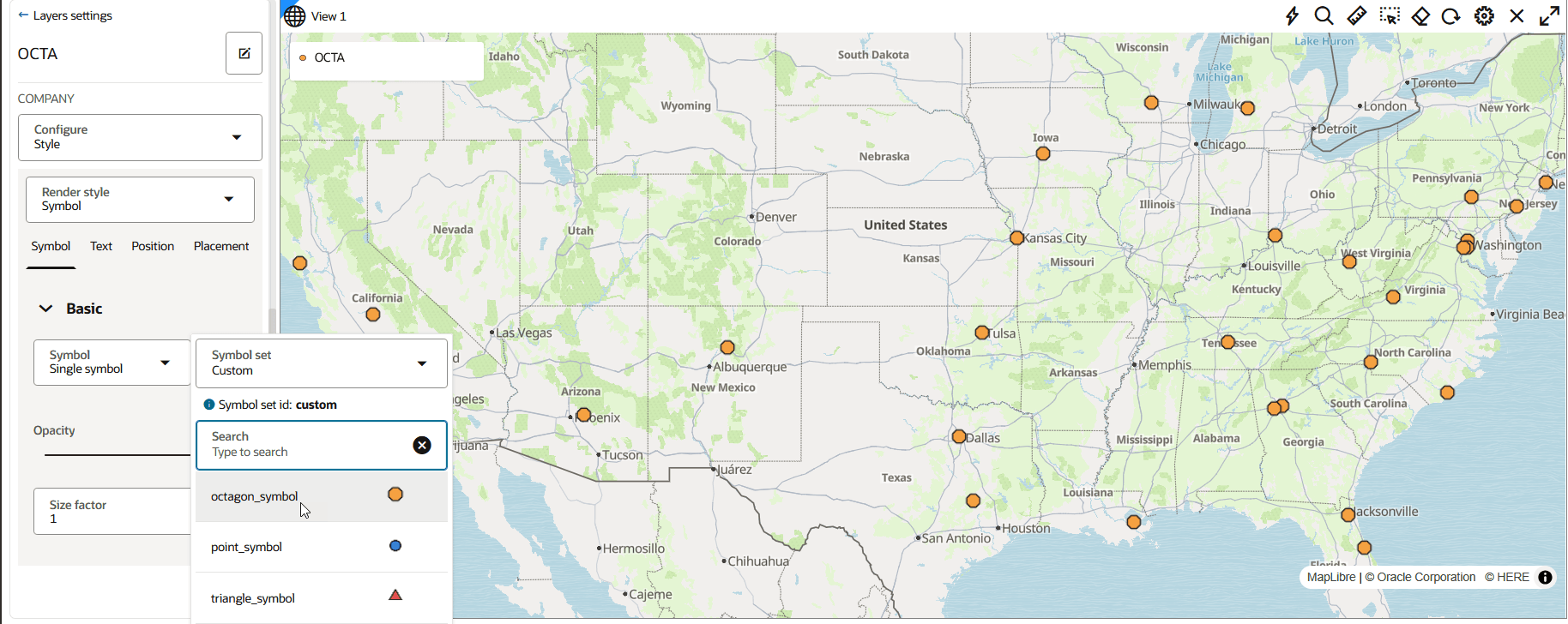

Applying Custom Map Symbols to a Map Layer
You can apply custom map symbols for styling your map layer.
However, note that if a point dataset is being styled by custom symbols, then it can no longer use any of the built-in symbols. Essentially, you cannot mix both custom and built-in symbols on a map layer in the map visualization.
Perform the following steps to style your map layer using custom map symbols.
The instructions assume that a map layer is displayed on the Active Project page and the custom map symbols are already added in Spatial Studio. See Uploading a Map Symbol for more information.
  4. Click the image button next to the Symbol drop-down list.
    The Symbol set drop-down appears.
  5. Select Custom under Custom symbols in the Symbol set drop-down list.
    The uploaded custom symbols list appears.
  6. Select the required custom symbol or use search to find a specific symbol.
    The symbol gets applied to the map layer as shown in the following figure:
    Figure 4-35 Using a Custom Map Symbol in Visualization
    Description of Figure 4-35 follows
    Description of "Figure 4-35 Using a Custom Map Symbol in Visualization"

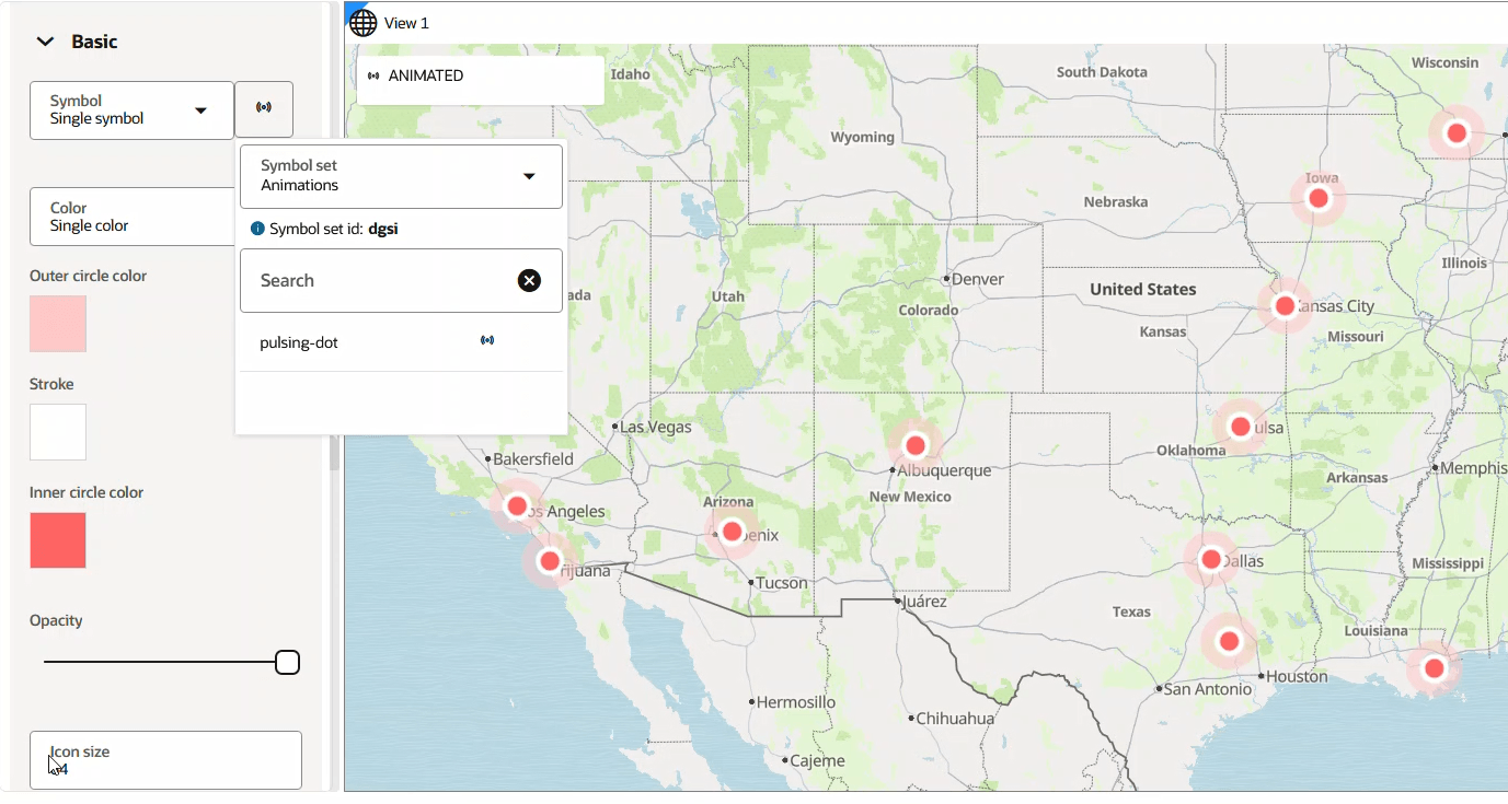

Applying an Animated Map Symbol to a Map Layer
You can apply a circular animating (pulsing) symbol for styling point-type map layers.
Perform the following steps to apply an animating symbol to a map layer.
The instructions assume that a point map layer is already displayed on the map.
The new animating symbol is found in the Symbol render style or symbol picker.
  5. Select the pulsing-dot symbol under the Animations section in the Symbol set drop-down list.
  6. Optionally, customize the animating symbol.
    This includes the overall Icon size, Inner circle color, Outer circle color, Stroke, and Opacity of the inner circle. Also, you can customize the animation speed by configuring the Duration in ms field.
    The following figure shows custom styling of an animated symbol on a map visualization.
    Figure 4-36 Animated Map Symbol

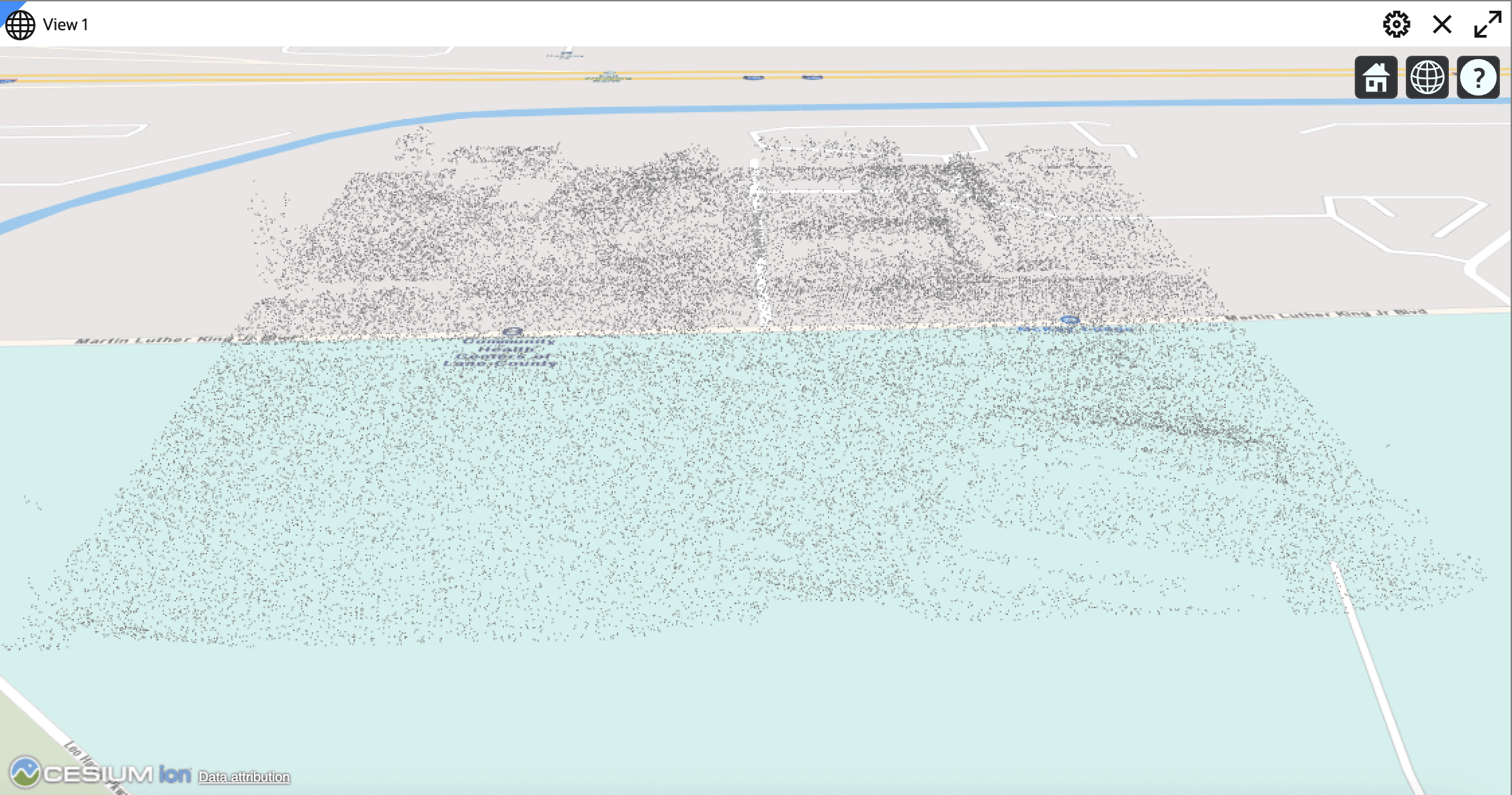

Applying Style to a 3D Tile Layer
Spatial Studio enables you to visualize various features in 3D point cloud tiles using different colors in a 3D scene visualization. You can apply these resolutions to a 3D tile layer using the points styling property as described in the following steps.
The instructions assume that you have a dataset with 3D point cloud tiles added to a 3D scene on your Active Project page.
  1. Click Menu Icon against the 3D tile layer in the Layers tab of the Layers List list.
    The Layers Settings editor opens.
  3. Select Property Driven from the Style type drop-down.
    Note that the Default value is for displaying the dataset as it is without applying any resolution to the points in the 3D tiles.
  4. Enter the Styling property name.
    This name refers to the property of the point that contains an integer value, which can be used for styling the tile layer. Spatial Studio assumes that the underlying 3D tiles dataset includes a property column called CLASSIFICATION, which is used for styling by default. However, you can override this default and specify a different property name based on your dataset. Note that the styling property name is case sensitive.
  5. Assign colors to the bins based on data values.
    For example:
    Figure 4-37 Applying Data-Driven Color Styling to 3D Tile Layer
    The Other option allows you to assign a generic color for all the features outside the assigned data values. Alternatively, you can switch Hide other points ON to hide all the features that are outside the color bins.
  6. Optionally, adjust the Level of detail slider.
    This slider is to increase or decrease the depth of data displayed in the viewport. However, if the dataset does not contain more detailed data than that is currently viewed, then using this slider will have no effect in the map visualization.
  7. Enter the Point size as required.
  8. Configure the following Attenuation parameters to enhance the visual clarity of the points as required.
    • Enable Attenuation: Toggles dynamic size scaling based on geometric error.
    • maximumAttenuation: Sets the upper limit for point size.
    • geometricErrorScale: Controls how strongly point size responds to geometric error (that is, higher values increase sensitivity).
  9. Optionally, configure the following Eye Dome Lighting parameters to enhance the depth perception of the points.
    Note that configuring the Enable Eye Dome Lighting and eyeDomeLightingStrength parameters are effective only if Enable Attenuation is turned ON in the previous step.
    The following figure shows an example of data-driven color styling applied to a 3D point cloud tiles visualization.
    Figure 4-38 Data-Driven Color Styling in 3D Point Cloud Tiles Visualization

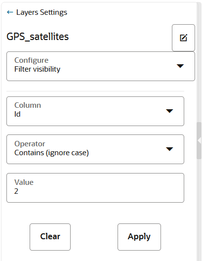

When using a CZML dataset in a 3D scene visualization, you can filter on a specific entity value or control the visibility (show or hide) for the displayed entities. Also, you can add an info window to enhance your map interaction.
The instructions assume that you have added a CZML dataset to a 3D scene visualization on your Active Project page.
  1. Click Menu Icon against the CZML map layer in the Layers tab of the Layers List list.
  3. Configure Interaction to set an Info window.
  4. Configure Filter Visibility and set the filter value for the required column name.
    Figure 4-39 Applying Filters for CZML Map layer
    Description of Figure 4-39 follows
    Description of "Figure 4-39 Applying Filters for CZML Map layer"
  5. Configure Toggle Visibility to show or hide the required entities on the map.

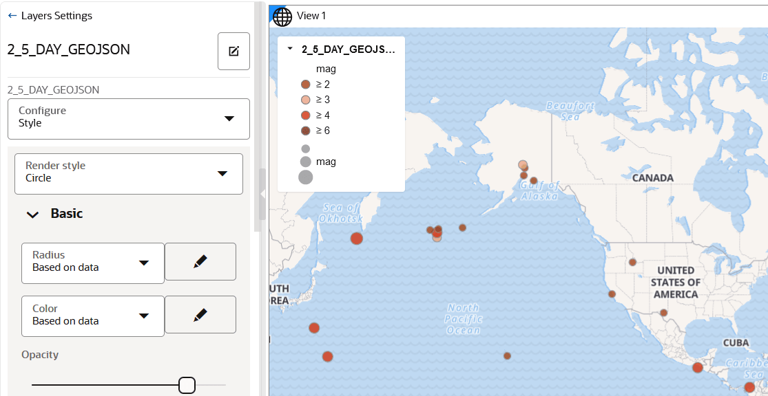

Applying Style to a Map Layer Using a GeoJSON URL Dataset
Spatial Studio supports data-driven styling for your GeoJSON URL dataset map layer. You can access the dataset columns that are sourced from the source URL and apply the desired styling for the map layer.
The instructions assume that you have added a GeoJSON URL dataset on your Active Project page.
  3. Configure Style.
  4. Apply the radius or color styling based on data columns.
    • Styling based on data
      1. Select Based on Data in the Radius or Color drop down list.
      2. Click the Edit bind icon.
      3. Select the Column to control styling.
      4. Optionally, adjust the bin and the output values.
    • Applying predefined colors
      1. Select Column with color codes in the Color drop down list.
      2. Select the Column.
    The following figure shows the radius and color styling applied to a GeoJSON URL dataset map layer:
    Figure 4-40 Data-Driven Styling for GeoJSON URL Map Layer

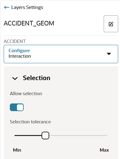

Setting Selection Tolerance on a Map Layer
Spatial Studio allows you to increase or decrease the selection tolerance on a map layer, so that selecting small and linear geometry features is easier.
The following steps enable you to adjust and set the selection tolerance on a map.
The instructions assume that a project is open on the Active Project page.
  1. Click Menu Icon against the dataset in the Data tab of the Layers list.
  2. Select Settings in the context menu and configure Interaction.
  3. Switch on the Allow selection toggle button.
  4. Adjust the Selection tolerance slider as required.
    The following figure shows the Selection section for setting the tolerance:
    Figure 4-41 Setting the Selection Tolerance
    Description of Figure 4-41 follows
    Description of "Figure 4-41 Setting the Selection Tolerance"
    The custom selection tolerance gets applied to the map layer.

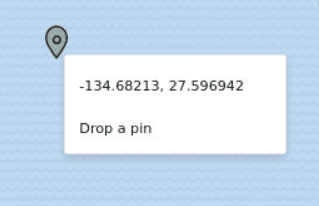

Adding a Pin on a Map
The following steps enable you to inspect the current mouse pointer's latitude and longitude coordinates and pin a location on the map layer.
The instructions assume that you have a project opened on your Active Project page and the map layer is displayed for visualization.
  1. Right-click on any area on the map layer.
    The coordinates for the location gets displayed as shown:
    Figure 4-42 Pin a Location on the Map
    Description of Figure 4-42 follows
    Description of "Figure 4-42 Pin a Location on the Map"
  2. Click Drop a pin to add a location marker.
    The pin gets displayed on the map. Additionally, you can also copy the coordinates by clicking on the marker and then clicking the Longitude, Latitude: click to copy icon.

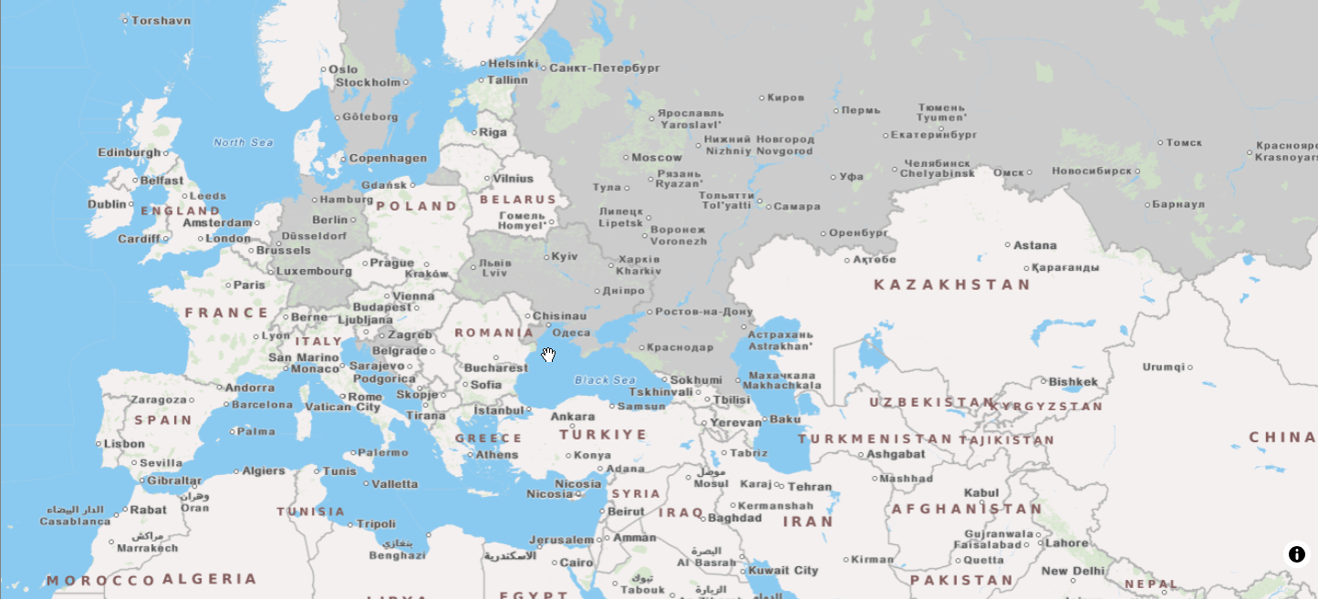

The labels on the the basemap are displayed in English along with the local language of the region. However, you can change the language for the basemap labels. See Configuring a Map Visualization for more information.
Figure 4-43 Basemap Displaying English and Local Language Labels

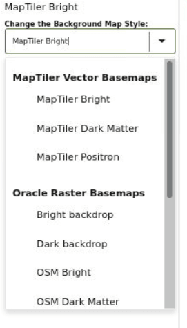

Changing Map Backgrounds
The following steps enable you to apply different map backgrounds in your project visualization.
The instructions assume that you have a project opened on your Active Project page.
  1. Click Menu Icon in the Background tab of the Layers list.
  3. Click the Change the Background Map Style drop-down and select your required background map as shown.
    Figure 4-44 Changing a Map Background
    Description of Figure 4-44 follows
    Description of "Figure 4-44 Changing a Map Background"
    All custom basemaps appear under User-defined Basemaps in the drop-down list.
    The selected map background gets applied to your project visualization.

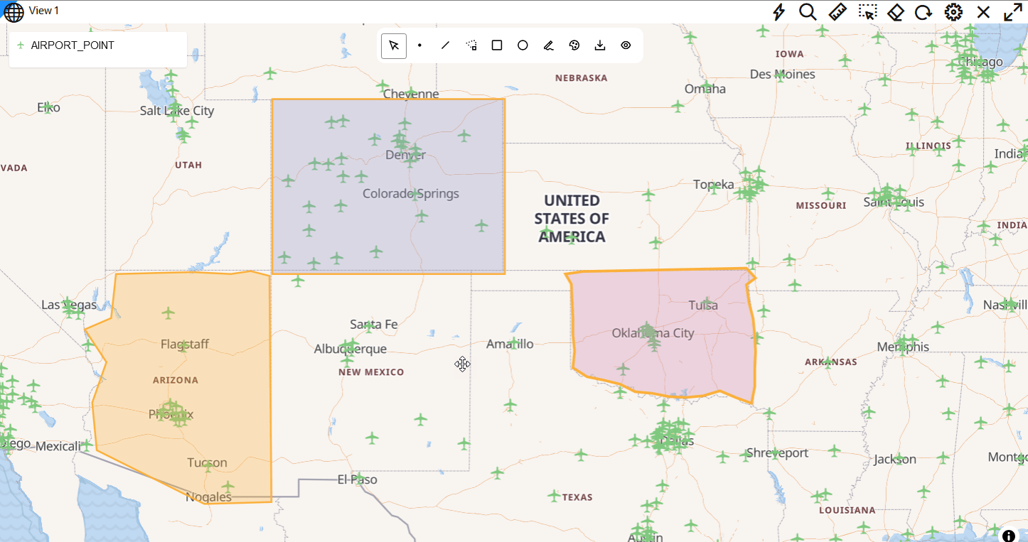

Using the Redline Map Tool
Spatial Studio provides the Redline map tool for drawing and annotating different geometry shapes on your map.
In addition, you can edit, delete, or share these redline drawing sets by exporting it to a GeoJSON file.
Perform the following steps to get started with the Redline map tool. The instructions assume that you have a project opened on your Active Project page and the map layer is displayed for visualization.
  1. Click the Actions icon on the map tool bar and select Redline.
    Alternatively, right-click on the map layer and select Show redline toolbar.
    The Redline map tool bar appears as shown:
    The tool bar provides the following options for defining or managing Redline objects on the map:
    • Select Feature (default): To select a Redline object for update or delete.
    • Draw Point: To define a Redline point.
    • Draw Line: To define a Redline line.
    • Draw Polygon: To define a Redline polygon.
    • Draw Rectangle: To define a Redline rectangle.
    • Draw Circle: To define a Redline circle.
    • Draw Freehand: To draw a Redline freehand.
    • Click to choose a color: To choose the default color for the Redline objects.
    • Export Features: To export the Redline objects to a GeoJSON file. You can later upload the file to create a Dataset which can be used in Map Visualizations. See Creating a Dataset by Uploading a File to upload a GeoJSON file.
    • Toggle Visibility: To hide or unhide the marked Redline objects.
  2. Click the desired drawing option and draw the corresponding shape on the map.
    For example, the following figure shows three Redline objects added to a map layer:
    Figure 4-46 Redlining Areas in Map Visualization
    Description of Figure 4-46 follows
    Description of "Figure 4-46 Redlining Areas in Map Visualization"
    Repeat this step to add as many Redline objects as required.
