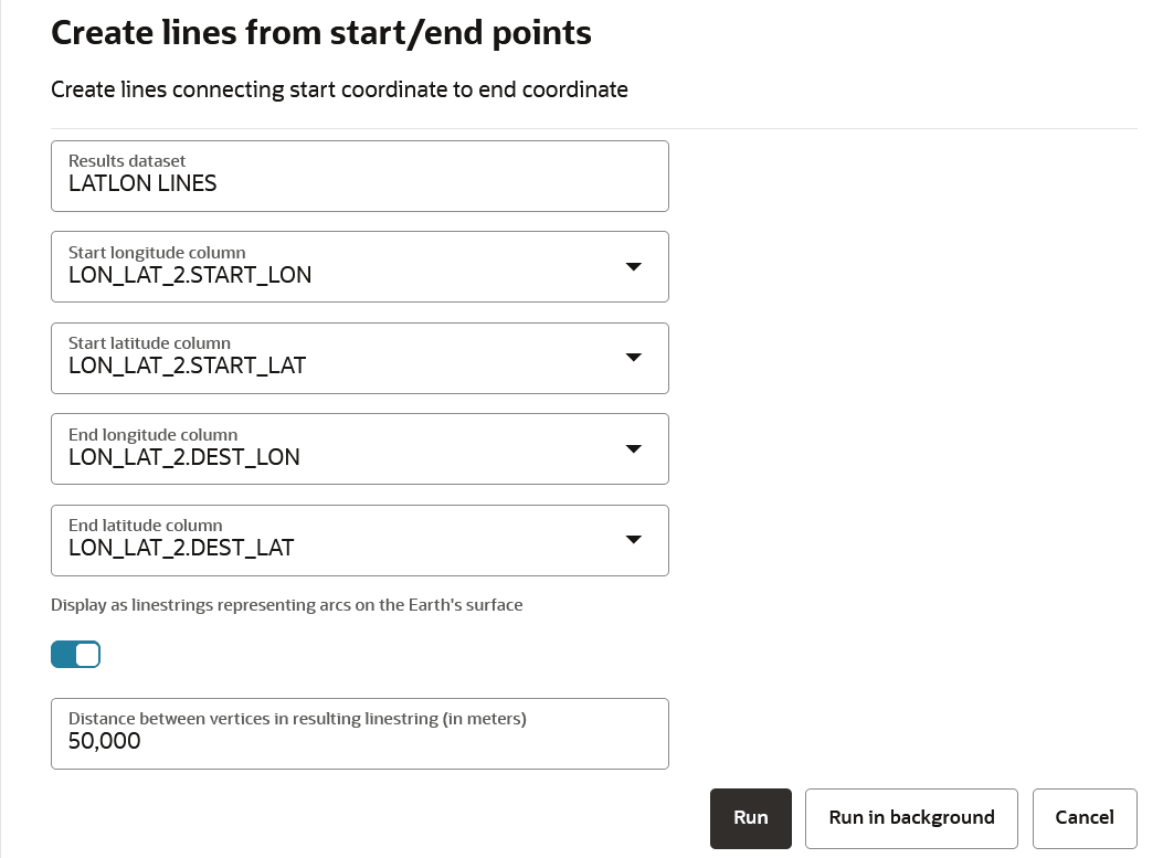

  4. Optionally, modify the resulting datasets name in Results dataset.
  5. Select the Start longitude column.
  6. Select the Start latitude column.
  7. Select the End longitude column.
  8. Select the End latitude column.
  9. Optionally, switch ON the Display as linestrings representing arcs on the Earth's surface toggle.
    This factor takes into consideration that the earth is spherical and accordingly projects the connecting line between the two sets of coordinates on the map layer. It is very useful for large distances between two coordinates and it is recommended that you use this option.
  10. Optionally, modify the Distance between vertices in resulting linestring (in meters) (only if you have included the Display as linestrings representing arcs on the Earth's surface option in the preceding step).
  11. Click Run.

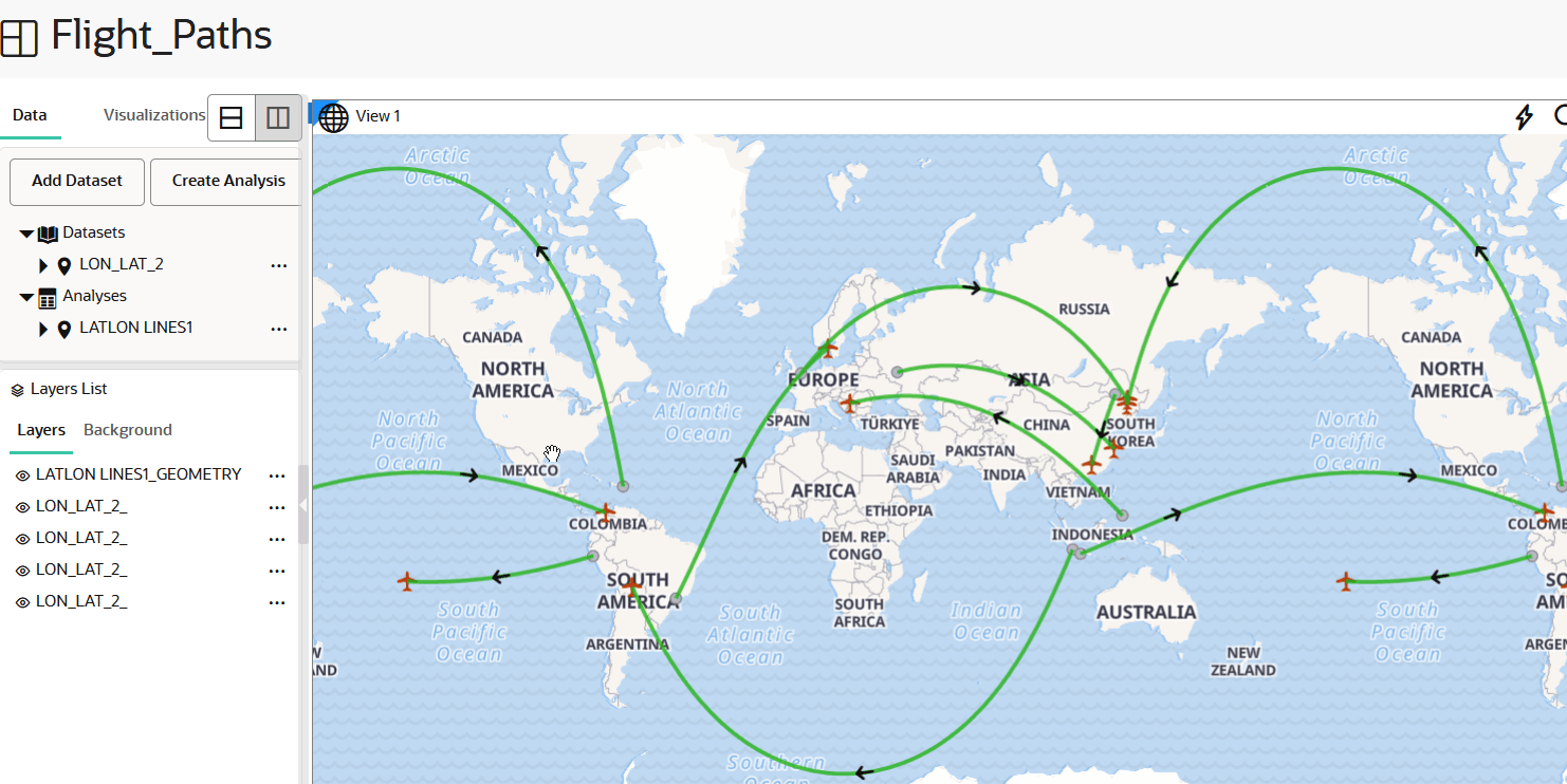

    The Analysis results are listed under Analyses in the Data elements panel on the left pane of the Active Project page.
  12. Drag and drop the following layers on the map - starting points, ending points, and finally the GEOMETRY (that connects the starting and ending points) analysis on the map view.
    The following figure shows an example of the Create lines from start/end points spatial analysis:
    Figure 5-10 Visualizing Latitude/Longitude Line Analysis
