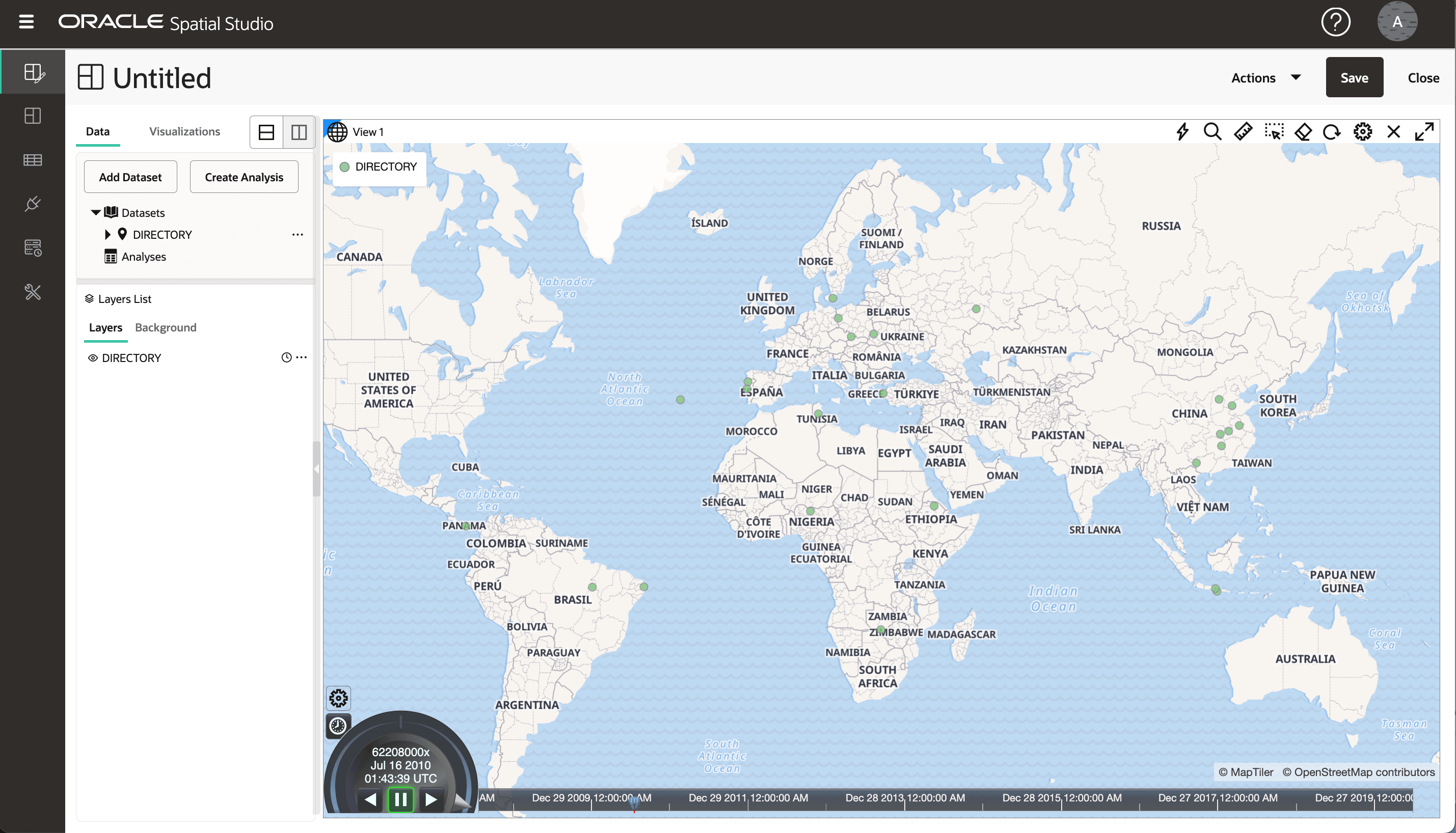

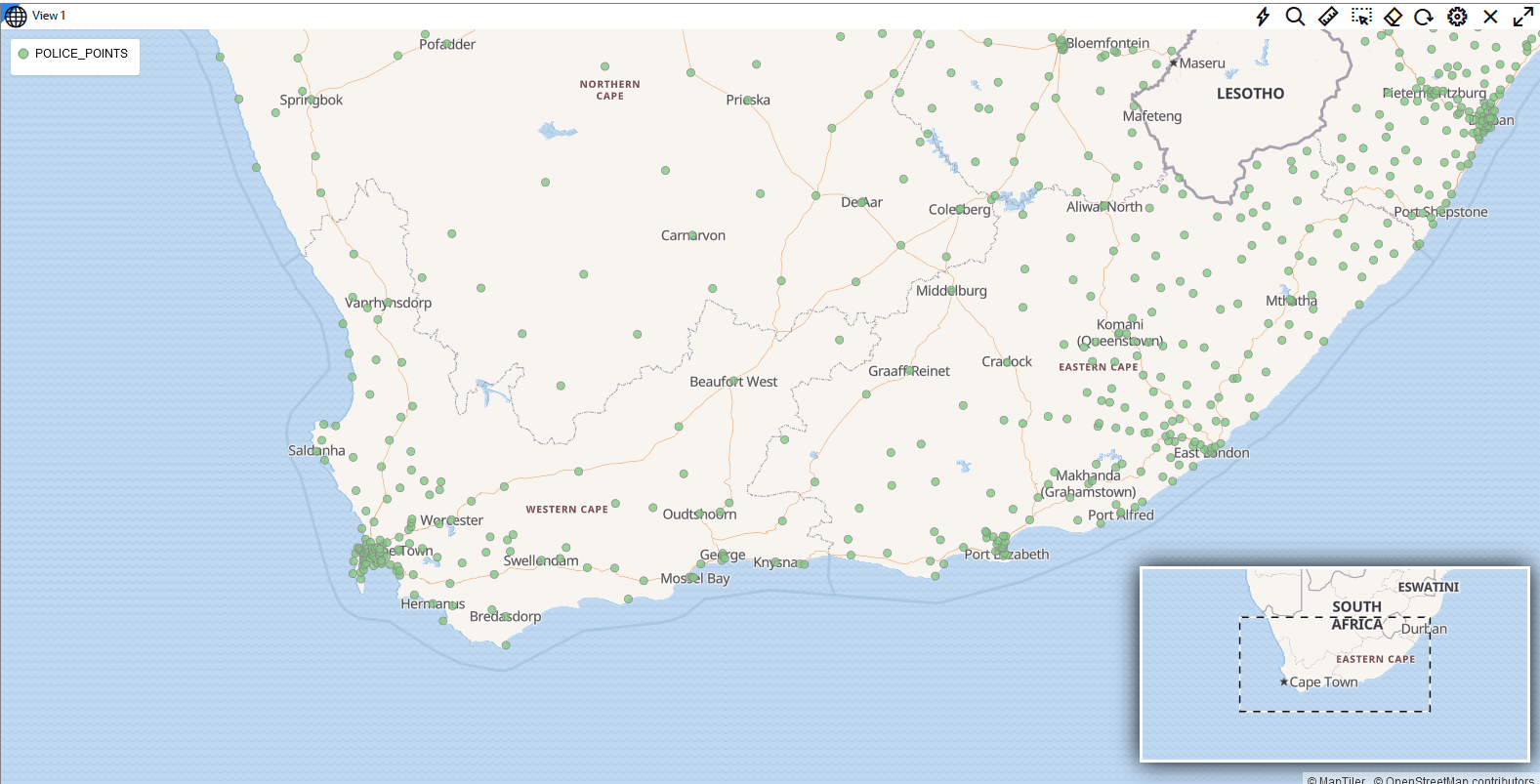

Visualizing a Point Map
Spatial Studio allows you to visualize the location of geographic data as points on maps.
To display your geographic data as maps, you must perform the following steps.
The instructions assume that the dataset for visualization is already added to the project in the Active Project page.
  1. Click the Visualizations tab on the left pane in the Active Project page.
    This lists the various visualization options.
  2. Click and drag Map from the list to the visualization window on the right to create a map visualization.
    A default base map is displayed with no data visualization layers.
  3. Click the Data tab on the left pane in the Active Project page.
    This lists all the Datasets that are loaded for the project.
  4. Click and drag the desired dataset from the list to the map view on the right.
    Tip:
    You can drag and drop multiple datasets in a single action to your map view.
    The map layer displays the data points for visualization.
  5. Optionally, you can click Settings in the map tool bar and enable Show minimap in the Visualization Settings dialog.
    An inset map showing the overview of the main map is displayed as shown in the preceding figure.

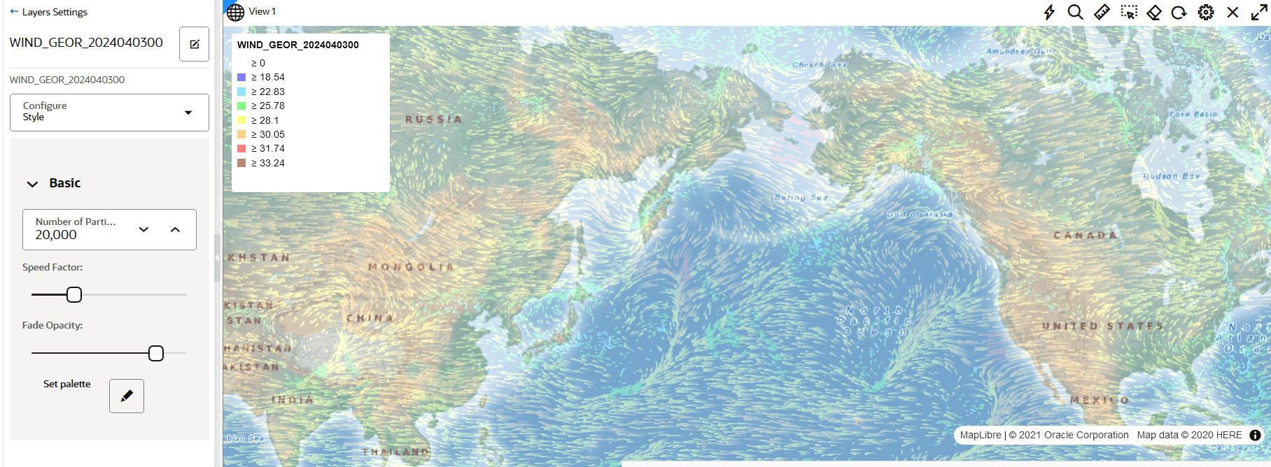

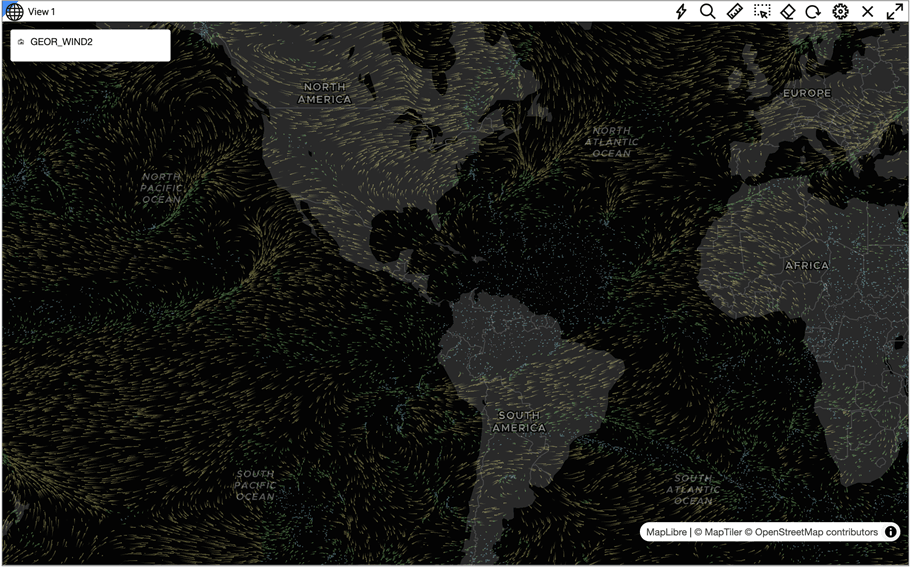

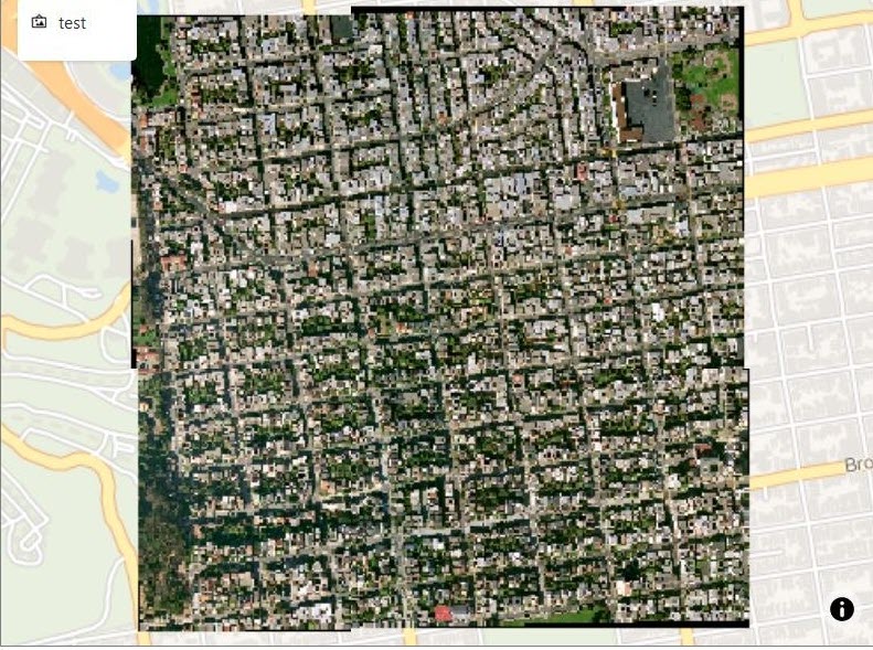

Visualizing GeoRaster Data on a Map
Oracle Spatial Studio allows you to visualize GeoRaster data stored in spatial GeoRaster type in Oracle Database. Geo-referenced raster data, including satellite imagery, aerial photos from drones, and gridded data, is very useful for mapping applications. It can be directly analyzed, or layered with vector data as a background map for additional context. See Spatial GeoRaster Developer's Guide for more information on GeoRaster data.
You can visualize georaster data on a map using the following steps.
The instructions assume that the GeoRaster dataset is already added to the project in the Active Project page. To create a GeoRaster dataset, see Creating a GeoRaster Dataset for more information.
  4. Click and drag the desired GeoRaster dataset from the list to the map view on the right.
    A GeoRaster layer is created on the map as shown:
    Figure 4-6 GeoRaster Data Visualization
    Description of Figure 4-6 follows
    Description of "Figure 4-6 GeoRaster Data Visualization"
    Tip:
    You can enhance your visual display by modifying your Layer Settings using the Style tab and Raster tab.
    Spatial Studio also supports visualization of 3D terrains on a map using GeoRaster Digital Elevation Model (DEM) data. See Applying Style for a GeoRaster Layer for more information.

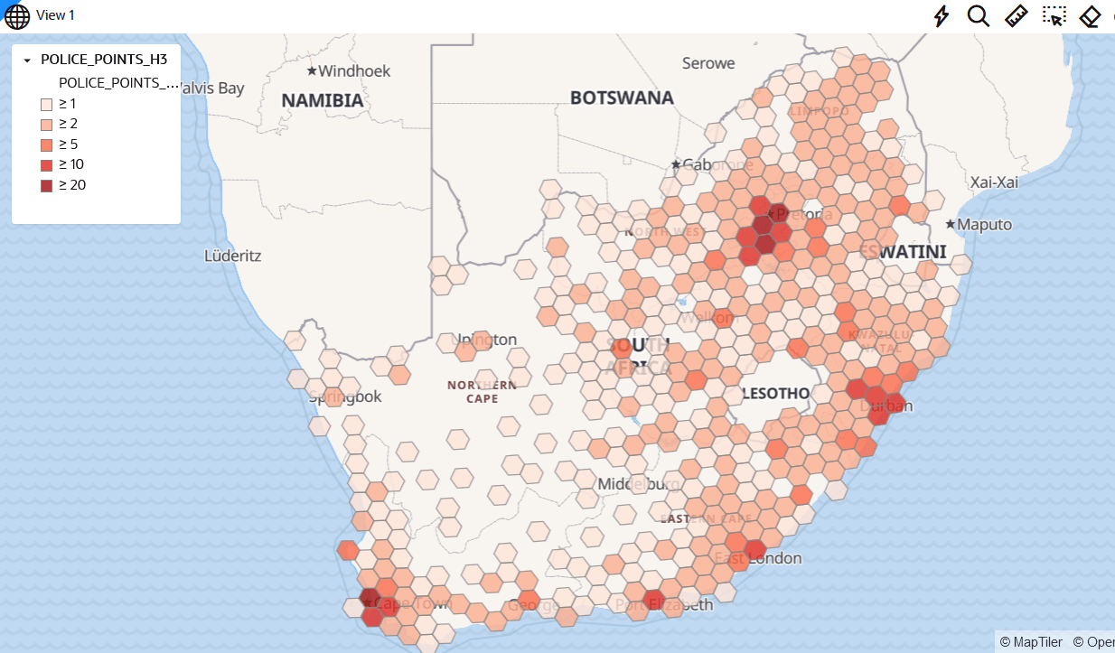

About Hexagonal Data Visualization Using H3 Aggregations
Oracle Spatial Studio allows you to visualize point-type map data using hexagons with H3 (Hexagonal Hierarchical Spatial Index) aggregations.
Visualizing your map data as hexagons has several advantages:
  • It helps you to identify patterns or clusters in a larger point dataset
  • Easier interpretation of data, as in a hexagonal cell, all the points are equidistant from the hexagon center-point
  • Hexagonal cells are color coded based on the number of datapoints they hold, which enables you to easily understand data patterns
The following sections describe how you can use H3 aggregations in Spatial Studio:

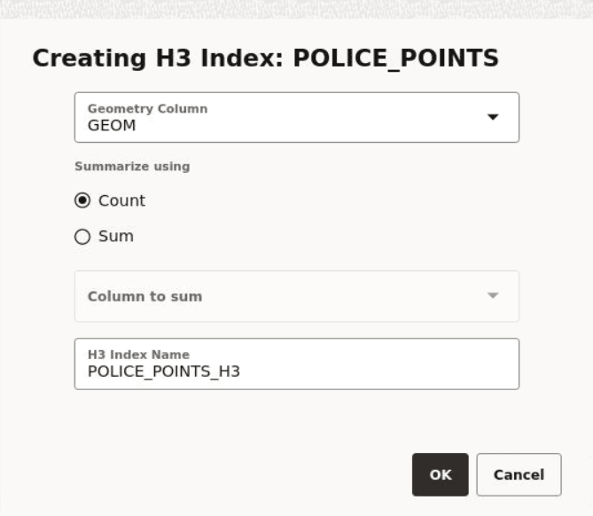

Preparing an H3 Aggregation Dataset
You can prepare an H3 aggregation dataset by performing the following steps.
The instructions assume that a dataset containing geometric data columns is already loaded to Spatial Studio.
  1. Navigate to the Datasets page.
    All the datasets loaded to Spatial Studio are shown listed on this page.
  2. Select the required dataset name and right-click to open the context menu.
  3. Click Create H3 Index on the Prepare submenu.
    The Creating H3 Index dialog opens as shown:
    Figure 4-7 Creating an H3 Aggregation Dataset
    Description of Figure 4-7 follows
    Description of "Figure 4-7 Creating an H3 Aggregation Dataset"
  4. Select the Geometry Column for H3 aggregations.
  5. Click a Summarize using option.
    The values for summarizing are:
    • Count: buckets the number of datapoints in each hexagon
    • Sum: adds up the values for a specific column in the data set, for all the points that fall in a specific hexagon
  6. Select the Column to sum, if you have chosen Sum to summarize your dataset. Otherwise, you can skip this step.
  7. Optionally, modify the H3 Index Name.
  8. Click OK.
    An H3 aggregation dataset is created and added as a new row in the Datasets page.
Visualizing Data With H3 Aggregations
To visualize your map data with H3 aggregations, you must perform the following steps.
The instructions assume that an H3 aggregation dataset is already added to the project in the Active Project page.
To prepare a dataset for H3 aggregation, see Preparing an H3 Aggregation Dataset for more information.
  4. Click and drag the desired H3 Aggregation dataset from the list to the map view on the right.
    A layer showing the hexagonal binning of the data points is displayed on the map as shown:
    Figure 4-8 Map Data Visualization Using Hexagonal Binning
    Description of Figure 4-8 follows
    Description of "Figure 4-8 Map Data Visualization Using Hexagonal Binning"
    See Applying Data-Driven Style to a Map with H3 Aggregations for more information on applying styling for a H3 map layer.

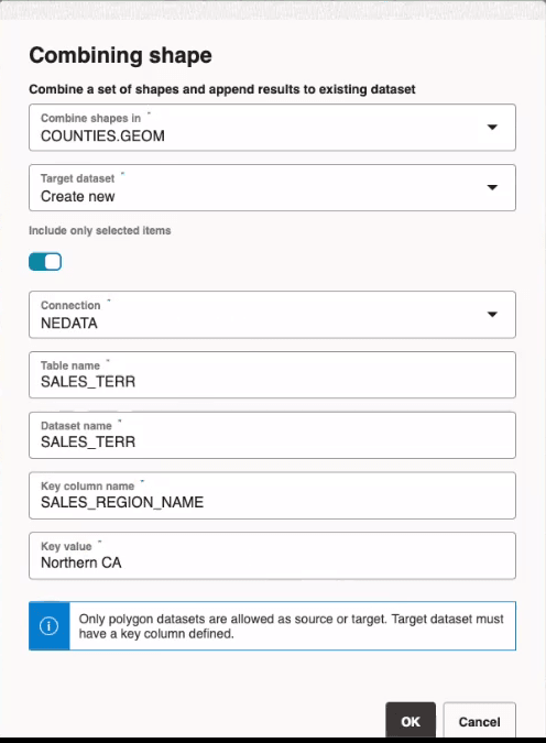

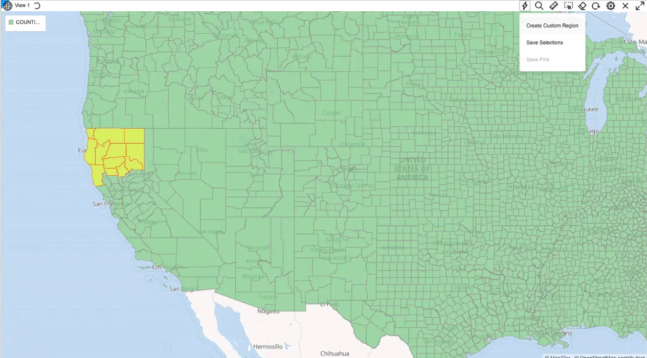

  5. Create the required custom regions by performing the following steps as many times as required:
    1. Select the regions for aggregation using the polygon selection tool in the map tool bar.
      Figure 4-9 Creating Custom Map Shapes
      Description of Figure 4-9 follows
      Description of "Figure 4-9 Creating Custom Map Shapes"
      Tip:
      Alternatively, you can also select multiple polygons by using the keyboard shortcut Ctrl + Click on a Windows system.
    2. Click custom_region_icon , Actions icon on the map tool bar and select Create Custom Region.
      Combining shape dialog opens as shown:
      Figure 4-10 Create a Custom Region
      Description of Figure 4-10 follows
      Description of "Figure 4-10 Create a Custom Region"
    3. Select the source dataset from the Combine shapes in drop-down list.
    4. Select one of the following desired options for Target dataset:
      • Create new: To create a new target dataset:
        1. Enter Connection, Table name, and Dataset name details for the new target dataset.
        2. Enter the Key column name and the Key value that uniquely identifies the custom map region.
      • Append to existing: To append the custom polygon shapes to an existing target dataset:
        1. Select an existing target dataset from the Append result to dataset drop-down list.
        2. Click Enter new shape attributes and enter a unique key value for the Key column name of the target dataset.
    5. Optionally, switch on or off the Include only selected items toggle button:
      Caution:
      The whole source dataset may be aggregated into one region if Include only selected items is switched off. In this case the process may run for a long time depending on the number of features in the source dataset. Therefore, use this option only if required.
    6. Click OK to create the custom map region.

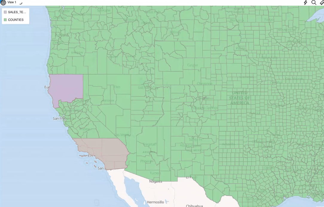

  6. Drag and drop the target dataset to the map view on the right to view the newly created custom regions.
    The following figure shows the newly defined custom regions that were inserted into the target dataset.
    Figure 4-11 Displaying the Custom Shapes on the Target Dataset
    Description of Figure 4-11 follows
    Description of "Figure 4-11 Displaying the Custom Shapes on the Target Dataset"

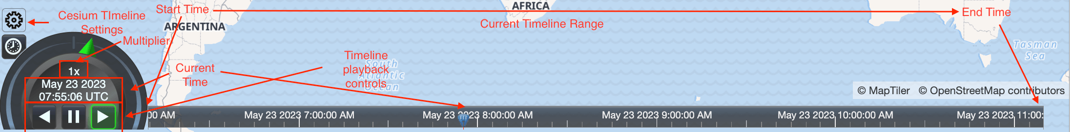

Overview of the Cesium Timeline Widget
Spatial Studio provides a new standalone Cesium Timeline widget starting from Release 23.2.
The Cesium Timeline widget in Spatial Studio provides the following capabilities:
  • Dataset filtering.
  • Serves as a hub for controlling all kinds of spatiotemporal data (such as live, historic, moving objects, and so on).
    The only exception being the GeoJSON URL based datasets. These datasets do not cater to Cesium timeline as the external URLs may not have the capability to provide GeoJSON corresponding to a time value, but are rather simply refreshed to provide newer values every x seconds.
  • Offers a scalable solution to add multiple layers of different dataset types at once that can be time-synced as required.
The following figure shows the Cesium Timeline Widget on a map visualization in Spatial Studio.
Figure 4-12 Cesium Timeline Widget
Description of Figure 4-12 follows
Description of "Figure 4-12 Cesium Timeline Widget"
The key concepts of the Cesium Timeline are as follows:
  • Cesium Timeline Modes: The timeline supports two modes of operation. If even one layer corresponding to a live dataset is listening to the timeline, then the mode of operation is LIVE. Otherwise, the mode of operation is always HISTORIC.
  • Cesium Clock Start Time: Starting point of the current range of timeline. This is the point in time from which the Cesium clock starts ticking.
  • Cesium Clock Stop Time: Ending point of the current range of timeline. This is the point in time until which the Cesium clock ticks. However upon reaching the end, the timeline behavior depends on the mode:
    • LIVE: The timeline will move ahead by updating the start time and stop time values as per the current time.
    • HISTORIC: The timeline will loop back to the start time.
  • Cesium Clock Current Time: The current time frame of the clock. It begins at the Cesium clock start time and ticks every 500ms. Optionally, you can slide the pointer on the timeline manually to set your current time.
    Also note the following with respect to the type of the spatiotemporal dataset:
    • Live Spatiotemporal Dataset: The Cesium clock current time value for such datasets is configured to always be pointing to current UTC time (unless manually changed).
    • Non-Live Spatiotemporal Dataset: If no other dataset is added to the timeline, then the Cesium clock for such a dataset automatically sets its range to minimum and maximum of the timestamp column, and the Cesium clock current time starts from the minimum value.
  • Multiplier: Multiplies to the interval at which the clock ticks (500ms) in order to make the clock jump ahead or rewind accordingly.
  • Timeline Playback Controls:
    1. Pause: Stops the timeline from animating and throwing tick events. The timeline pauses at current timeline frame.
    2. Forward and Backward Play Buttons: Makes the timeline animate in the chosen direction and includes the multiplier value (+/- Multiplier * 500ms)
  • Cesium Timeline settings: Allows you to control the timeline settings.
Configuring the Cesium Timeline Settings
You can configure custom settings for the Cesium timeline.
Perform the following steps to configure the Cesium Timeline settings in your map visualization.
The instructions assume that you have a project linked to a spatiotemporal dataset and the project is opened on your Active Project page.
  1. Click the Settings icon in your map tool bar.
  2. Switch ON the Show timeline toggle and click OK.
    The Cesium Timeline widget appears at the bottom of the map visualization canvas.

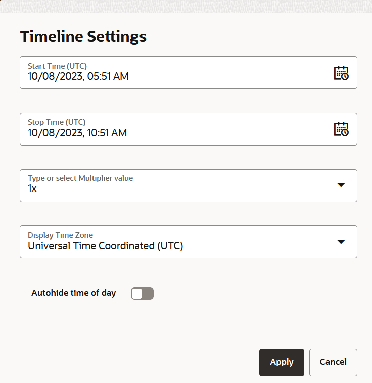

  3. Click timeline_settings_icon on the timeline to configure the Cesium timeline settings.
    The Timeline Settings dialog opens as shown:
    1. Select the Start Time and Stop Time to set the timeline range.
    2. Enter or select a multiplier value from the Type or select Multiplier value list box.
      You can use a preset (Second, Minutes, Hours, Days, Weeks, Month, Year) multiplier or type a value such as 15 or 15x.
    3. Select the Display Time Zone in which you want the Cesium timeline to display its current time and timeline labels.
    4. Optionally, switch ON the Autohide time of day.
      If you opt to autohide time of day, then the time values from the timeline labels are hidden if the timeline range selected is greater than a week.
    5. Click Apply.

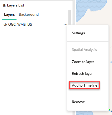

  • In order to add a map layer to the timeline, you must first enable spatiotemporal in the underlying dataset for the map layer. See Enabling Spatiotemporal for a Dataset for more information.
  • You can then add one or more spatiotemporal map layers to the Cesium timeline by performing the following steps:
    • Click the Settings icon in your map tool bar and switch ON the Show timeline toggle to view the Cesium timeline widget at the bottom of the map visualization canvas.
    • Select the Add to Timeline option in the context menu of the map layer as shown:
      Figure 4-14 Adding a Map Layer to the Timeline

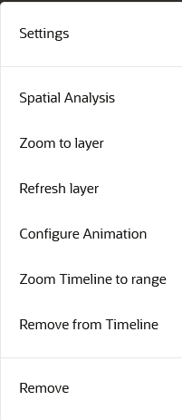

  7. Click Menu Icon against the primary layer in the Data tab of the Layers list and click Add to Timeline,
    Adding a map layer to the timeline will point to the current UTC time and the layer is now listening to the timeline events. However, the timeline is not operational at this step. Optionally, repeat this step to add multiple layers (of different spatiotemporal datasets) to the timeline and listen to its events.

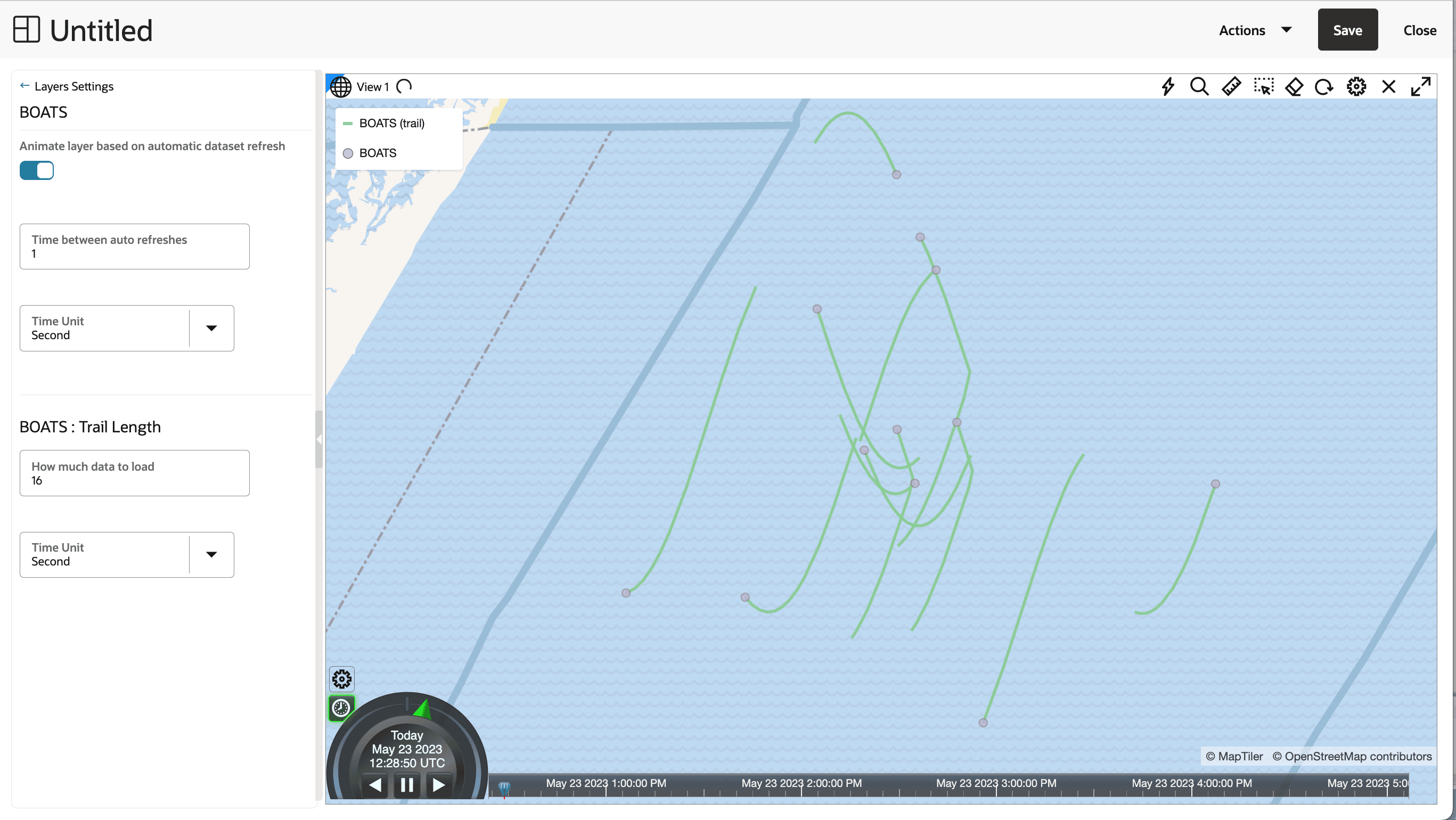

  8. Configure animation for the map layer by following the steps in Configuring Animation for Moving Objects Dataset.
    Figure 4-15 Configuring Animation Settings
    Description of Figure 4-15 follows
    Description of "Figure 4-15 Configuring Animation Settings"

  8. Select Configure Animation from the context menu of the map layer.
  9. Switch ON Animate layer based on automatic dataset refresh.
    The dataset animates with the Cesium clock events.
  10. Specify Time between auto refreshes to indicate the frequency of data refresh from the backend. This configuration also determines the smoothness and speed of the temporal animation.

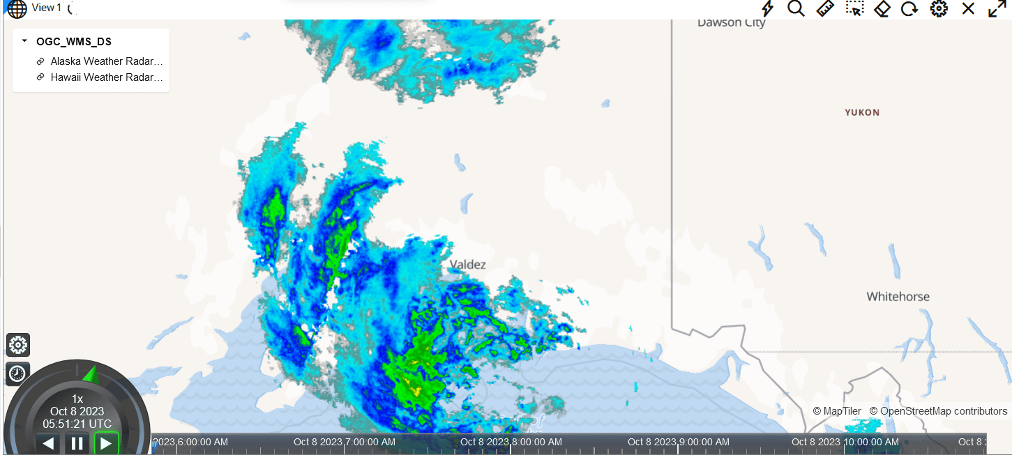

Visualizing Spatiotemporal Data in OGC WMS Datasets
You can visualize OGC WMS datasets that contain spatiotemporal data.
The following instructions assume that you have enabled spatiotemporal for such a dataset and the dataset is already added to the project in the Active Project page. See Configuring Spatiotemporal for OGC WMS Datasets for more information.
  4. Click and drag the desired spatiotemporal dataset from the list to the map view on the right.
    A single map layer is created on the map.
  5. Click the Settings icon in your map tool bar.
  6. Switch ON the Show timeline toggle and click OK.
    The Cesium Timeline widget appears at the bottom of the map visualization canvas. However, the timeline is not operational at this step.
  7. Click Menu Icon against the map layer in the Data tab of the Layers list and select Add to Timeline.
    The map layer gets added to the timeline. Although the timeline is now listening to the timeline events, it is still not operational.

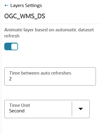

    The animation configuration dialog opens as shown:
    Figure 4-17 Configuring Animation for an WMS Dataset
    Description of Figure 4-17 follows
    Description of "Figure 4-17 Configuring Animation for an WMS Dataset"
    Also, note the following:
    • Spatial Studio displays a default value of 2 seconds for WMS datasets. The effective refresh rates depend on how fast images are fetched from the respective WMS service. Empirically, for WMS data, any data change rate less than 2 seconds is not sufficient to retrieve image and refresh the tiles. It can cause incomplete image loading before the new refresh, or the visualization may remain stuck in refresh state.
    • The parameter ignores all the tick events from the timeline if the Cesium clock current time is less than previousRefreshTime + x seconds (or any other time unit). For example, if a dataset is supposed to refresh every 30 seconds, then configure this value in Time between auto refreshes so that even if the Cesium clock continues to throw tick events for all layers, this layer will ignore any such events.
  11. Specify a Time Unit.
  12. Optionally, select custom Start Time, Stop Time, Multiplier, and so on from the timeline settings. You can also use the Cesium timeline controls and make the current time pointer slide to a different time frame.
    Zoom Timeline to Range is disabled for an OGC WMS dataset. This is because each WMS dataset may comprise more than one image layers and it will be inaccurate to choose a time range for any one of these layers automatically. Therefore, use the Cesium timeline settings (see Configuring the Cesium Timeline Settings) to manually set the appropriate range of the timeline for the specific image layer that you wish to animate.

  5. Click Menu Icon against the map layer in the Data tab of the Layers list and select Configure Animation.
    GeoJSON URL based datasets are not dependent on the time values represented by the Cesium Timeline. They are just required to refresh periodically and therefore you need not enable the Cesium Timeline for such datasets.
You can animate a spatiotemporal map layer of a moving objects dataset based on Cesium timeline events.
The instructions assume that the spatiotemporal map layer is already added to the Cesium Timeline.
  1. Click Menu Icon against the primary layer in the Data tab of the Layers list.
    The context menu of the map layer displays the following options:
    Figure 4-19 Context Menu for a Map Layer
    Description of Figure 4-19 follows
    Description of "Figure 4-19 Context Menu for a Map Layer"
  2. Select Configure Animation.
    The animation settings for the map layer opens.
  3. Switch ON Animate layer based on automatic dataset refresh.
  4. Specify Time between auto refreshes to indicate the frequency of data refresh from the backend. This configuration also determines the smoothness and speed of the temporal animation.
    • Spatial Studio displays a default frequency value which is same as the Data Change Rate value configured on the Spatiotemporal dataset used for the visualization.
    • All the map layers added to the timeline can individually have their own refresh or animation intervals.
  5. Specify a Time Unit.
  6. Specify How much data to load, the trail length of your moving object. A trail length value of N indicates that Spatial Studio must fetch the recent N units (unit value as specified in the following step) of data of the moving object during every refresh.
    Tip:
    If the underlying database table or view contains millions of records, you can limit the map animation to display only the most recent N units of data as configured in Trail Length.
    Note that Spatial Studio displays a default trail length value which is 15 times the Data Change Rate value configured on the Spatiotemporal dataset and is rounded to the nearest integer.
  7. Specify a Time Unit for the trail length.
    The animation settings are configured and you can view the animation of moving objects on the map.
    You can choose a symbol and color for your moving object. However, ensure that the symbol you select adheres to the conditions explained in Characteristics of Spatiotemporal Map Layers for Moving Objects Dataset.

Visualizing OGC WMS Maps as a Dataset
You can visualize an OGC (Open Geospatial Consortium) WMS (Web Map Service) dataset on a map.
This is in addition to creating a custom basemap that is based on external WMS maps, and switching to such a basemap in your map visualization. The main issue in using basemaps is that a single map visualization can only have one basemap. For instance, if you are using a basemap based on WMS images, then you can no longer display other background maps, such as OpenStreetMap. Therefore, the geographic context is lost as the WMS images typically do not contain detailed administrative boundaries, or other common features seen on a regular background map.
To overcome this limitation, Spatial Studio allows you to use a regular background map, while adding the WMS map images as a dataset layer on top. As the WMS images are just another dataset, which can be displayed as another layer on the map, you can easily reorder the layers, or toggle the visibility of the WMS images just like with any other map layer.
To visualize an OGC WMS dataset on a map, you must perform the following steps.
As a prerequisite ensure the following:
  • The OGC WMS dataset is created using an OGC WMS connection and exists in Spatial Studio. See Creating an OGC WMS Dataset for more information.
  • The required OGC WMS dataset is added to the project in the Active Project page.
  4. Drag and drop the desired OGC WMS dataset from the list to the map view on the right.

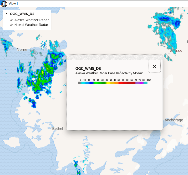

    The OGC WMS data layer gets displayed on the map. The map will automatically zoom to the area covered by the WMS dataset if it is the very first dataset to be added to your map.
    Figure 4-20 Visualizing an OGC WMS Data Layer
    Description of Figure 4-20 follows
    Description of "Figure 4-20 Visualizing an OGC WMS Data Layer"
    The preceding figure illustrates the weather pattern images (loaded from a WMS service) which are overlaid on top of the OpenStreetMap background.
    Tip:
    Click the Image link on the map legend to view the legend information generated by the WMS service for the OGC WMS map layer.
    When you display a new WMS dataset for visualization, your browser will be sending the WMS image requests directly to the WMS server. You can always refresh the map layer to reflect the current data from the WMS server.

Visualizing a Wind Animation Dataset
You can create a wind animation visualization in Spatial Studio.
The following instructions assume that you have a wind animation enabled GeoRaster dataset and the dataset is already added to the project in the Active Project page. See Creating a Wind Animation Dataset and Enabling Wind Animation For an Existing GeoRaster Dataset for more information.
  4. Click and drag the desired wind animation dataset from the list to the map view on the right.
    The wind animation visualization gets displayed as shown:
    Figure 4-23 Visualizing Wind Animation
    Legend using a color scheme is supported for wind animations. However, pitch and rotation actions are not supported. If the view is rotated or pitched, then the wind animation will be disabled, and a warning will be displayed. The wind animation will automatically be reenabled once the pitch/rotate is returned to the default (0).
  5. Optionally, click Menu Icon against the wind animation dataset layer in the Data tab of the Layers list and configure the following properties.
    • Number of Particles: Controls how many particles are randomly drawn in the current viewport. These particles will be animated based on the wind velocities.
    • Speed Factor: A multiplier between zero and one that adjusts the on-screen movement in relation to the actual wind speed.
    • Fade Opacity: Manages the length of particle trails and when they should fade out, affecting the smoothness of the animation.
    • Set palette: Sets the color scheme for different ranges of wind velocity.
