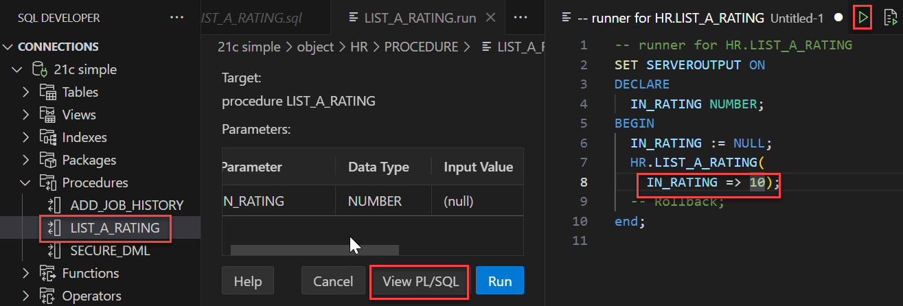

  3. To run this procedure, right-click LIST_A_RATING in the Connections navigator and select Run. The parameter and it's properties are displayed.
  4. Click View PL/SQL.
  5. Change IN_RATING => IN_RATING to IN_RATING => 10, and click Run Statement.
    The result is shown in the Script Output pane:
    All books with a rating of 10:
    Moby Dick
    Software Wizardry
