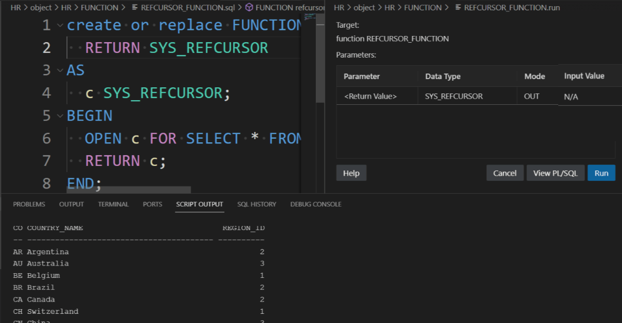

  • To run a subprogram, open it in the SQL Worksheet and then select the Run icon. You can then view the PL/SQL code and edit if needed, and then click Run. The results are displayed in the Script Output pane below.
The Run, Compile and Compile for Debug icons are also available when opening PL/SQL files with any of the following extensions, KLR, PKB, PKH, PKS, PLB and PLS, from your local device.
In the following figure, the REFCURSOR_FUNCTION is run and the output is displayed below.
