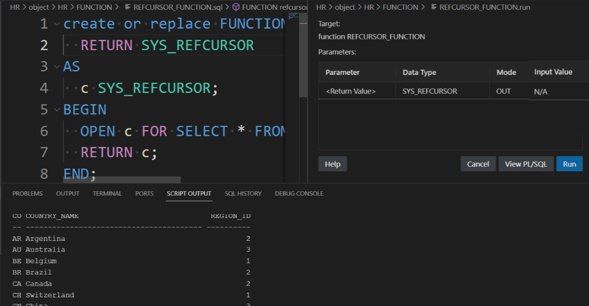

To run a subprogram, open it in the SQL Worksheet and then select the Run icon. You can then view the PL/SQL code and edit if needed, and then click Run. The results are displayed in the Script Output pane below.

In the following figure, the REFCURSOR_FUNCTION is run and the output is displayed below.
