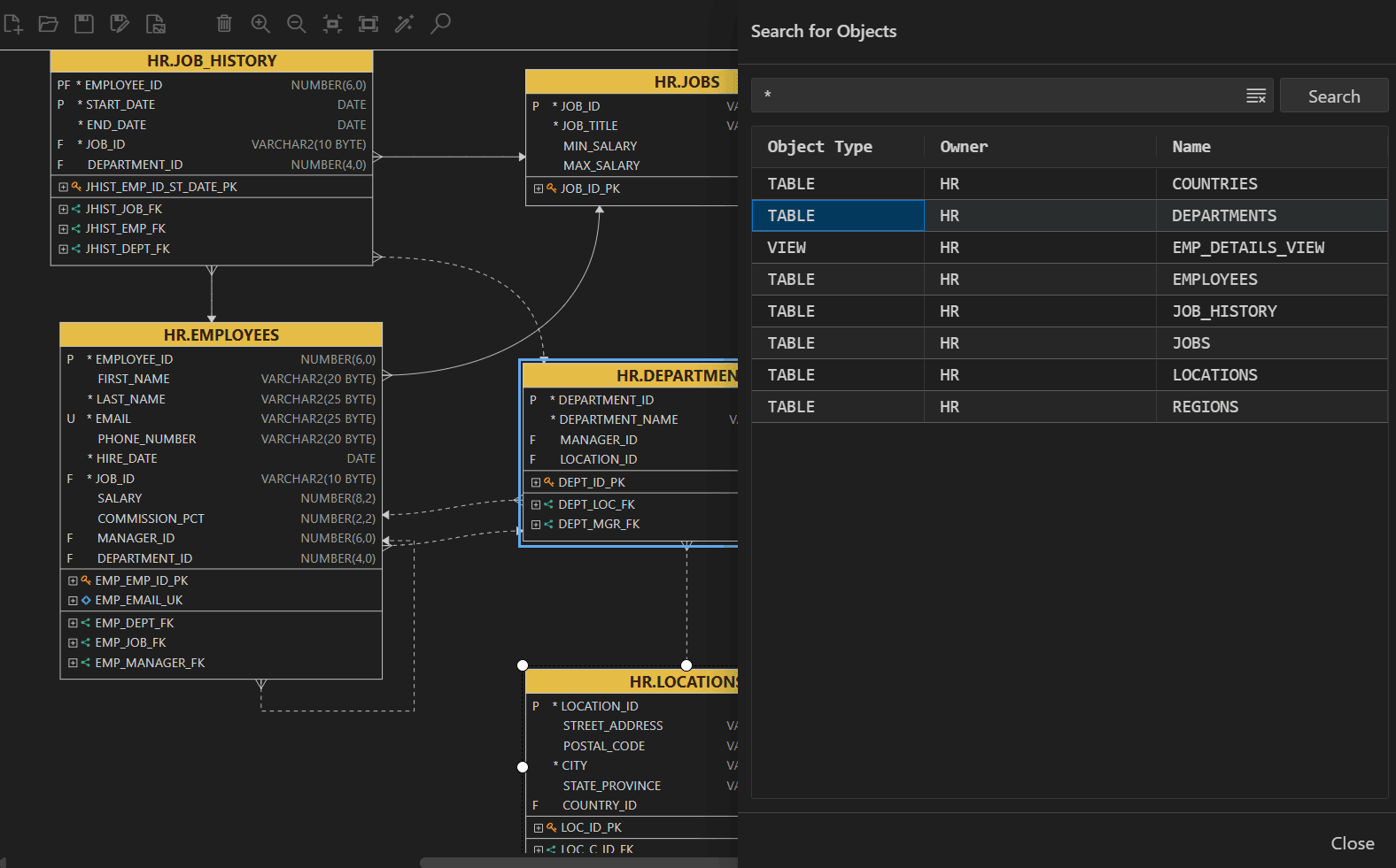

The SQL Developer extension for VS Code provides the functionality to search for an object in the schema object diagram.
  1. From the toolbar available on the diagram window, click the Search icon.

    The Search for Object dialog box is displayed.
  2. In the search box, type the name of the object (table name, view name, or duality view name) you want to search for.
    Note: Type * to list all the objects of an object type (tables, views, or duality views) in the schema. You can also search by typing a few characters.
  3. Click Search.
    The search results are displayed in the grid below. Clicking on an object in the output grid highlights the corresponding object in the diagram.
